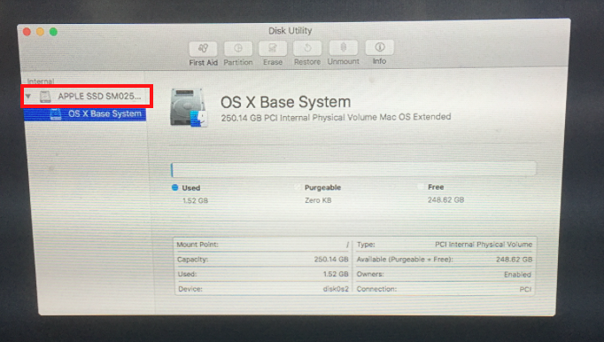

Ok wait think I got it
iPEoNa
https://ibb.co/iPEoNa

Just to confirm, you're:
1) Holding CMD + ALT + R on startup (the Alt is very important, as CMD + R will boot into normal recovery)
2) You're selecting the top partition (red) and when you do, the Erase/Partition option is still greyed out?

Oh okay! I'm not sure why it won't boot into internet recovery. Please can you select Partition and see if you can create a new volume that way?

https://ibb.co/hPOb8F
Sorry for the confusion but internet recovery does seem to have started; just was much slower. Do I still select partition even with erase and restore options now available?

Ah that's looking better! Just select Erase and ensure the format is Mac OS Extended (Journaled) in GUID. That should be the default setting anyway.
Once it's formatted it'll be able to reinstall macOS from there.
