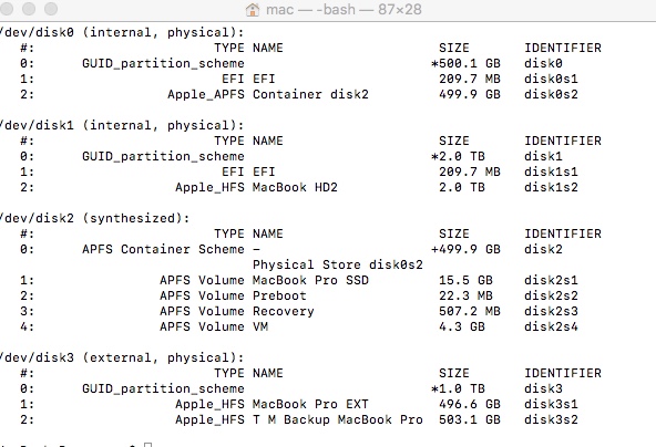

Hmm, i have now looked at the list disk command with Terminal, instead of only with disk utility like earlier.
Now that got me confused, if you look at the screenshot you can see 3 disks, disk0, disk1 and disk2
(and disk3 which is an external hard drive, so just forget about that one).
Disk0 seems to be the primary SSD drive since it is around 500 GB and has the filesystem APFS, and then the disk1 is the 2TB secondary drive, and finally disk2 is ALSO the same 500GB primary SSD drive.
By the way, disk2 (SSD) also has the word "synthesized", don't know what that means?
So how can the SSD have two different disk numbers? And in that case will the Mac see the primary SSD as disk0 or disk2 ?
Some help would be appreciated, this got me a bit confused. If I remember it correctly I have never seen another disk this way in list disk. Is it maybe because its an SSD with APFS filesystem? But shouldn't the SSD in that case have the two disk numbers in a row, for example disk0 and disk1?
EDIT: It seems the whole primary SSD drive is disk0, but the partition on that same drive is disk2 ?
Does everything look normal in the attached screenshoot of my disks?

What you see is normal.
When you upgraded, the original HFS partition on disk0 was changed to an APFS Container. The container is mapped to disk2 with an additional volume, Preboot, required to boot using APFS. The Recovery volume was also moved into the container. disk0 is the physical disk, disk2 is a logical or virtual disk representing the contents of the container.

In addition to what @dsemf wrote you can get a more in-depth overview of the APFS containers by:
Code:
diskutil apfs list
