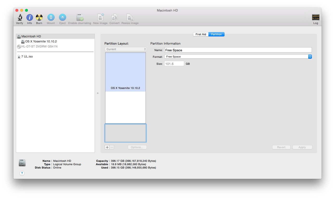

So I had Yosemite for a while, and a couple of days ago I reinstalled Mavericks on a separate partition; they were running along side each other, and all was well. Today, I removed the Mavericks partition from Yosemite, using Disk Utility, and it worked, however, it has left it as "Free Space". Which is not what I want, as I was planning on installing Windows using Bootcamp soon.
Despite trying to turn the Free Space into a Mac OS Extended (Journaled) Partition and then trying to erase that, it didn't work, it just wouldn't make the partition. The Log just says "2015-03-05 19:52:06 +0000: Preparing to partition disk: “APPLE HDD ST500LM012 Media”" but then nothing happens.
Any ideas on how I can fix this, preferably very soon?

What happened it Yosemite converted your drive to a core storage volume and that cannot be manipulated in Disk Util like you want.
First try this command in Terminal to revert the core storage volume. Disconnect any other drives first.
Code:
diskutil cs revert /
If that does not work you will need to backup the drive to an external and wipe the internal then restore the data back.
To wipe to drive do a command-r boot to recovery the from the Utilities menu start Terminal and enter the command below exactly like I have it, including the quotes.
Code:
diskutil cs delete "Macintosh HD"
Then quit Terminal are erase the disk back to one volume of Mac OS Extended (Journaled). Then quit Disk Util and restore from your backup.
(If you don't know how to do the backup and restore, just post up and I'll explain that)

The first method worked perfectly my friend! Thanks a lot!
