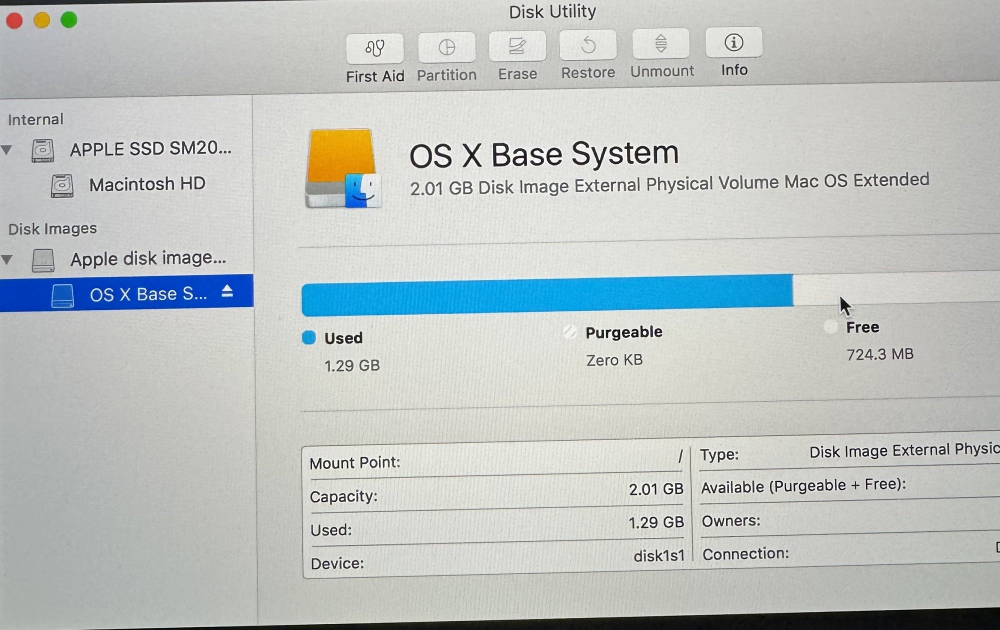

So the guy said it has to be able to be at the factory install "Hello" screen or set up vanilla for them to test for trade in. I have tried everything to get Sierra on it. I tried Erase several times and First Aids in Disk Utility from Recovery. Those worked fine. This is what the disk looks like now:

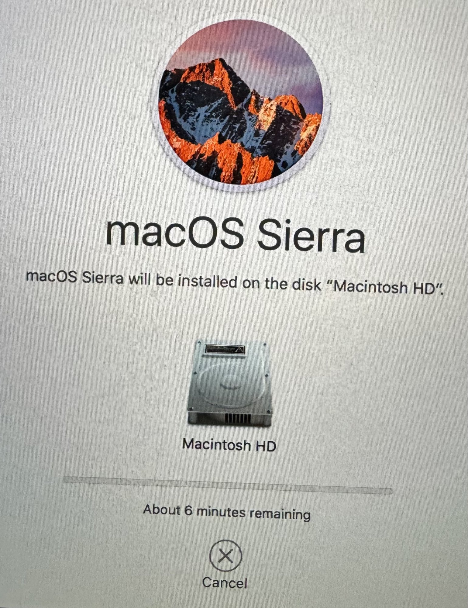

When I run "Reinstall MacOS" (which would install Sierra), after a screen that says "Starting Internet Recovery", I get this:

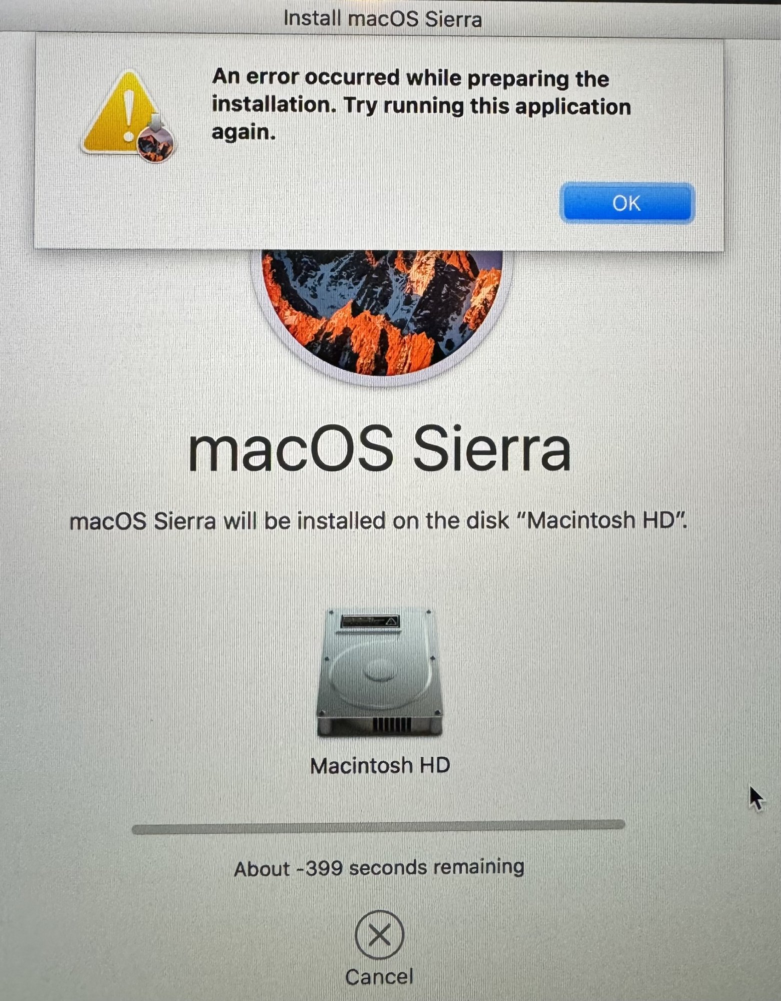

But when it finishes, it says this:
What do I have to do, to get Sierra factory installed on it/ready for Setup? Thank you for your help!!
Thanks for the reply. I don't have MacOs running on it now, and that link for install MacOS from Recovery is exactly what I have been trying....
Internet Recovery worked! Thank you @chabig !!!!!
EDIT: The regular recovery tried to install Sierra, while the internet recovery installed Monterey.
