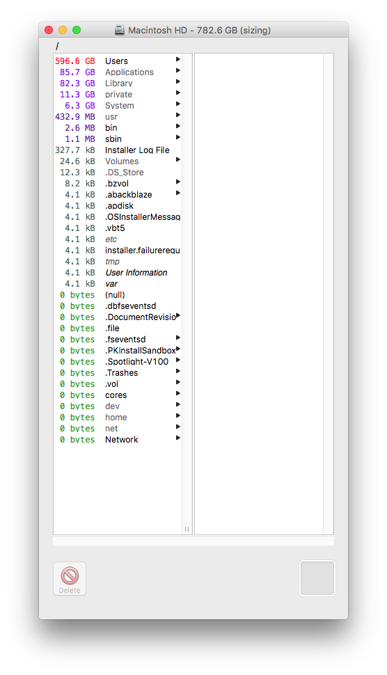

I would check that OmniDiskSweeper is giving the correct results. On my system it hung on the Users directory, the most likely place you could be using a lot of space.
It was also quite slow. I could have done multiple DaisyDisk full volume scans scans while Omni was just scanning one large directory (Users). If you don't want to use DaisyDisk you might try to find another scanner to make sure that it gives the same results.

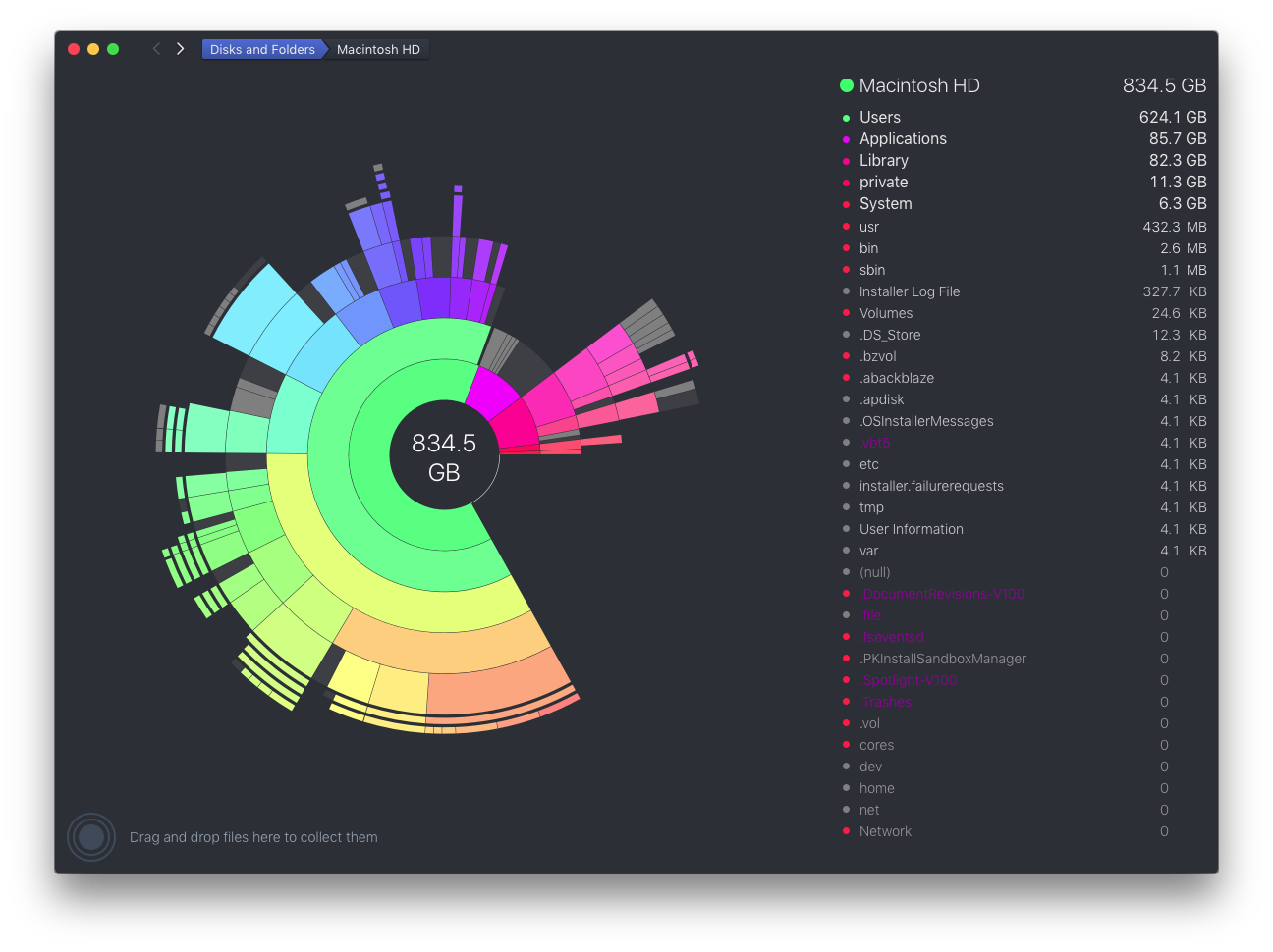

Here are the screenshots of my results. I gave up waiting for Omni to finish after ~10 minutes so it is still chugging along. After ~30 minutes I updated this post with the "maybe a bug" comment. [This drive is an SSD on a 2013 nMP].
