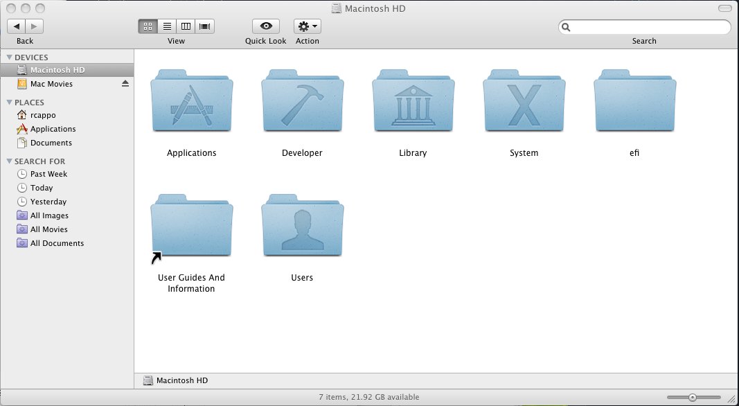

I am trying to upgrade 10.6.8 to 10.8.2, yet I am having problems doing it. I think part of the reason might be because I have very little free space on my hard drive. I have not found any specifications for what the minimum amount of free space is, but I thought it was going to be 8GB, and it turns out that having 8GB free didn't solve the problem.
I have gotten down to 0 before on my computer for free space in Finder, but for some reason, the partition's available doesn't seem to agree.

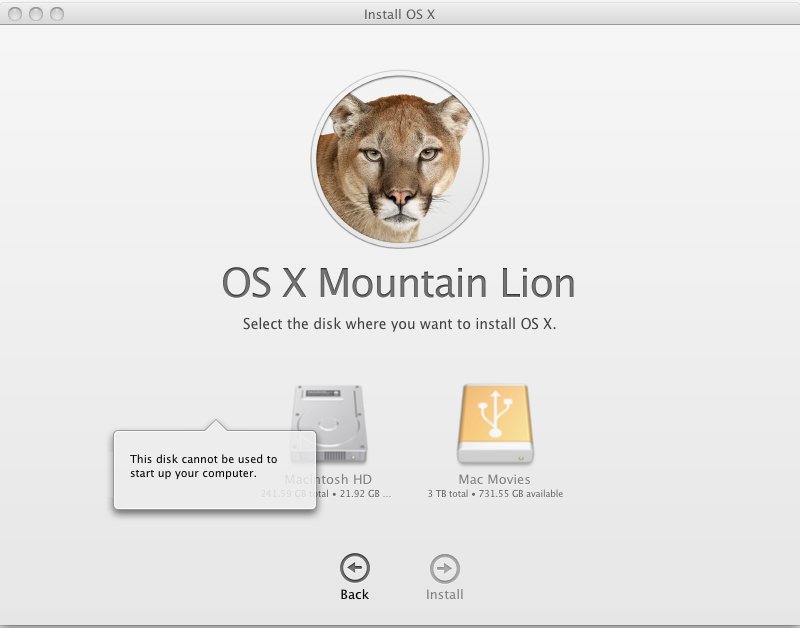

I also get the error message "This disk can not be used to start up your computer" when I try to upgrade from the app store download installer. Is this because I have rEFit installed and dual boot Linux? Is it because I don't have enough free hard drive space?
Everything is backed up, and I hope that the 10.6.8 backups aren't removed from the Time Capsule I use once I do get this working. Does anyone have any advice or suggestions?
Here is where I get stuck at during the install. Yet there is nothing suggesting what else I can do.
From what you have said so far here, is looks like between your Linux installed and rEFIt, you have jacked up the boot area of the Mac HDD. You are not even getting far enough to get the not enough disk space message.

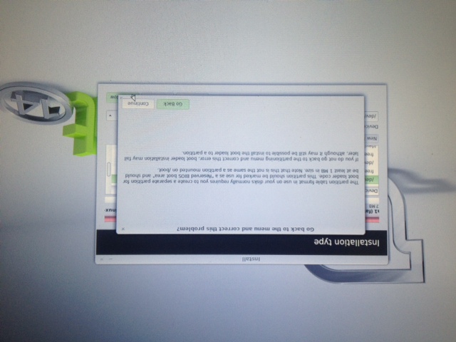

I took a few pictures, and one choice was:
Device for boot loader installation:
/dev/sda ATA APPLE SSD TS256B (251.0 GB)
or
/dev/sda4
I did get this error, that I guess I should have heeded.
