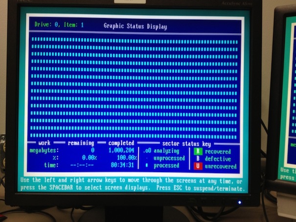

I use a PC DOS-based program called Spinrite as a maintenance and data recovery utility on all my HDD's. You have to have an IBM-PC in order to use it though. You take the HDD out of the Mac and connect it to the IBM-PC and run the program. Below is my old MBP HDD in a Dell PC with Spinrite working on it.
Independent review of Spinrite (not me)

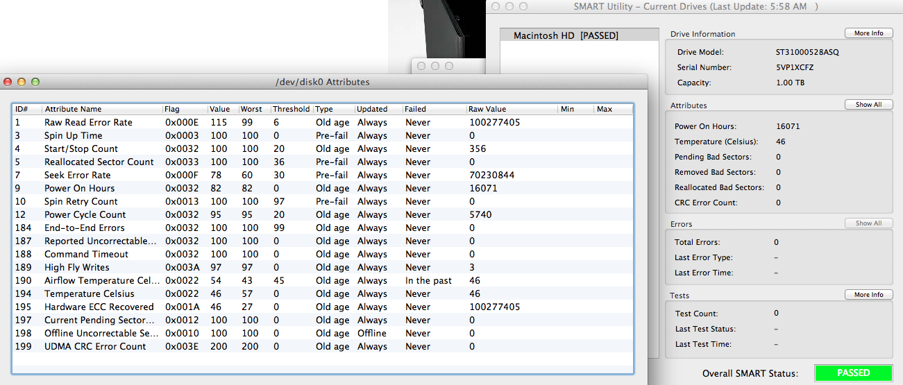

I just did the SMART Utility test and it appears the drive passed with flying colors. Normally, that'd be a good thing, but now I think it means that it's my software like I suspected and the issue won't be corrected by migrating over to the new iMac. :(
What do I do?
P.S. Does that Power Cycle Count of 5700 meant that my computer has been restarted 5700 times? :eek: Or does that just mean that it's been put to sleep that many times? And 16,000 hours on the hard drive? WOW! That's like 2 years 24/7, which actually I guess makes sense since I've had it since November 2009, which makes it about 3.5 years old and I usually keep the computer on.

Just because SMART doesn't indicate a problem with the HDD doesn't mean there isn't. SMART isn't exactly very smart and can really only be useful when you put the disk under load and write to the drive as a whole. Only then is SMART truly practical and can be used as a measuring stick. I'm not saying it's completely useless, but it's certainly not reliable.
SMART is Self-Monitoring Analysis and Reporting Technology, SMART. And it's when we got the IDE drives that manufacturers like Compaq that were big users, consumers of these drives, they said we need some way of knowing what's going on in there. Now that you've moved the controller in there, you've got this integrated drive electronics, this IDE. It's a black box. How do we know how good it is, how solid it is, how long it's going to last? We'd like to know, before it dies, that it's getting kind of flaky in there. But thanks to having moved the electronics in there, we can't see into that anymore. We need some visibility into the drive. That's what the Self-Monitoring Analysis and Reporting Technology gives us, theoretically, is an API, a means of asking the drive about things going on inside. It's a classic case of politics. The manufacturers did not want to provide this information.
So the problem with SMART is that - and I learned this when I added that technology - SpinRite 6 is the first version of SpinRite to dynamically monitor the drive's SMART system while it's running. And what I learned was that the SMART system is only useful when the drive is under load, that is, when it's doing work. And that's the beauty of SpinRite's use of the SMART system. There's a SMART analysis page in the SpinRite UI which shows you in real-time, for example, the amount of error correction the drive is doing per megabyte of data read. And it shows you the high point, the low point, and the average over time. So you're able to judge, literally in an analog fashion, judge the quality of the current quality of the drive when it's doing work.
The SMART system means nothing when you're not asking the drive to read things because it's only in reading that it has a potential problem. So it's one thing, it's sort of nice to have the SMART system around in the background. But unless you actually are watching it while you do a scan across the drive, it's not going to tell you that much. And of course the manufacturers know that. They're like, they're not wanting to actually demonstrate that, like create a means for judging drives, because then manufacturers would reject some of them.
Above text from Steve Gibson of the podcast Security Now, episode 385 (transcript)
