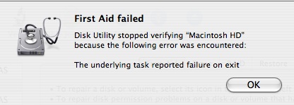

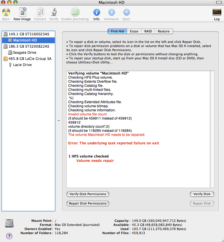

Bad news😕
probably goes without saying that anything on that drive should be backed up asap and very, very frequently from this point on.
That's certainly never a good sign. Is it making any noises? Clicking, grinding, anything like that?
No grinding. Just loud 3 year old fans. (plus louder gfx card) (bigger fan)
Any single user mode suggestions
maybe i can force repair
are you running disk utility from within your startup disk? If so, you shouldn't. Run the Disk Utility from the OS X Install Disc. See if that works.
sound is kinda like a waaaaa (stop) waaaaa (stop) waaaaaa (stop) waaaa not really that loud but not normal.
As the previous post says, run the utility from the install disk:
Put the CD in
Turn your computer off
Hold down the C key and turn the computer on (hold the key until the Apple comes up)
Select your language
From the Utilities menu select Disk Utility
Select your dive (not the partition) from DU
Click Repair

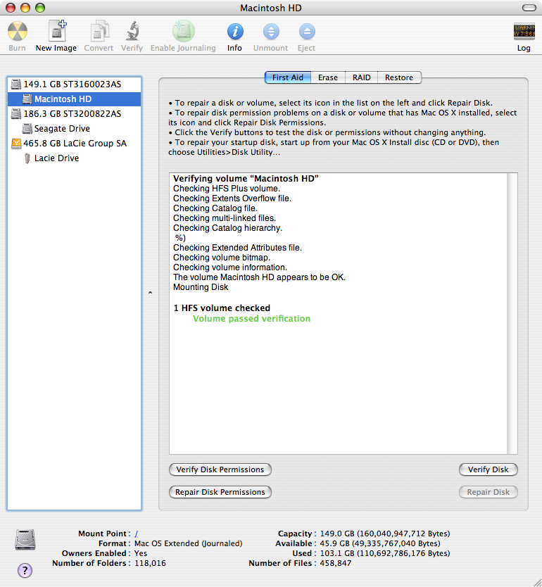

Hold apple S while rebooting: then type exactly this = Problem solved 🙂
/sbin/mount -uw/
/sbin/fsck -y
/sbin/fsck -yf
reboot
