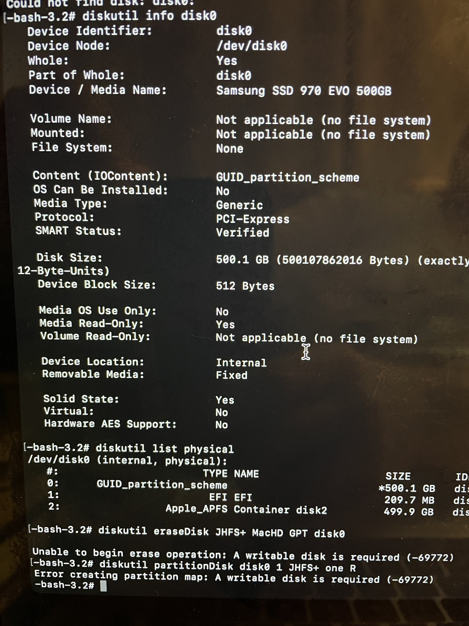

Looks like I'm out of luck; I get a "writeable disk is required (-69772)" when attempting both an erase and a partition. This drive is a Samsung SSD which seems to have been an issue for others at times.

TBH, that detail didn't initially occur to me; the previous owner had replaced the original drive, and I replaced that about 4 years ago again. But searching on the errors I've been seeing, this Samsung drive occasionally pops up in relation.
It seems like I'm looking at replacing the drive again...
