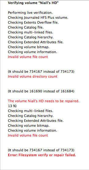

I get this (screenshot) when I try verify disk in Disk utility. Any ideas how I can fix?

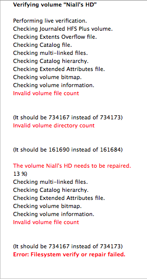

Did doing "Repair" do anything? I had a disk fail with some similar messages that Repair didn't do piddly for... I ran some data rescue software and was able to save most of the important files and then had to repartition and format the drive ('twas the only way).
Looks like a few of your files/directories got corrupted or otherwise mucked up.
Best bet is to do the following:
  1. Back up or clone your hard drive immediately.
  2. Repair the disk while booted from your install CD/DVD (or another partition)
  3. If that doesn't work, try repairing with a more robust disk utility such as DiskWarrior or TechTool Pro
  4. If all else fails, secure your backups, reformat your disk and restore your files
Best of luck!
