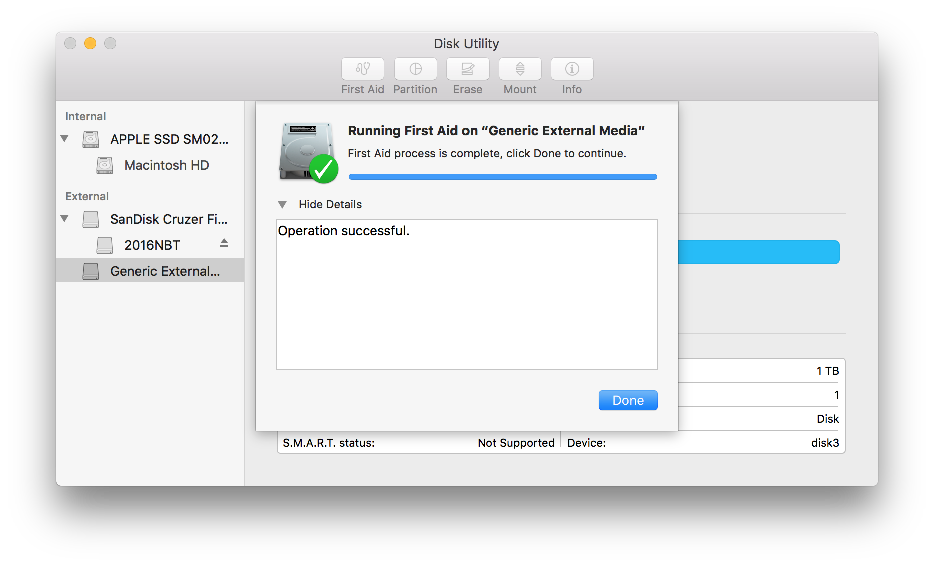

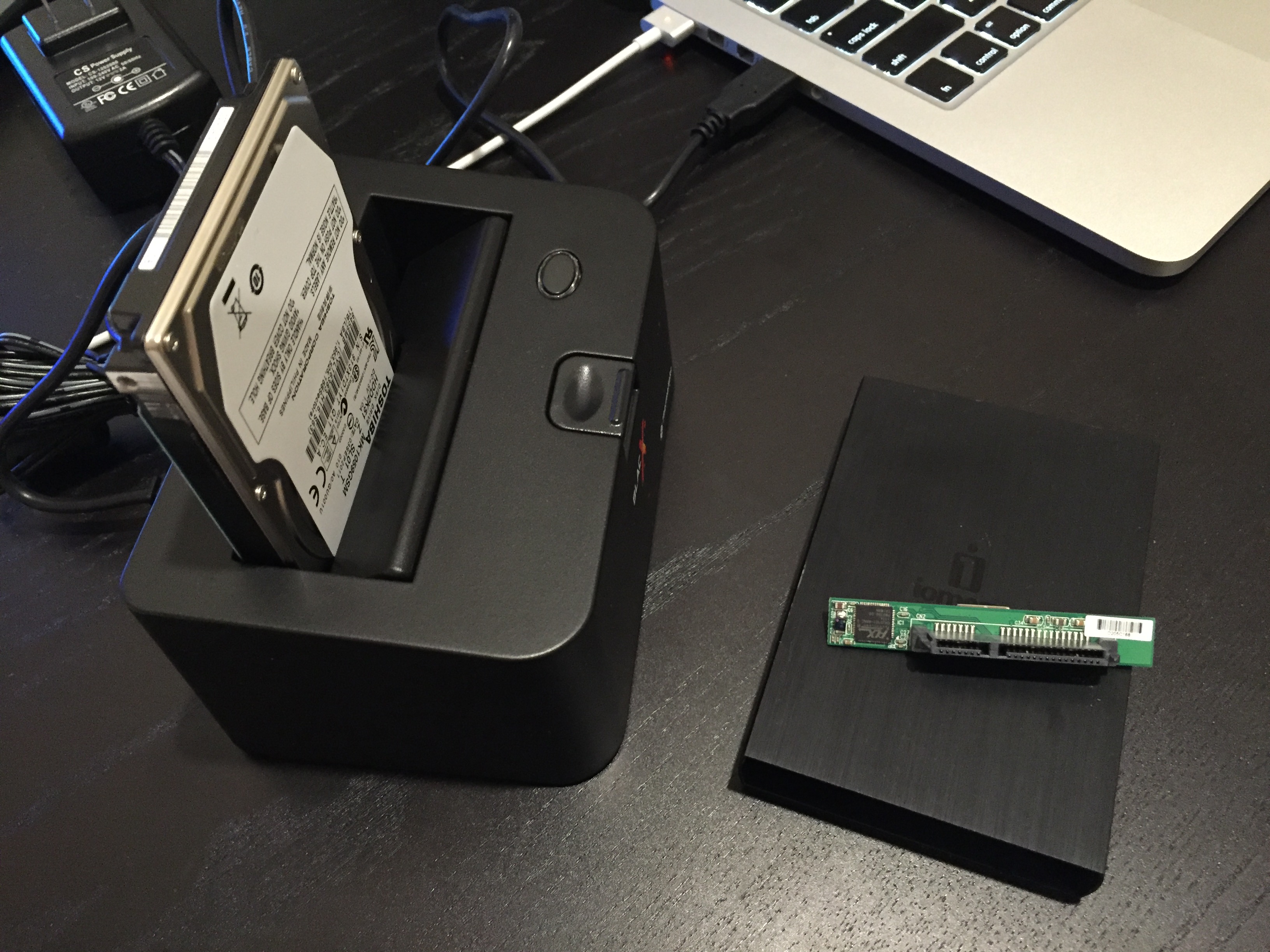

My Iomega 1TB USB 3.0 decided to die on me. Plugging it into 2 Mac OS computers and 1 Windows 7 laptop using different cables and the different USB ports avail did nothing: the platters spin but the HDD won't mount. It could be the controller... who knows. I didn't have the patience and cracked the enclosure opened to find a Toshiba HDD.

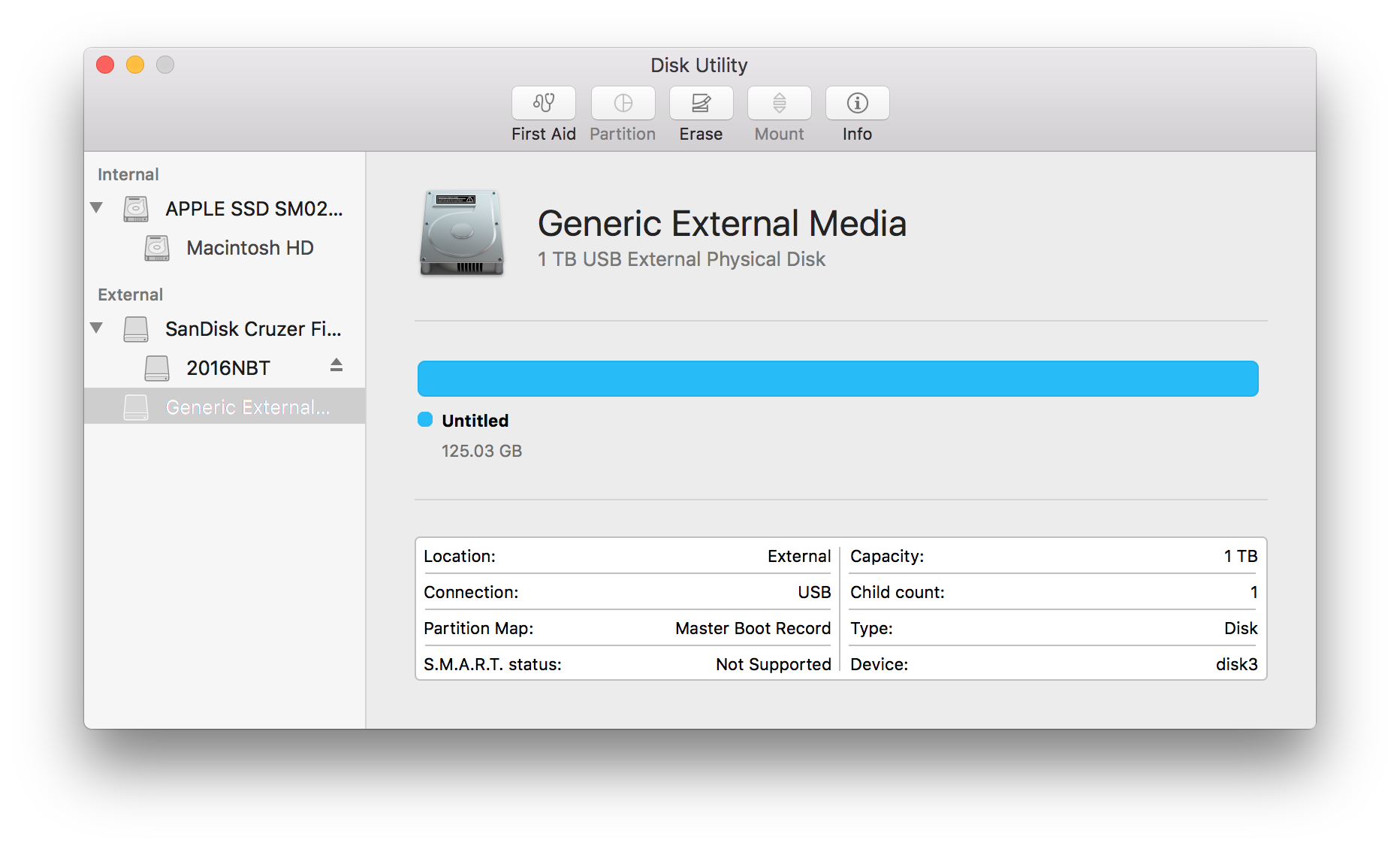

I have a dock and using that, Disk Utility sees the drive and actually prompt me to initialize it when plugging it in. But I have no option to do so in Disk Utility.

Pictures attached.

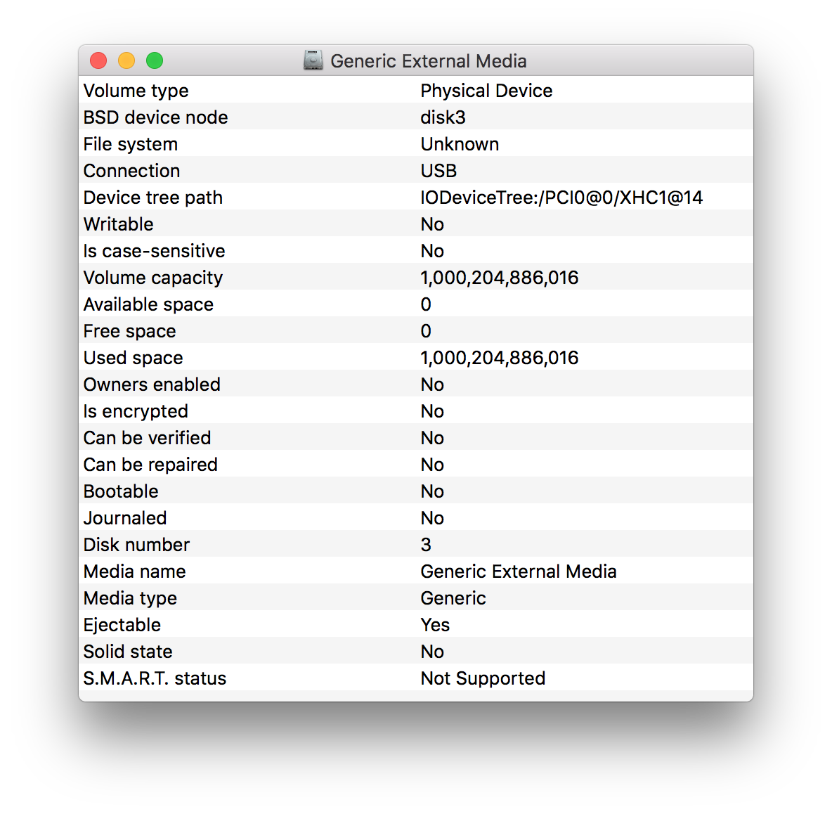

Having said that, I have used the following technique to recover data on a drive partition that wouldn't mount and couldn't be accessed via the finder (even with DataRescue):
1. Reinitialize drive to 1 partition -- BUT -- DO NOT use the secure erase feature, just do quick initialization (this leaves data on the platters "untouched"
2. Mount re-initialized drive in the finder (of course, it shows up as being "empty" -- but remember, the old data still exists "out on the sectors" of the platters)
3. Now, DR can access the drive. DR will "go around" the directory, "go right to the platters", and scavenge and re-assemble the old data
4. You -DO- need a SECOND drive which serves as the "scratch drive" to receive the recovered data.
5. You will probably lose all previous folder hierarchies and many if not most file names. This can be "par for the course" with data recovery, but the consolation is that you get the data itself back.
I agree with Fishrrman instructions but I recommend first using cloning feature in Data Rescue or other such software because working directly with a hard drive that has mechanical problems is risky.
Once you have made a clone to external drive you can scan it to recover data to another drive. You likely need to use Deep Scan feature because Quick Scan is unlikely to find any data when drive has serious problems.
