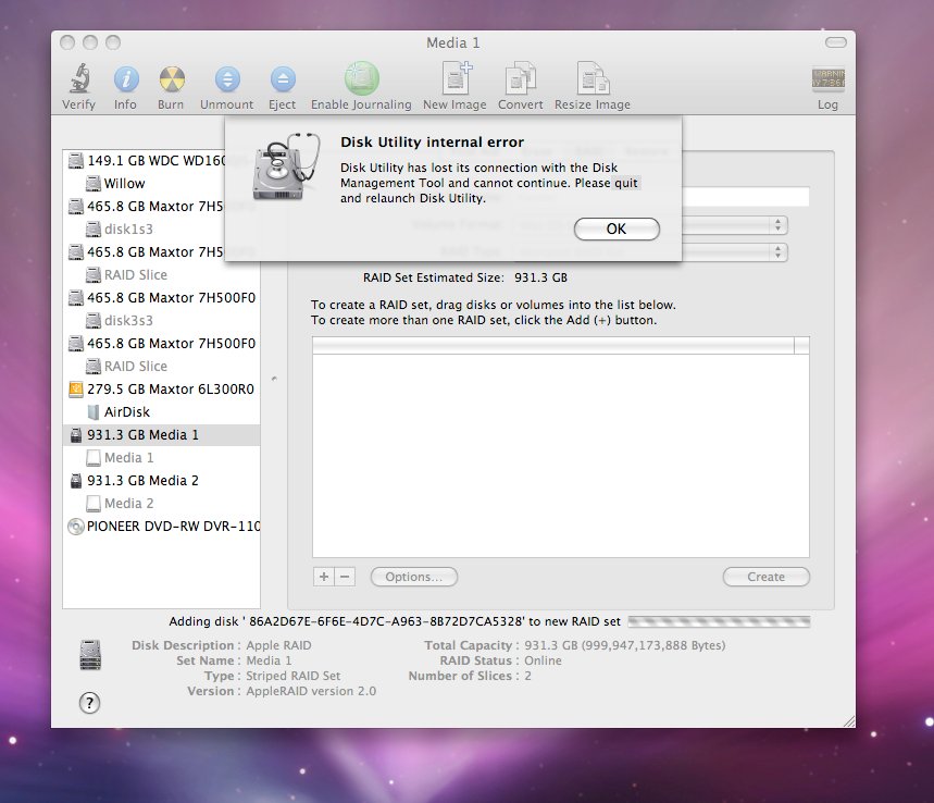

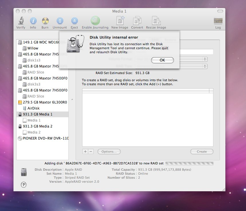

Now I can build the two striped containers without issue, but every time I try to build the mirrored container Disk Utility quits. I have attached a screenshot of the error for you to look at, but it says, "Disk Utility Internal Error. Disk Utility has lost its connection with the Disk Management Tool and cannot continue."

• Screen shot of the error

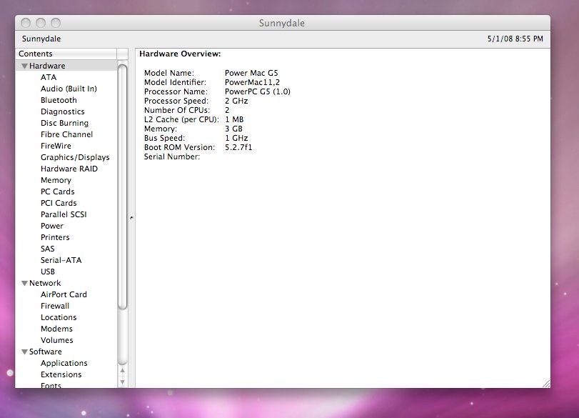

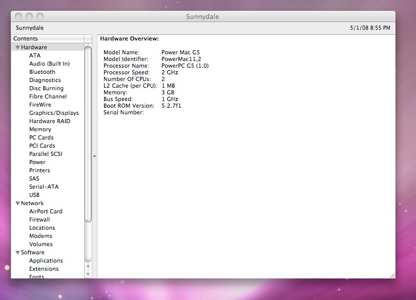

• Screen shot of what my computer is (I have run software update and I am totally current)

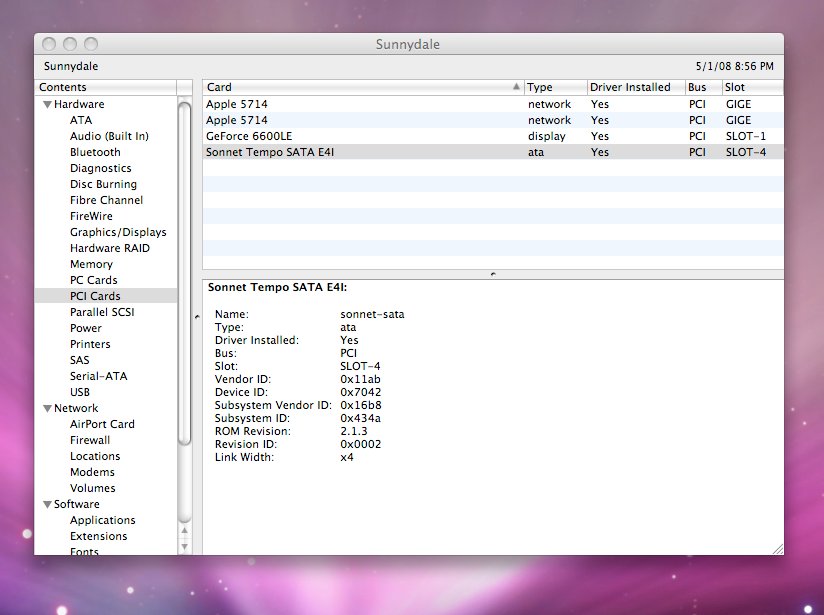

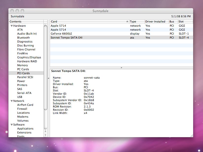

• Screenshot of the cards info

My System is a 2 GHZ G5 running 10.5.2 and all updates, I have 3 GB of RAM, and I am not using any 3rd party disk tools.
