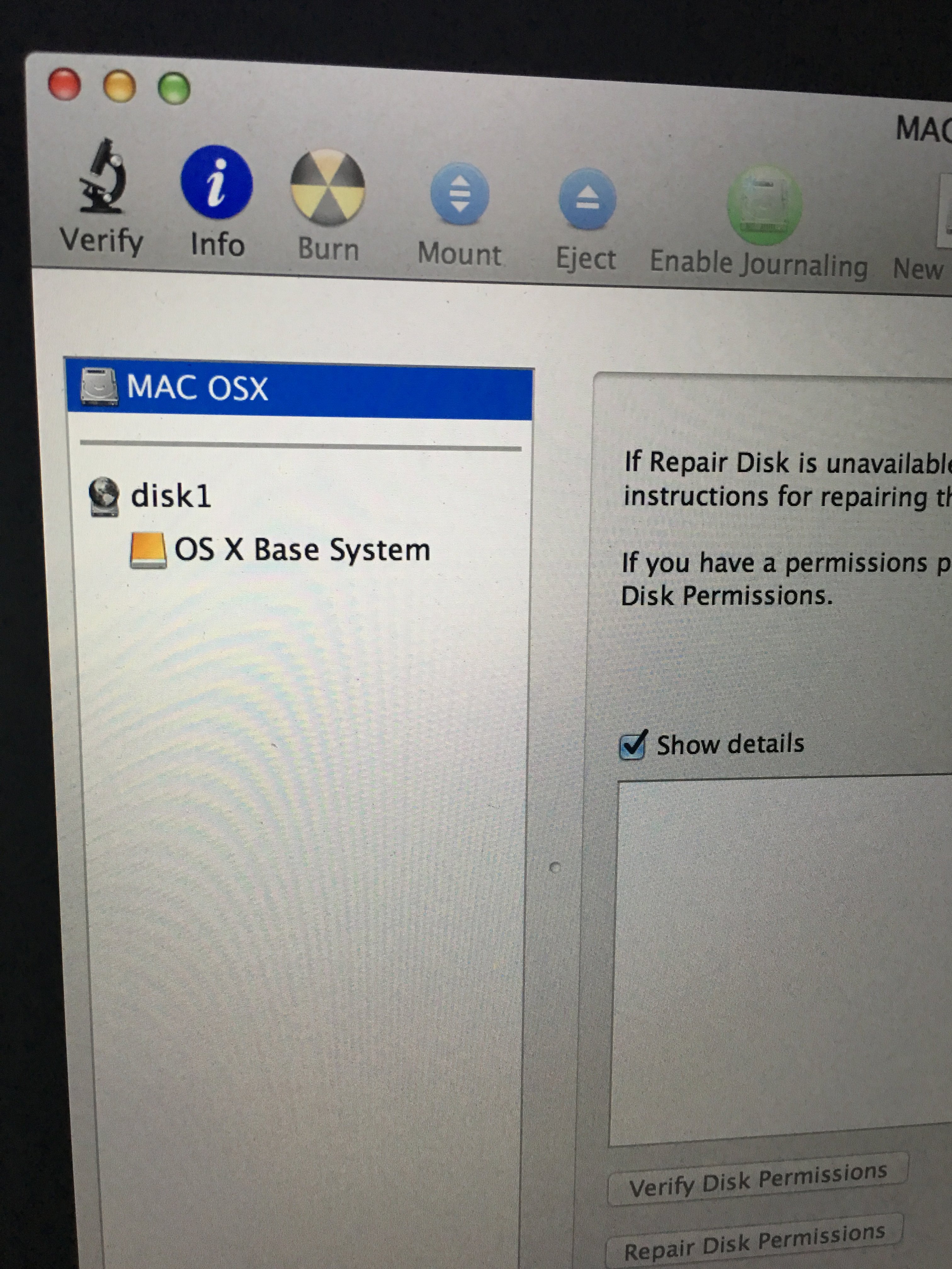

Please help with this, I don't know how I managed to mess this up. What can I do to fix? Was doing a clean install wand wanted to erase the disc.
[doublepost=1461026801][/doublepost]In meantime I have plugged in a blank external drive and installed OSX on that. Do you think after that if I do a clean install a master boot record will show up?
Have I 'bricked' my MacBook?

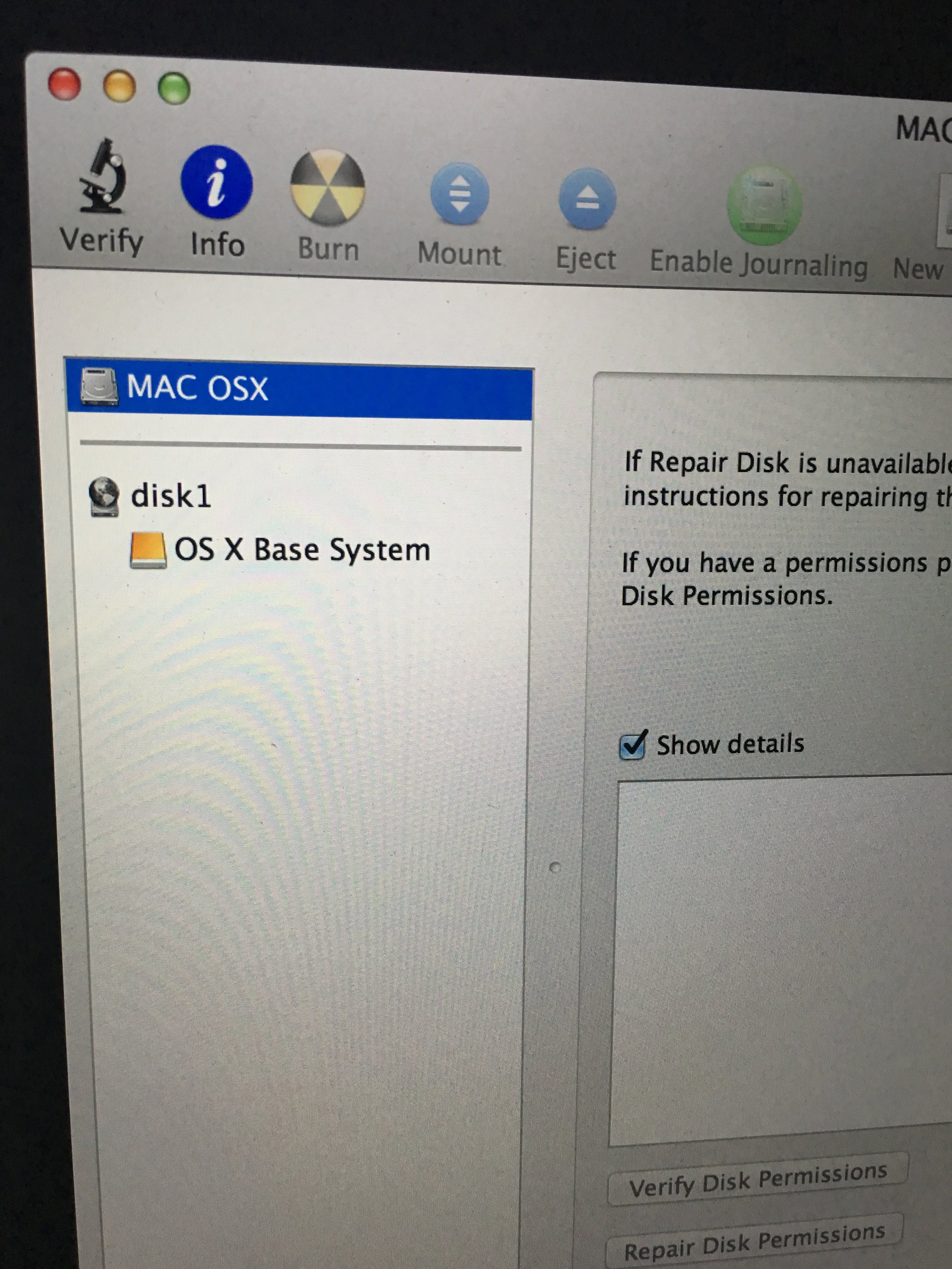

View attachment 627506 Please help with this, I don't know how I managed to mess this up. What can I do to fix? Was doing a clean install wand wanted to erase the disc.
Boot back to recovery like you did before then in the Utilities menu open Terminal. Then run the command below. That should remove the core storage volume I believe we are seeing at the top there in Disk Utility.
Code:
diskutil cs delete "MAC OSX"
Then quit Terminal and go back to Disk Utility. Go to the erase tab and select the internal drive then format it to Mac OS Extended (Journaled). Then quit Disk Util and you can reinstall the OS.
Your are both TOTAL LEGENDS! Thank you so much guys, genuinly thanks so much! All sorted now, and on the plus side my mum thinks I'm a Mac genius....but in the end I said i found help on this forum!!
