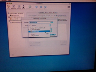

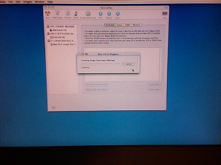

I am attaching 2 scrn prints illustrating as far as I got inthe NewImage process. The "newImageErrorMessage" appears once I SAVE from NewImageStartUpScreen.

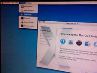

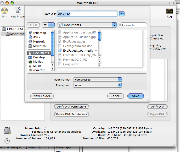

That's a good start. Unfortunately, it's not possible to obtain screenshots while using the OS X DVD, so I did it on my iMac and used my MacBook's iSight. The basic process is as follows (be aware this takes a while):
1. Insert the OS X DVD into the computer
2. Plug in an external hard drive (if you have another partition on the internal hard drive that is large enough, this is not necessary)
3. Reboot into the DVD (hold down the 'C' key after the chime)
4. Select the language for setup
5. Select Utilities ->Disk Utility from the menu
6. Select File -> New -> Disk image from folder from the menu
7. In the next window, click Macintosh HD, and then "Image"
8. Save the image to the external hard drive/other partition
That's about it. When you want to re-image, just reboot into the DVD and choose the Restore tab in Disk Utility.
Alternatively, you could use one of the tools from Bombich.com (these in my opinion are easier and better than using disk utility).
Re-installing the OS is completely unnecessary.
By the way, for repairing the disk, you do the first 6 steps above, then select the disk, and click "Repair Disk".
Lastly, I hadn't done this for a while, so forgot it doesn't need to be unmounted, it's just that the disk you're imaging can't be the system disk where the loaded Operating System resides. I've been using the dd command on the command line too much.
