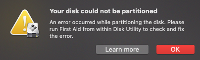

Yes. At the end of running Bootcamp it shows the error that the selected drive could not be partition. Which is "disk1s1".

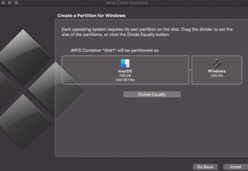

Hi,
Attachment shows prior to Install. An, too the error message.
Charles

Yes. The only thing I can see is that install is looking for a "Container" to partition.
If so how would you accomplish this and how shouled it be formated.
Charles

Sometimes BootCamp has failed to partition if the drive is too full or if there's some other issue with the disk. It might be necessary to back the whole thing up and reformat.

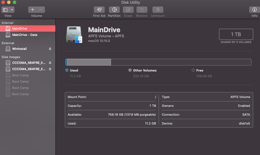

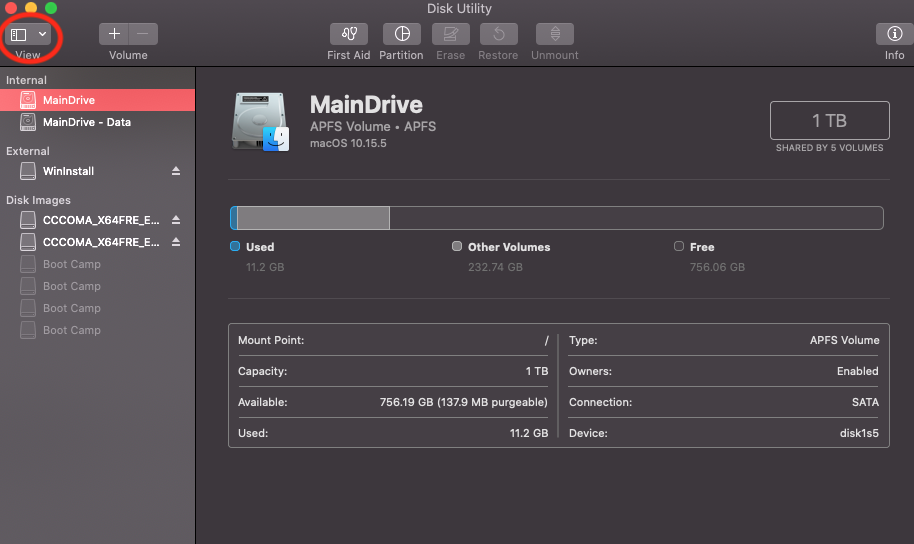

I'm not entirely sure it will help with the bootcamp installer, but in Disk Utility make sure that you have "Show All Disks" turned on. Find the drop down at the top right of the window. That should allow you to see the container and all disks within it.

Windows would NOT be able to install to any container. I think there are boot camp drivers that will let you access the volumes within a container, which would have a volume (or several volumes) that will be formatted APFS. But, the Windows installer can't do anything with an APFS partition. It would have to be a separate, non-APFS partition. That's what the Boot Camp assistant is supposed to do for you. And, as you can read above, sometimes that Boot Camp assistant is no help at all.
Baudlink post above is also not quite accurate. The "Show All Devices" is from the "View" icon in the top left corner of the DU window, and the screenshot posted there does not have that View option selected.
