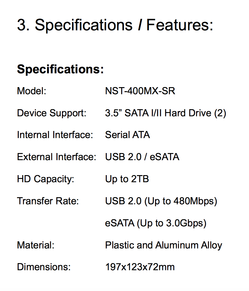

The enclosure specs states it supports up to 8TB drives. It is a NexStar MX.
Also, we had 2TB drives in the enclosure previously and they ran fine.

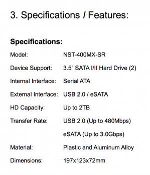

^^^^User's Manual says this:

We have a different model with Firewire and USB 3.0. The manual I have for it says up to 8TB.
However, if it only supports up to 2TB, why will it not let me format them as 2TB??
I contacted support and it turns out that the enclosure we have does not support more than 2TB. So you were correct @flowrider .
