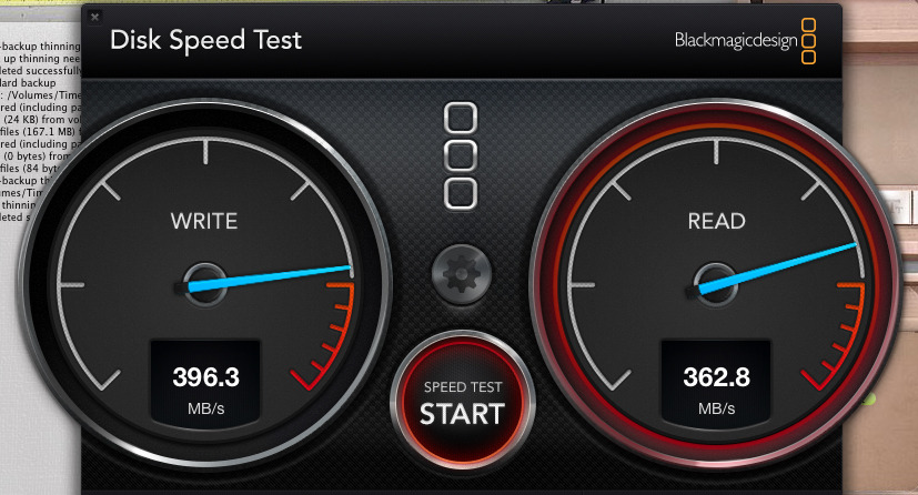

Something is strange there. In single drive I get like 175MB/s average (across the platter) and around 190MB/s sustained for the 1st 65% of the platter, and like 220 to 230MB/s burst.
In RAID0 with those drives I get 400MB/s sustained, 500MB/s burst, and bout 370MB/s "average".

Well, also to consider is that you really don't get 6TB of storage with that setup. At least not 6TB of fast stable storage. One needs to keep rotational media at least 40% empty for stability, speed, and migration concerns.

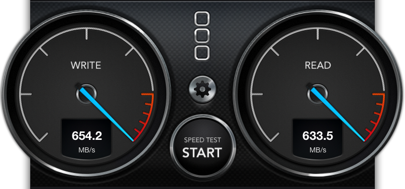

Yeah, IIRC BlackMagic tries to be less synthetic by encoding and decoding the streams. So those rates are encoded stream rates. Still in that bench I get pretty good; Here's two of them in RAID 0 with the read speed on it's way up to the mid/high 380's:
And with the newer version of BM DST they stick in place for better screen-shotting. Here's 4 of those drives in RAID0:
And there's still a difference even with the newer version. Other benchmarkers show rates of around 700MB/s and slightly over with that setup. Personally I like this way best. It's faster at all things (even 4k files @ around 40MB/s average) than a single super fast SSD, the overall cost is still less than a single sizable superfast SSD and of course that's 12TB (or about 7TB managed). The only downside is that it takes up 4 of the 6 internal SATAII connections.
