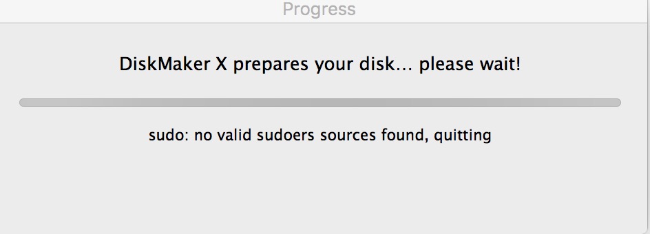

I want to use this tool, to make a bootable sd card with el capitan.
I use the latest version of diskmaker x, 5.01.
I have also the installer app of el capitan.
The application starts, but after a while I see this message, and it seems stuck there forever
What is wrong?
Can you please help me?
I think you are getting that error because you are logged in to a standard account and not as admin account under OS X.

If you have an admin account, then your sudoers file is not correct, and might be corrupted because of a bad OS X install.

The best fix for the sudoers file (unless you want to run a few terminal commands, which may not fix the issue), is to - Reinstall OS X.

DiskmakerX works fine on El Capitan. I have used it to create 5 or 6 USB installers in El Cap. The main issue for the OP is the sudoers file is corrupted, or incorrectly configured, or maybe just missing. The OS X reinstall is what is needed. Booting to the installer will work best from an actual working boot partition. DiskMakerX will make one, but you have to get past the sudoers file (as you have to authenticate to get DiskmakerX to make the installer)

Do you have a problem using sudo if you make a new admin user, then log in to that fresh admin account?
If sudo works with another admin account, then it's a problem with your normal user account.
If sudo still refuses your requests, then it's a general system problem. Best fixed with a reinstall - refer to the 3 steps in this post.
