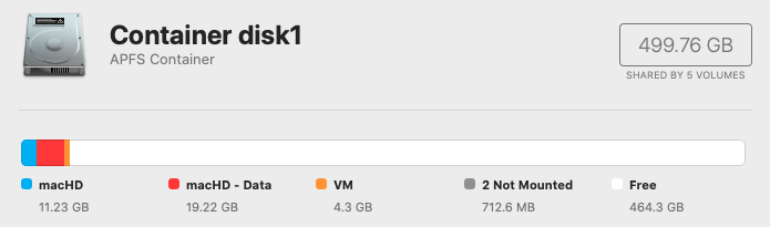

DiskUtility: Volume count 5: 2x APFS volumes. 1x VM. 2x not mounted. (Screenshot attached).
ADFS macHDD where I see Applications, Library, System, Users - everything really.
ADFS volume is macHDD - Data. What is this? It does not seem to be browsable in Finder.
VM. I'm guess this is virtual memory.
Two unmounted volumes. What are these please?
Thanks!

Did you name it macHD or did it come like that? That's not the default name ("Macintosh HD" is).
That's normal, since OS 11 I think. Any files you create or modify are transparently saved to the Data volume, so that the main system volume remains untouched. When you do "Erase All Content and Settings" it'll wipe the Data volume, resulting in a 'clean' system. I have no idea what happens to the other volumes when you do this though.
Reactions: RuntimeError
The unmounted volumes are the Recovery volume. And the OS volume! What happens with the OS is that a snapshot of it is created and the system runs off that.
In following example, #3 and #5 are not mounted, while "OS" is #6.

Refurbished, but not by Apple -- you have no idea what you get.
I would urge you to do a "nuke'n pave" (Ignore what is on the drive, boot to an installer, erase the drive (not just the macHD volume, but erase the device, clearing all partitions). You can name the drive whatever you like. Install macOS, which will make a new set of volumes on the APFS container. One of those volumes will have the Data added to the name (don't try to add that Data name yourself, let the installer do that!)
Normal since macOS 10.15 Catalina. macOS 11 Big Sur added snapshots.

The volumes are identified by volume UUID and role so changing the volume names should have an effect.
After some install fails, you might end up with something like "MacHD - Data - Data". In this case, you want to check the diskutil apfs list and/or diskutil info -all output to verify which volumes are paired as a volume group (a data role and system role volumes) and which volumes have each role (data, vm, recovery, preboot, system). Then you can decide if the names are correctly matching ("Mac HD - Data" for the data role, and "Mac HD" for the system role and snapshots). I think you can rename a volume in the Finder and the corresponding data role volume will be renamed appropriately?
