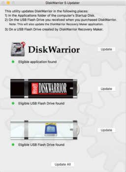

I downloaded the Updater, ran it, it found the installed DW 5.0, I selected "Update", but the update failed with “Error 5012”. Now DW 5.0 will no longer launch. A re-run of the Updater no longer finds a eligible DW app.
I sent a email to Alsoft tech support. Fortunately I have multiple backups, but I would prefer to hear back from Alsoft before trying to restore my DW 5.0.

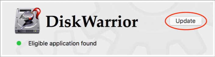

DiskWarrior 5.1 Update Install Instructions
Note: An internet connection is required for the update to work
Installing DiskWarrior Updater
To install the software, simply drag the DiskWarrior Updater icon into the Applications folder of the computer’s main hard drive.
Launching DiskWarrior Updater
To launch the software, double-click on the installed icon. This will present the DiskWarrior Updater main window.
The DiskWarrior Updater main window will contain up to three sections for possible update candidates. Each candidate may be updated individually by pressing the Update button to the right of it, or all may updated as a group by pressing the Update All button.
1) Serialized DiskWarrior Application in the Applications Folder

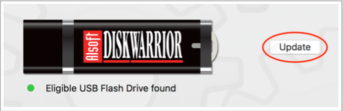

2) DiskWarrior USB Flash Drive
This is the USB Flash Drive that you received when you purchased DiskWarrior.
Note: Updating this USB Flash Drive will replace the DW partition. Make certain you have made a safe copy of any files that may have been stored on this partition of the drive.
If there are multiple devices connected to the computer which meet the parameters of the software, the first one found will be updated.

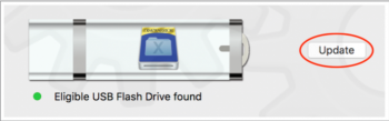

3) DiskWarrior Recovery USB Flash Drive
This option will only show up if a USB Flash Drive created by DiskWarrior Recovery Maker is found.
Updating an Installed DiskWarrior Application
If a serialized DiskWarrior Application was found in the Applications folder hierarchy that is eligible, then the Update button to the right will become enabled.
Clicking the Update button will commence downloading the update. Once the download is complete, you will be prompted to authenticate with an Administrator password and the application will be replaced with the newer version and the old version will be moved to the trash.

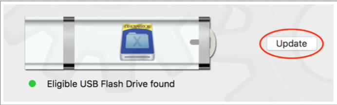

Updating a DiskWarrior USB Flash Drive
If an eligible DiskWarrior USB Flash Drive was found, the Update button to the right will become enabled. A valid DiskWarrior USB Flash Drive must contain the red DW partition and either the green or blue DiskWarrior Recovery partition.
Clicking the Update button will commence downloading the update. Once the download is complete, you will be prompted to authenticate with an Administrator password and the DW partition will be replaced with the newer version.
Note: Replacing the contents of this partition deletes all the data on that partition. Make certain you have made a safe copy of any files that may have been stored on this partition of the USB Flash Drive. This process also updates DiskWarrior Recovery Maker.
If this USB Flash Drive also contains a blue DiskWarrior Recovery partition, the application on that partition will be updated and the old version moved to the trash.
Updating a DiskWarrior Recovery USB Flash Drive
A DiskWarrior Recovery USB Flash Drive is a USB Flash Drive that was created with the DiskWarrior Recovery Maker application. If an eligible DiskWarrior Recovery USB Flash Drive was found, the Update button to the right will become enabled. If a DiskWarrior Recovery USB Flash Drive was not found, this section of the window will not be shown.
I got error 5011. I quit the updater then selected to run again and it worked. Had a beachball through the entire process but in the end it activated and was successful. I think perhaps their server is overloaded and it failed to download all the bits needed.
I would highly advise everyone to backup the flash drive before updating.
Reactions: TonyK and CoastalOR
Update: The update worked for me now. I think the server was busy as dianeoforegon suggested. I also found the install instructions posted by CheMillan helpful.

I got the 5011 error as well. The processes it went through were:
  1. Downloading
  2. getting pw because the app wanted to change the disk
  3. updating - then the error during this process.
I run Sophos virus scanner, so I turned it off and tried again. Viola! the operation completed.
