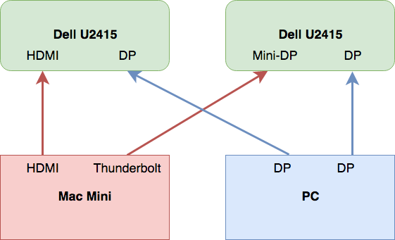

1) we bought a Dell U2415 instead of the NEC mentioned earlier. It's got HDMI, DisplayPort and Mini DisplayPort connections.
2) we want to use the two monitors with both a PC and the Mac Mini.
I've been told that for a 2nd monitor (for the Mac Mini) we need to use the HDMI connector.
So.... (in theory at least) I think I've figured out a solution which doesn't involve an expensive KVR switch, but instead we just select the appropriate input for each display (using the Dell U2415 On-Screen-Display menu) so we don't ever have to disconnect any cables:
The reason I'm asking if a Mini-DP to Mini-DP cable could be used with the Mac (from the Thunderbolt connector) is because it would be easier to remember which inputs correspond to each computer. In the above setup we would set up both monitors for their DP inputs when using the PC, and when using the Mac we'd go HDMI for one of the monitors and Mini-DP for the other -"Mini" being the operative word, as in "Mac Mini" 😉
Would this work?
