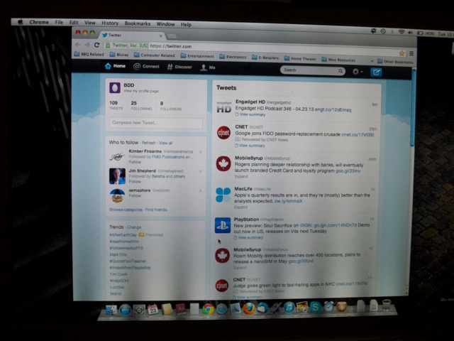

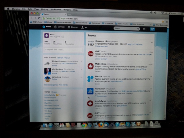

Well, it happened again last night. This time I took a photo of the "spotlight effect". And again i had to power down my MBP. Remove battery. Pop it back in. Power back up. "Spotlight effect" gone. For now. Dread having to get my MBP serviced. Here is the photo...
