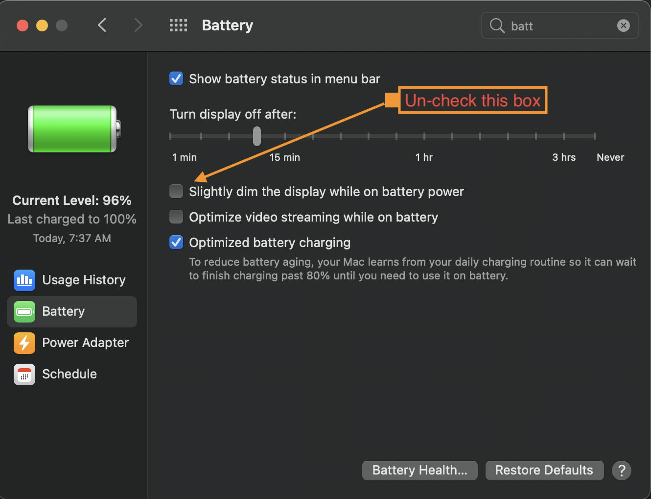

Hi @noenken,
I was experiencing the same issues and was quite puzzled. After doing some digging around I discovered the source of the issue. When on battery there is a setting under the battery page in system preferences called "Slightly dim display while on battery power" when this is un-checked the display remains at full brightness at all times.
Hope this helps,
Regards and merry Christmas!

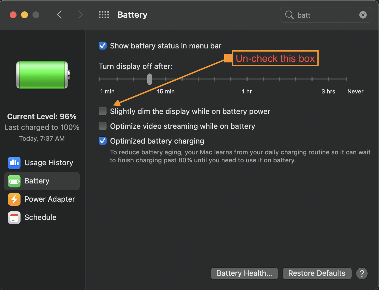

Hi @noenken,
Hope this helps,
He mentioned in the video that all the screen brightness automations from display and battery options are turned off. So it's not that. I wonder if pro m1 also has the same fault. I hope not.

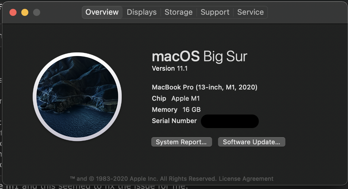

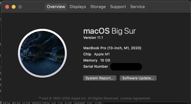

I have the m1 and this seemed to fix the issue for me.
