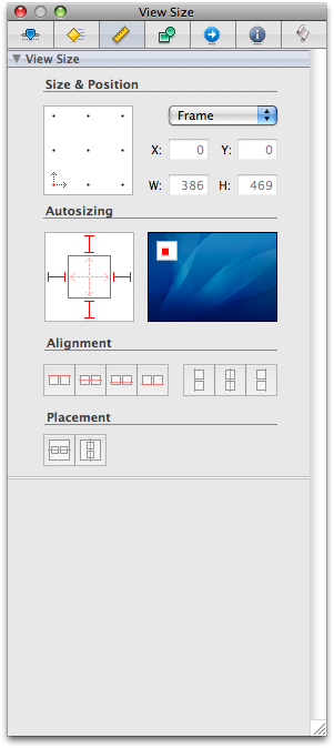

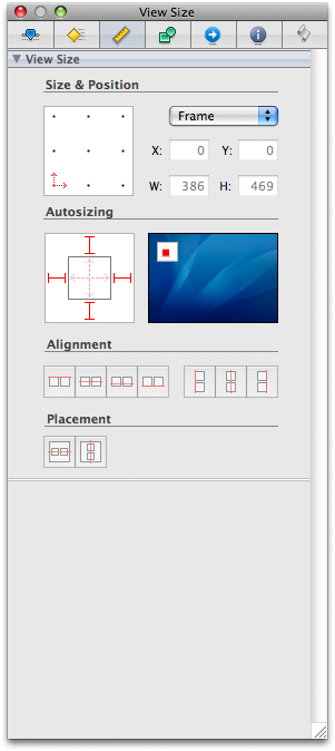

I'll need quite a bit of time to get used to interface builder though... I had some trouble obtaining a button resting under the NSOutlineView to stay left-aligned to it when resizing the window... (I could only get it to work with small square button, and couldn't figure out why...)
phjo
Well, of course I do know about the size inspector, and played a lot with it !
How do you figure I finally got what I wanted?
The problem is I had a million of trial and fail sessions before it worked, and I have no idea why it finally worked, and why it failed previously...
You can try it yourself :
put a NSTableView and a NSOutlineView side by side, and one square button under each, left aligned with the two views. (The button will be a + button to add one row.)
The tableview on the left is configured to resize on both directions, sticking to the top, left and bottom on the window
The outlineview on the right is configured to resize on both directions, sticking to the top, right and bottom on the window
The two buttons are not resizable, and stick only to the bottom, and finally by selecting the left tableview and its associated button, I tried to declare them left-aligned, ditto for the outlineview and its button.
Now when I test the resizing in the cocoa simulator, most of the time, one of the two buttons at least do not stay left-aligned with its view, and I have no idea why sometimes it works (and then I try not to touch anything from that moment !) and the rest of the time it doesn't...
The fact that I got it to work lead me to think my understanding of the size inspector is correct, but please correct me if I am wrong...
EDIT : A split view is better for what I want to achieve as far as UI goes. I am going this route now...
phjo
What I was trying to point out is that the moving graphic on the blue background, shows how the object should move around with resizing 😉.
