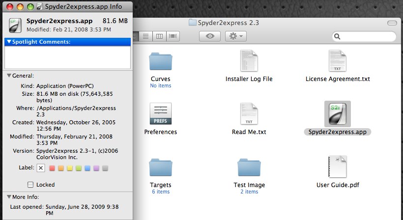

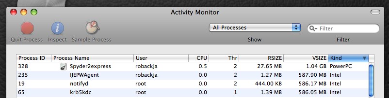

Not that I don't believe you but where did you see that spyder2express is for PPC only?
PPC. See 2 attachments. So obviously Intel systems can run the PowerPC stuff, but my point was, its OUTDATED and not maintained.
For starters, the problem is with 10.5.6 and PowerPC systems. I have only Intel.
Secondly, I only have Apple monitors. No Apple monitors support DDC. They require a special driver (that ColorEyes installs with their product), so Apple monitors are not affected by this problem. (confirmed on coloreyes user forums by site admin)
Thanks for answering my questions.
I didn't know Leopard could run PPC apps nor did I know that Activity Monitor could list them either.
