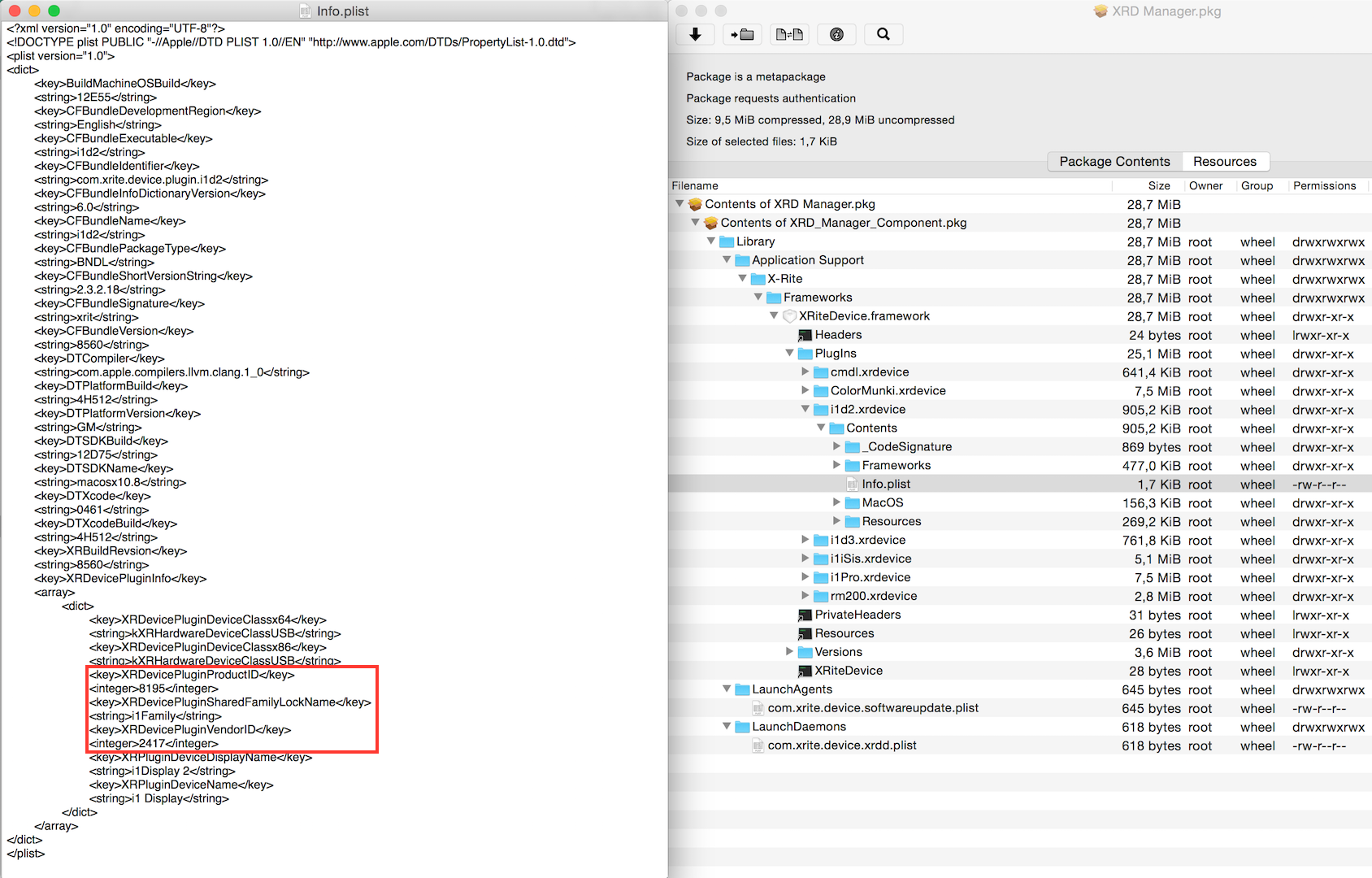

Then the only suggestion I can make - investigate the possibility to change USB Device and Vendor ID-s in X-Rite driver to match your colorimeter's ID-s. The tricky part here - signed code. But worth a try.
