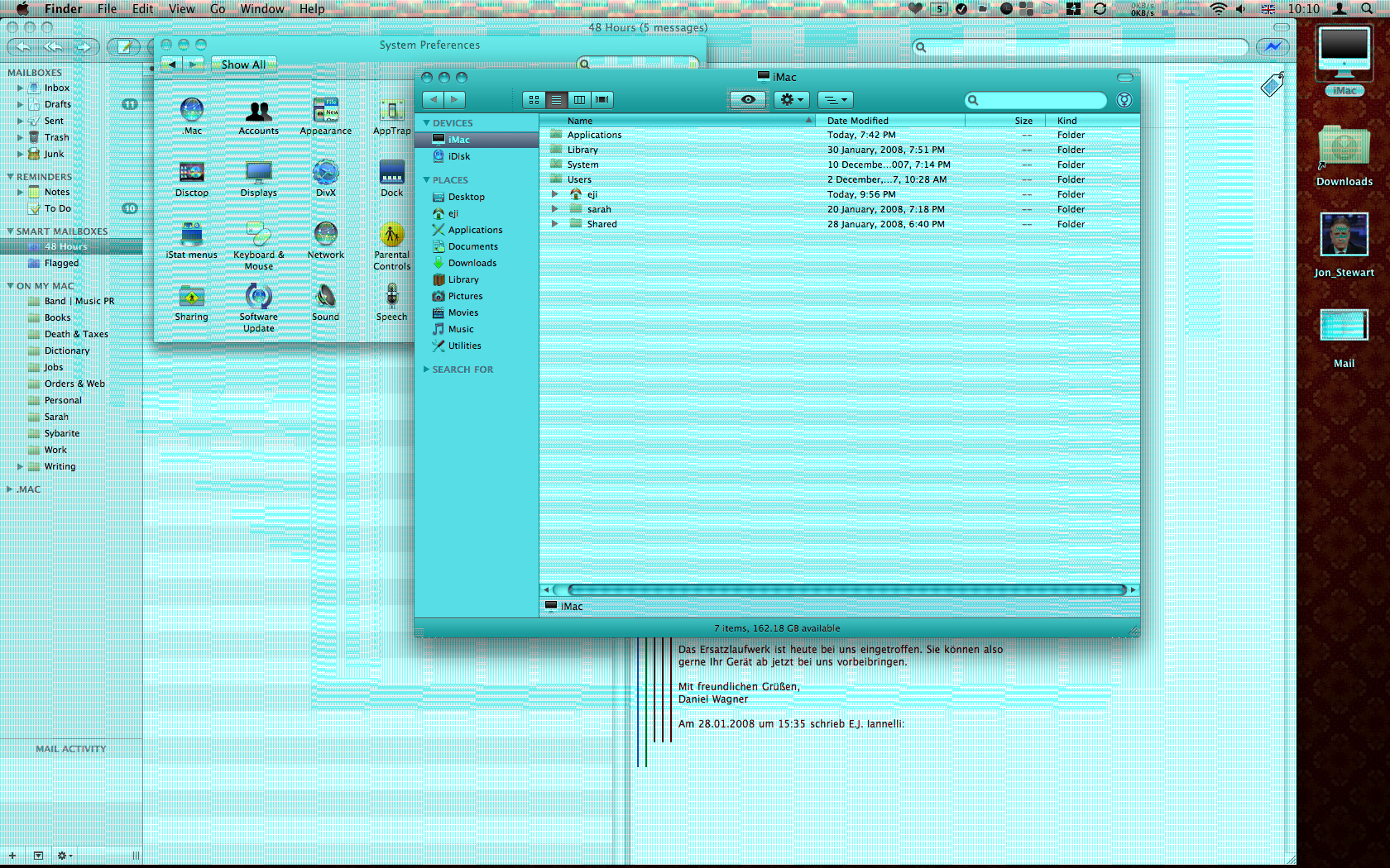

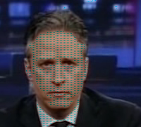

Okay, this is bizarre. I was watching The Simpsons tonight in VLC when suddenly the screen developed these strange alternating bars.
At first I thought it was a hardware error. My iMac was fresh from the Apple repair shop for a replacement DVD burner and had been running for about two hours.
But see the images below. Those are screenshots. So I'm left suspecting that it's some crazy software glitch and not a hardware error. And the odder thing is: Some things display fine except for localized corruption. Look at that screenshot of John Stewart. Just his face is covered with these bars. Although this corruption covers the entire screen, sometimes windows aren't pixellated/blocky at all, they just have a bluish hue to them.
What gives? Can anyone guess as to what the problem might be? Have you ever seen anything like this?
I've already messed with calibration settings under System Prefs, running through all sorts of options (resolution, gamma, etc). I ran Onyx and cleaned all my caches. Then I reset the PRAM and SMU. I even left the iMac to cool off for about 20 minutes. Nothing works so far.

I found out the hard way that it is entirely possible for hardware problems to show up in screenshots.
If you're saying "What?", that was my reaction. However, it appears as if OSX pulls the screenshot directly from the display buffer (or something), such that if the graphics chip is screwing up (as opposed to just a bad cable, which of course wouldn't show up anywhere in software), it can very much show up in screenshots.
In my case, the 9800 in my G5 tower went out, and the severely glitchy graphics screenshotted glitches and all, but it was a hardware problem (and fixed when the card was replaced under warranty).
It's pretty easy to check; load up the hardware test disc and see if it shows up there (or, hopefully, if the test itself gives an error). If so, definitely hardware. If not, STILL has a chance of being hardware, but if it doesn't show up in the OS install disc either, then you'll probably have to do a fresh OSX install to be positive.
It was interesting in my case because only 3D things were glitchy; the simple draw routines in the test disc didn't show errors, and I could even clear them up by turning off accelerated 2D display via the developer tools, but since OSX uses a bunch of "3D" acceleration even just drawing the 2D interface, that was screwy. Even Apple agreed it was a hardware problem once I'd checked carefully, though.
Good luck, and hope it's just a software issue in your case.
You're right, Makosuke. It's hardware. I ran the diagnostics off the install disc and VRAM came up with this error (which I could barely make out for the corruption):
ERROR CODE 2ATI/1/4 113-xxxxx-117
Coincidentally, I Googled it afterwards and found this MR thread.
Crap. Now it's back to AppleCare.
First the power supply failed last Feb, then the DVD burner a couple of weeks ago, then the VRAM last night. This isn't looking good. And AppleCare is set to expire later this year. Think I've got any chance of handing it back in and getting a discount on a new computer?
