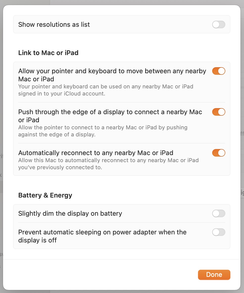

Hello. Whenever I unplug my M1 MBA and go from wall power to battery, the display dims.
That's despite the "Slightly dim the display on battery" setting being deactivated.
Any ideas why this is happening/what I can do to restore the correct behavior?

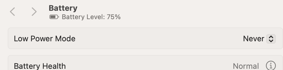

Check the "low power" settings. If it switches to low power at any point, that dims the display. it's annoying, as I'd otherwise enable the low power when on battery.
This is what it says for me.
Setting it to "Never" worked.
Now I'm not sure if this should be considered a bug. I think I'll check it on Sonoma later and if it does the same thing I might report it.
Either way, thanks to both of you 😀
I'm running Sonoma, and it does the same. I assumed it was deliberate.
It might be.
The reason I feel it might be a bug is that this the Low Power mode essentially cancels out another setting without that fact being mentioned. If using Low Power mode were to gray out the display dimming option with a note that you need to disable Low Power mode to be able to use display dimming on/off, that'd be a bit more transparent.
