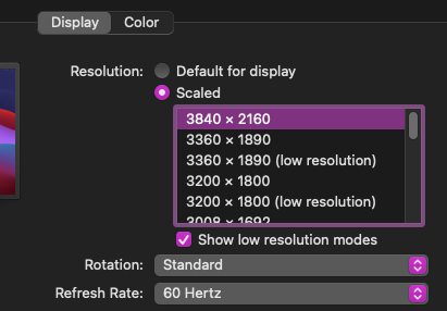

Toggling the highest/lowest resolution did not consistently change my refresh rate.
HERE'S A CONSISTENTLY WORKING SOLUTION:
1. Open display settings for affected monitor.
2. Opt + Click "Scaled" option to open additional sizes.
3. Choose "show low resolution modes" check box and change the Refresh Rate.
4. You may initially find that the refresh rate is gray and not editable. (unlike my screenshot here). In that case, change the rotation field to anything else (90, 180, 270), then switch back to standard/normal rotation. The refresh rate field will be editable.
This works 1000% of the time.
