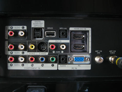

This will get you video. Now, you need to look on your HDTV or manual and see if it supports digital audio in (toslink) or RCA stereo audio in (white and red) with a HDMI/DVI signal.
Every HDTV I've ever used does.
For example, here's my TV. I use a mini-DVI to DVI adapter and a DVI to HDMI cable with my iMac. I plug the DVI to HDMI cable into HDMI input 2. Then, I plug in my RCA stereo audio jacks where it says "DVI" in.

its on the wall and evrything is behind it...i was just going of memory i did not know that the tv can use hdmi for video only and use another source for audio...thank you very much i will test my tv to make sure it can use it that way....my tv is Philips 42PF9630A

Here's a link to download the manual for your TV: http://www.p4c.philips.com/files/4/42pf9630a_37/42pf9630a_37_dfu_eng.pdf
On page 35, it indicates that if you connect your computer via HDMI, you must connect the sound via the DIGITAL AUDIO IN input. However, that looks like a coaxial input, so you will need a TOSLINK to Coaxial converter, like this: http://www.monoprice.com/products/p...=10423&cs_id=1042302&p_id=2948&seq=1&format=2
