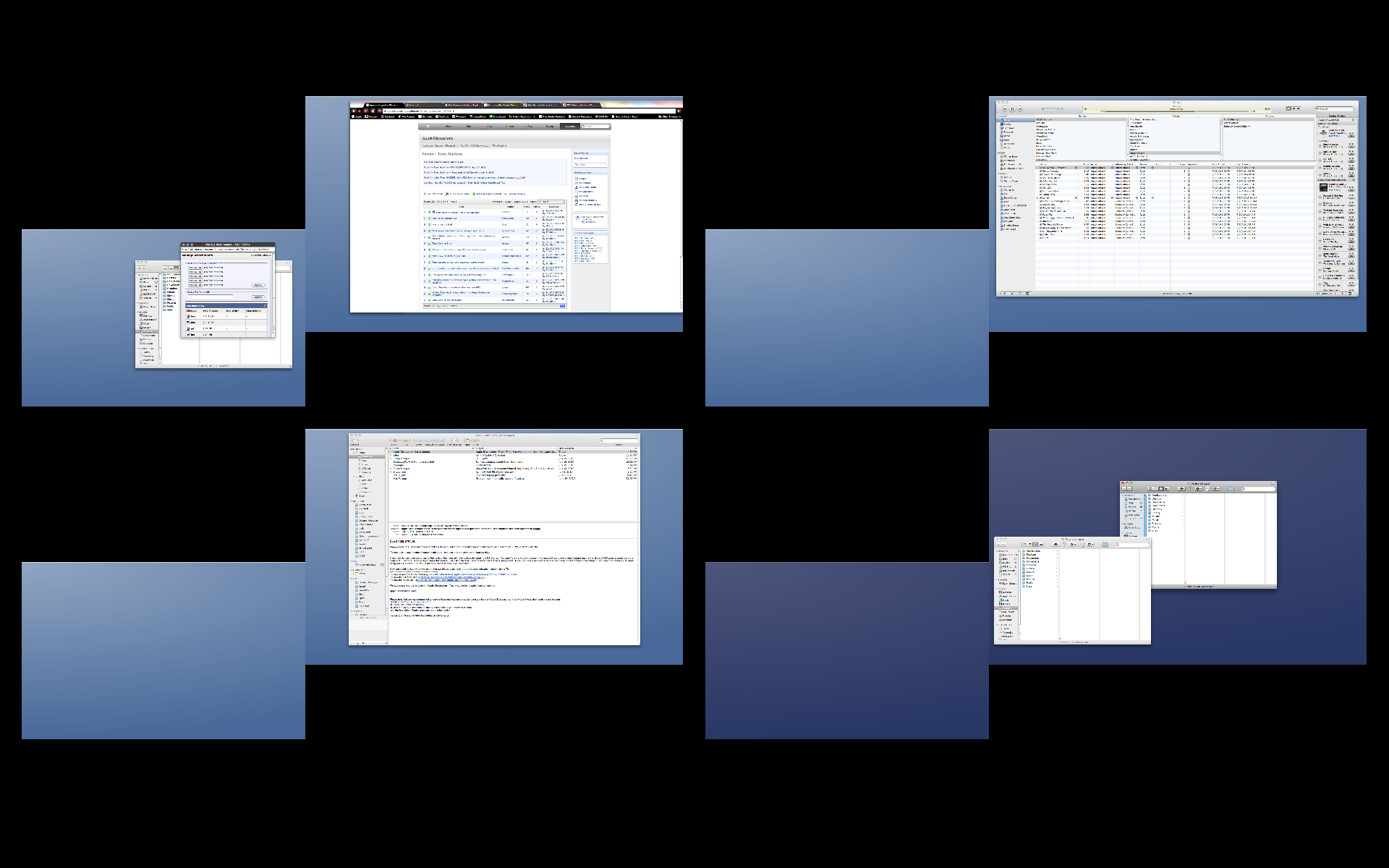

I have no idea why that is happening. However, if you keep having problems with not being able to find the window, maybe you should turn spaces on. If you set it up for a key command or hot corner to show all spaces, then you can see all displays in the main display and drag the window to wherever you want.
The first image shows all the displays in my main monitor and the second is after I dragged the finder window from my second display to the main one.
Good idea !
I just set that up, and I can now easily get hold of the windows
that might open in that phantom VGA display.
So for now, this is a useful workaround,
but I still need a permanent solution to get rid of this 'ghost'...
Thanks so far 🙂
