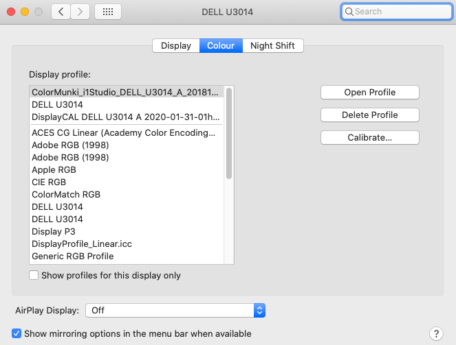

I'm using 10.15.3, and I use DisplayCAL and Colormunki Photo to Calibrate my Monitor and Create ICC for my Monitor.
In DisplayCAL I select a Testchart with 4954 colors(not sure whether the color number will be a problem)
It is so wired if I use that ICC to start up the MAC, After the login page, the mac will become SUPER slow, take few mins to load all the app, and run Chrome super slow, Even changing the chrome tab will take 2-3 secs. The scrolling and typing are almost impossible.
BUT If I activate the default ICC or other ICC create by other software, the speed will become normal again!
Even later I click back to that DisplayCAL ICC will still normal.
JUST CAN NOT BOOT WITH ICC created by DisplayCAL.
I have attached screenshot ICC info
left hand side created by i1 Studio(default software) and Right-hand side by DisplayCAL
I have also attached the ICC, does anyone know why is this? thanks a lot

I think I found a problem, it look like nothing to do with the command line
It is just because an ICC display profile, it is so wired when activating an ICC profile that create by displaycal will become very slow, even changing chrome tab will take 2 secs
when I activate the default ICC will become normal, soooo wired
here is the ICC, does anyone know why is this? thanks a lot
  • DisplayCAL DELL U3014 A 2020-01-31-01h 110cdm2 D6500 2.2 M-S 1xCurve+MTX.icc.zip

YES once I use other ICC to start up the mac will not have any problem, super wired.
I have edit the original post, can you please have a look, now become a new problem
