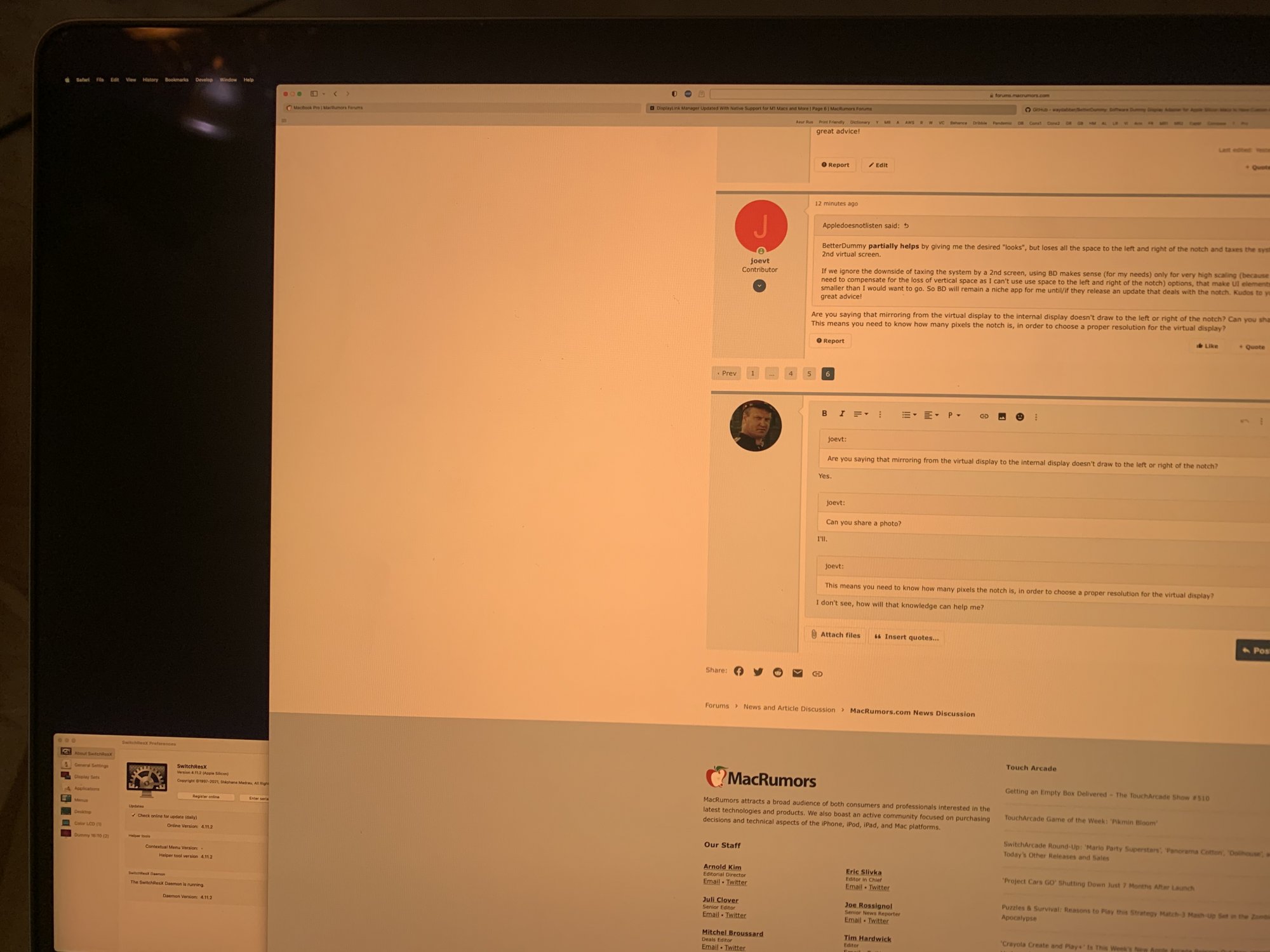

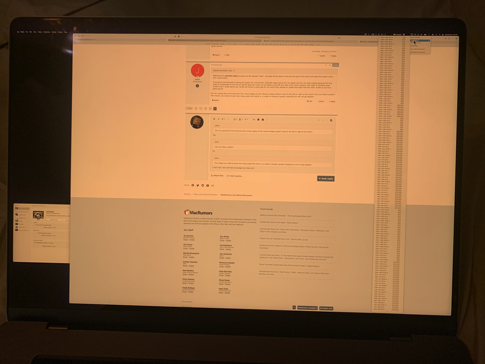

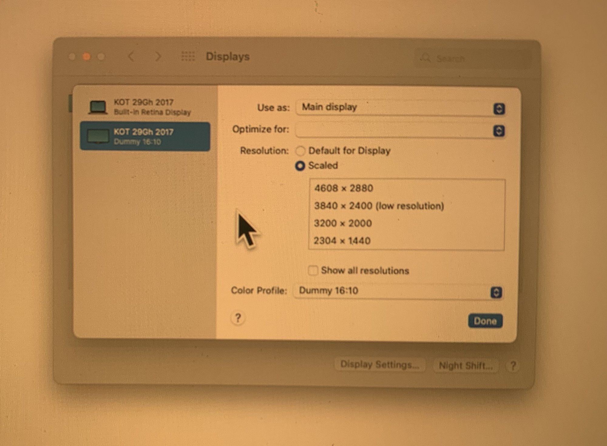

BetterDummy partially helps by giving me the desired "looks", but loses all the space to the left and right of the notch and taxes the system with a 2nd virtual screen.
If we ignore the downside of taxing the system by a 2nd screen, using BD makes sense (for my needs) only for very high scaling (because first you need to compensate for the loss of vertical space as I can't use use space to the left and right of the notch) options, that make UI elements even smaller than I would want to go. So BD will remain a niche app for me until/if they release an update that deals with the notch. Kudos to you for a great advice!
Are you saying that mirroring from the virtual display to the internal display doesn't draw to the left or right of the notch? Can you share a photo?
This means you need to know how many pixels the notch is, in order to choose a proper resolution for the virtual display?
Correct.

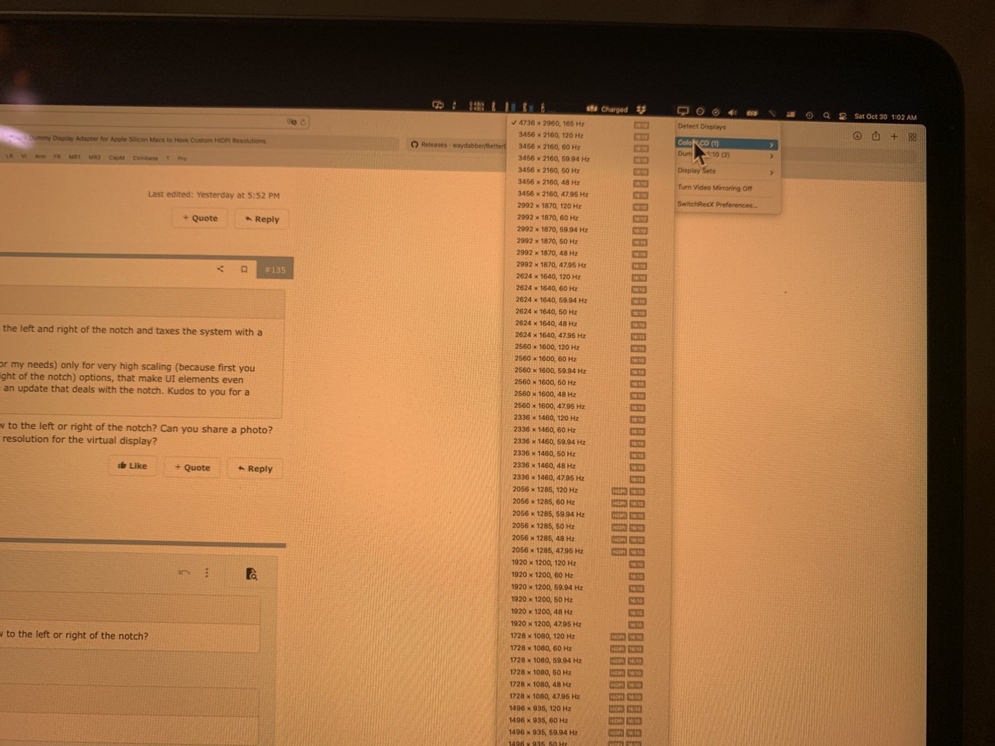

Attached!
How will this knowledge help me? As far as I understand, BD can only create a rectangle with almost any resolution, but it can't account for the notch (perhaps devs will add that later if enough folks ask them to). BD does not have 14:9, it only has 16:10, maybe 14:9 is what the devs need to add?
We probably can't get the pixels around the notch - Apple needs to add a "include notch" option for mirroring (or can a third party do it?) - but we can choose the best resolution that matches the aspect ratio of the remaining pixels.
Your display is 3456x2234.
16:10 = 3456x2160
16:9 = 3456x1944
Maybe the notch is 74 pixels (2234-2160=74)? So maybe 16:10 is the best mode?

It does not even give me the "Scale to fit option", see printscreen 🙁
With the current limitations of the apps, I think I am going to use SwitchResX as a default scaling app (because it at least partially takes advantage of the ears and does not add a second screen) and go to BD when I need extreme scaling for something.

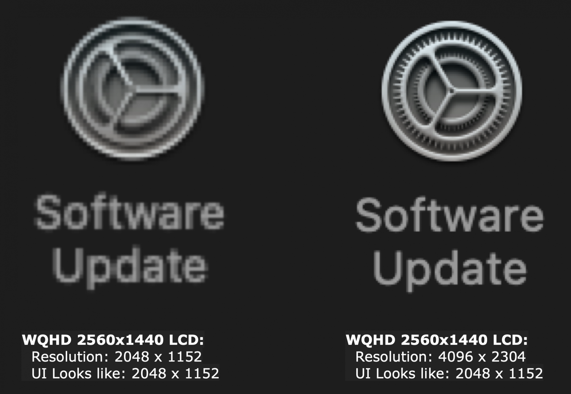

I'm sorry if I was condescending in yesterday's post, @Appledoesnotlisten. Now that it's clear what's being attempted here (HiDPI custom modes for better font interpolation etc) ... not only it makes more sense, but I want it too. 😅
Namely, the ability to run my 24" WQHD monitors at "Looks like" 2048 x 1152 resolution, but with a HiDPI rendering of 4096 x 2304 behind the scenes.
The difference should be quite apparent in this comparison. Those are screen shots from the same window, one running with HiDPI and the other without.
That was lost when I switched to M1 Air from Intel 16". I had to use a vanilla 2048 x 1152 resolution to get optimal UI proportions ... but then it was the panel's responsibility to do the sub-pixel rendering or whatever it has to do to stretch 2048 x 1152 pixels into a 2560 x 1440 canvas. Result: jazzy fonts, blurry details.
Anyway, thanks to @joevt I tried BetterDummy, and looks like it works. It's a bit of a hack, I wonder how this DisplayLink-enabled setup survives a reboot. Yet it's nice to see it works at all. Display Preferences now displays FIVE monitors, two of them virtual and stacked on top of the physical monitors.
LEFT MONITOR — WQHD 2560x1440 LCD, mirrored through BetterDummy:
Resolution: 4096 x 2304
UI Looks like: 2048 x 1152 @ 60.00Hz
MIDDLE MONITOR — LG UltraFine 5k:
Resolution: 5120 x 2880 (5K/UHD+ - Ultra High Definition Plus)
UI Looks like: 2560 x 1440 @ 60.00Hz
RIGHT MONITOR — WQHD 2560x1440 LCD, mirrored through BetterDummy:
