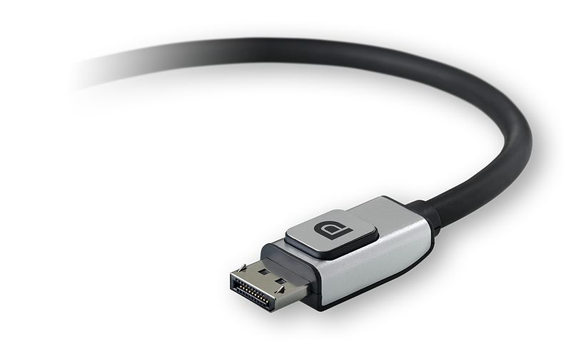

It is a different connector. I have attached a picture for reference.
I know DisplayPort is a different connector. More what I'm asking is if they actually mean DisplayPort or MiniDisplayPort.
If the monitor spec says display port, its the larger connector. If the specs say mini, then its the smaller. Typically monitors that have display port interfaces come with the larger display port connector.
