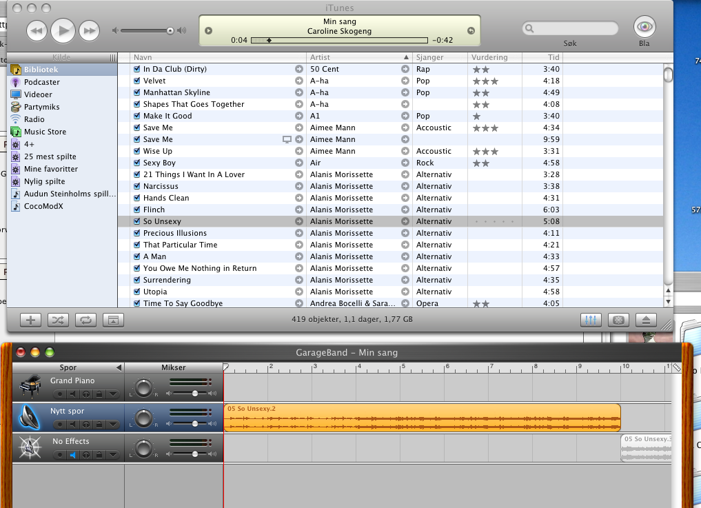

Of course this is a perfectly legal album...
1. Open iTunes, Open Garageband and create an empty project.
2. Drag the song you want to edit from iTunes into the Garageband project window. (Rearrange the windows or use Exposé to do the drag)
3. Find the first gap between songs and place the play head there.
4. Select Edit -> Split
5. Create a new track by clicking the large plus button at the bottom.
6. Select only the last half of the track you just split and drag it down to the new track.
7. Mute the new track by clicking the small speaker button on the left side. (In blue on the screenshot).
8. Select the track with the first half.
9. Select File -> Export to iTunes. In iTunes, find the song and rename it.
10. Repeat from step 3 for each song.
