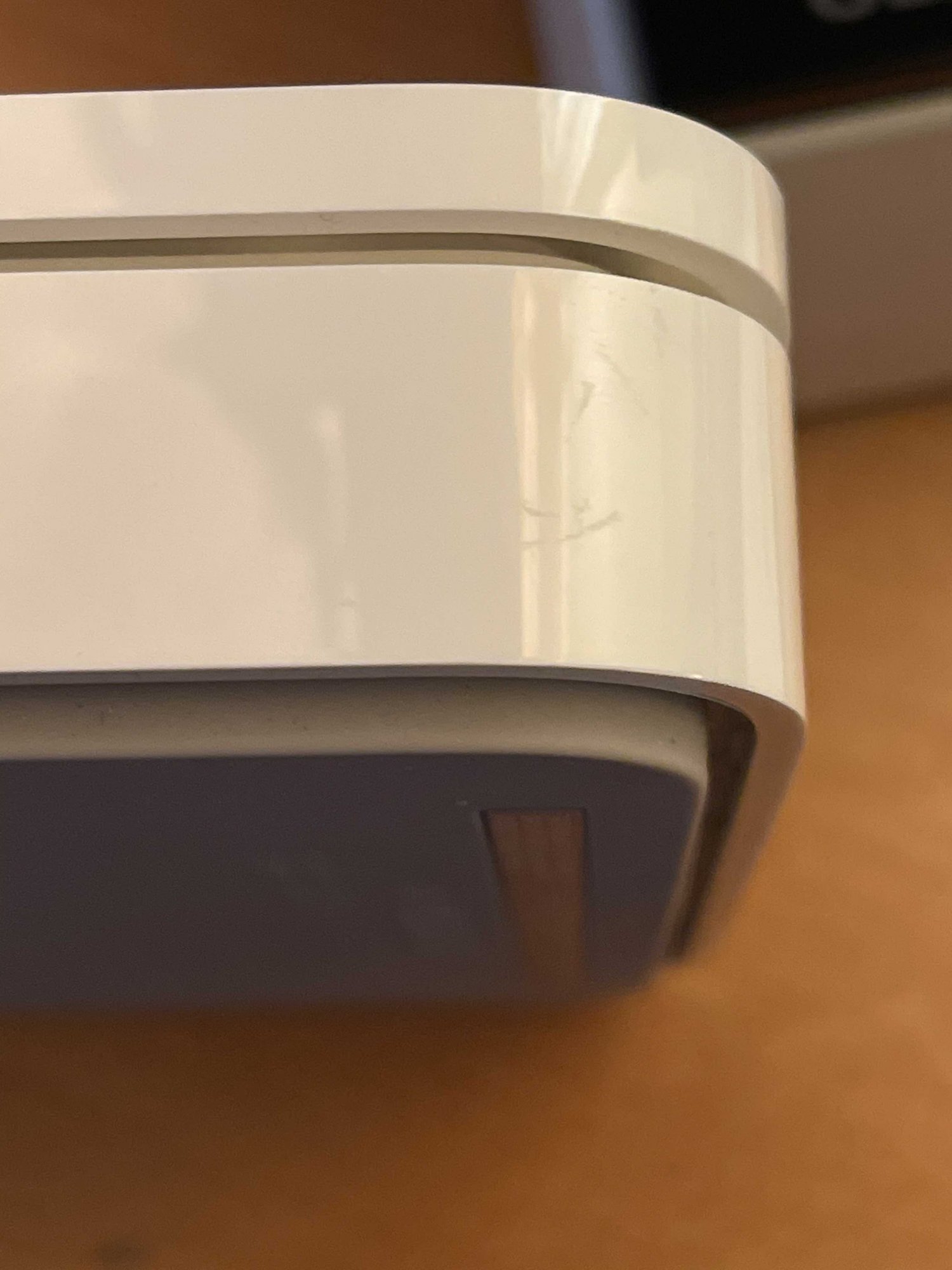

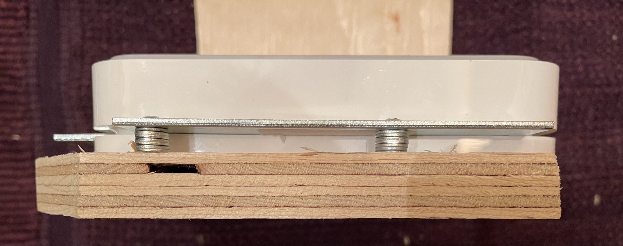

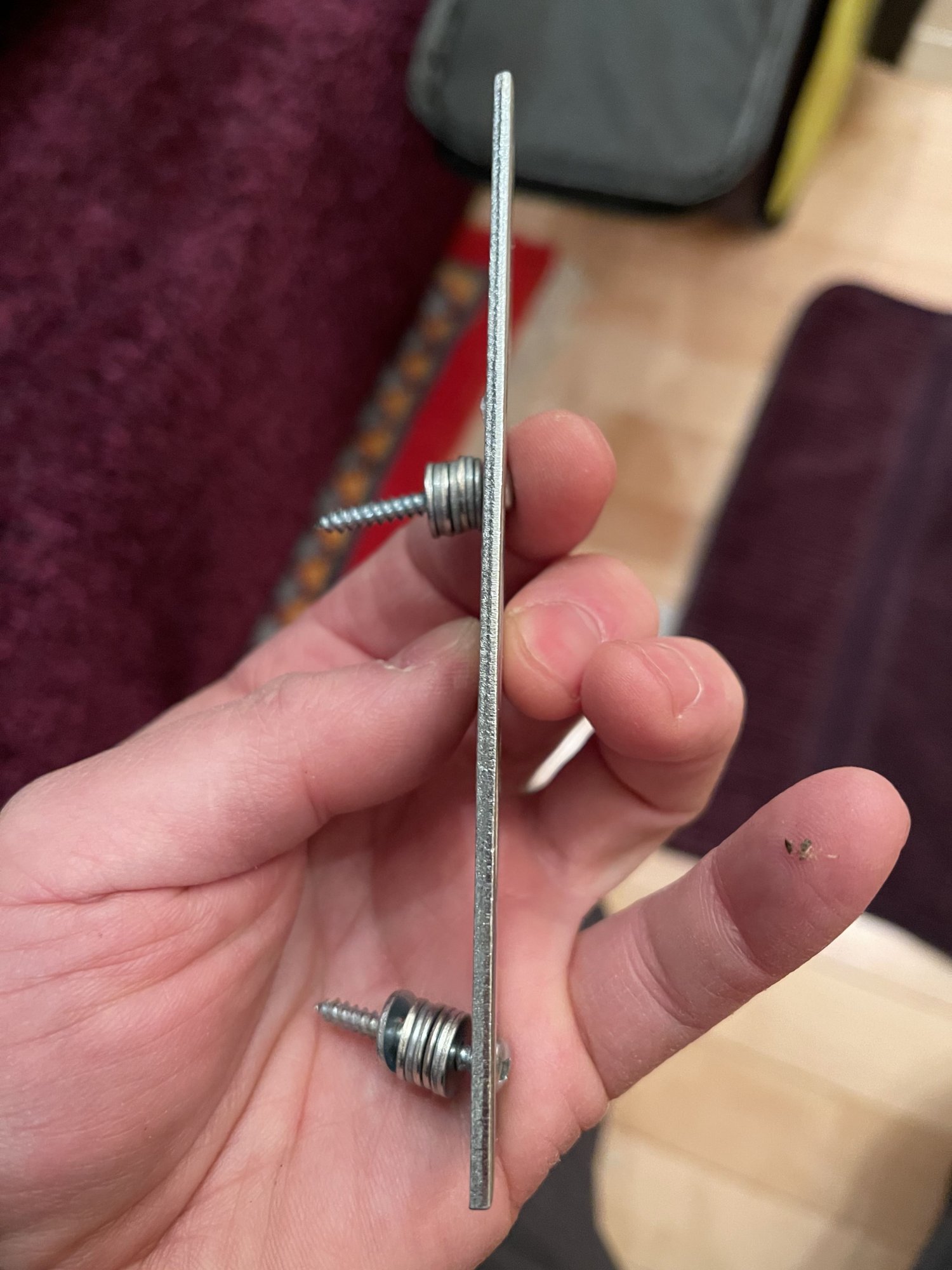

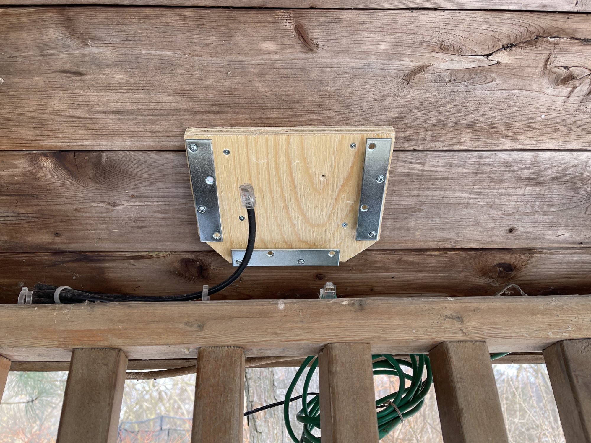

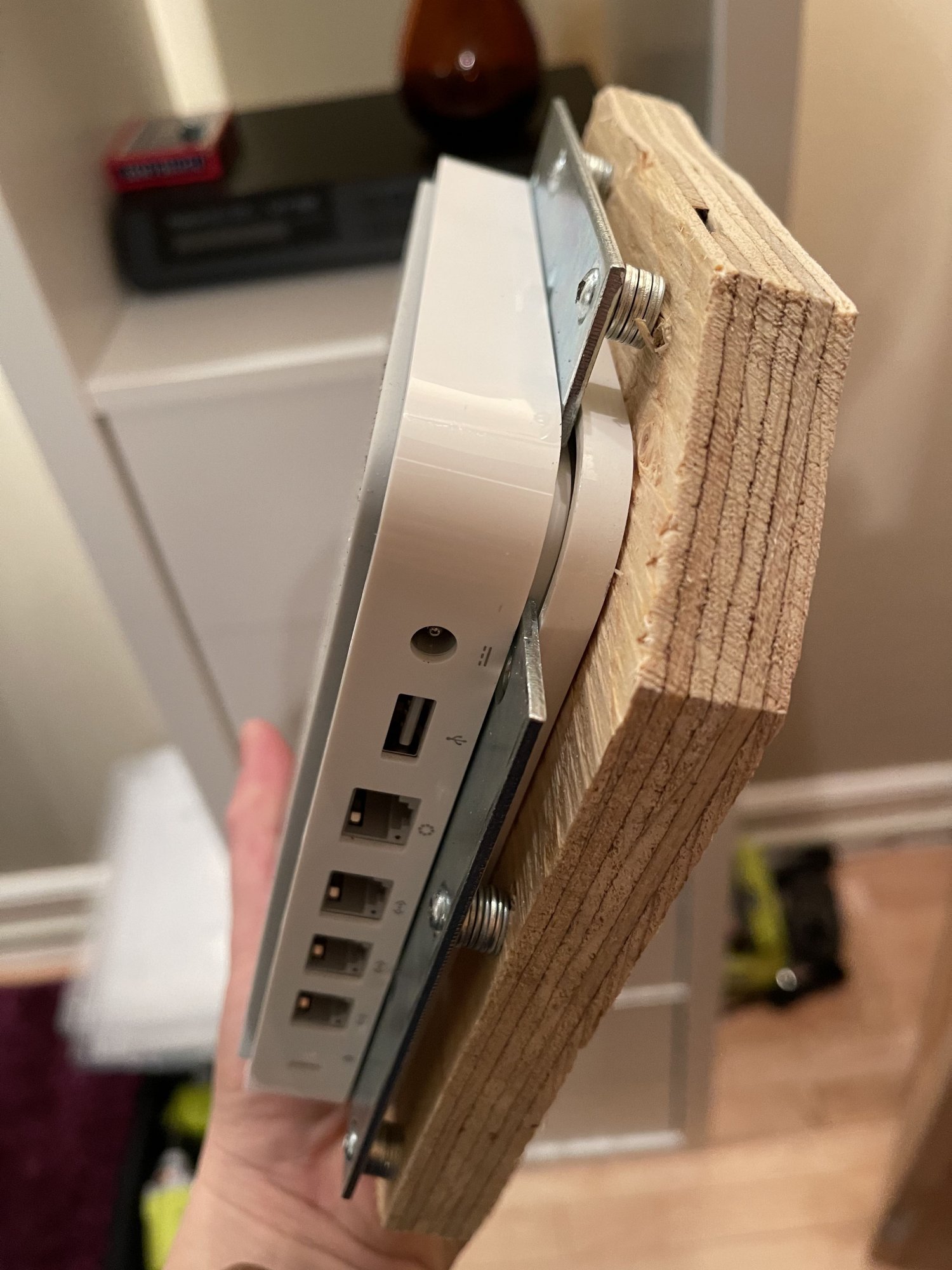

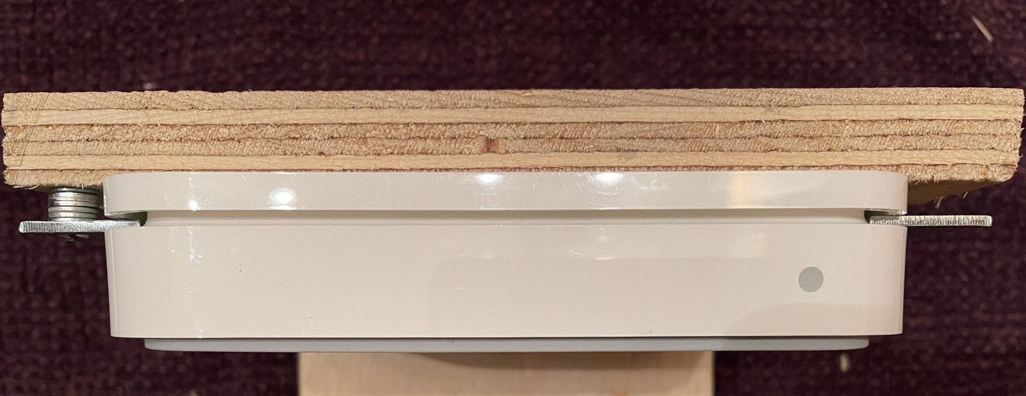

I was trying to figure out how to mount the AE using a box or shelf or hooks or straps, but then had a epiphany. I could mount it so that it's held up by its top cover, using some left over parts I had in my junk cupboard. The key were some flat brackets I had bought to fix my fence, which slide right into the ridge between the top cover main body, and I had exactly three left which worked out well. Here is the flat bracket on edge, along with screws with washers to act as standoffs.
These were mounted to a piece of wood at a height that would exactly match the ridge/slot in the AE.

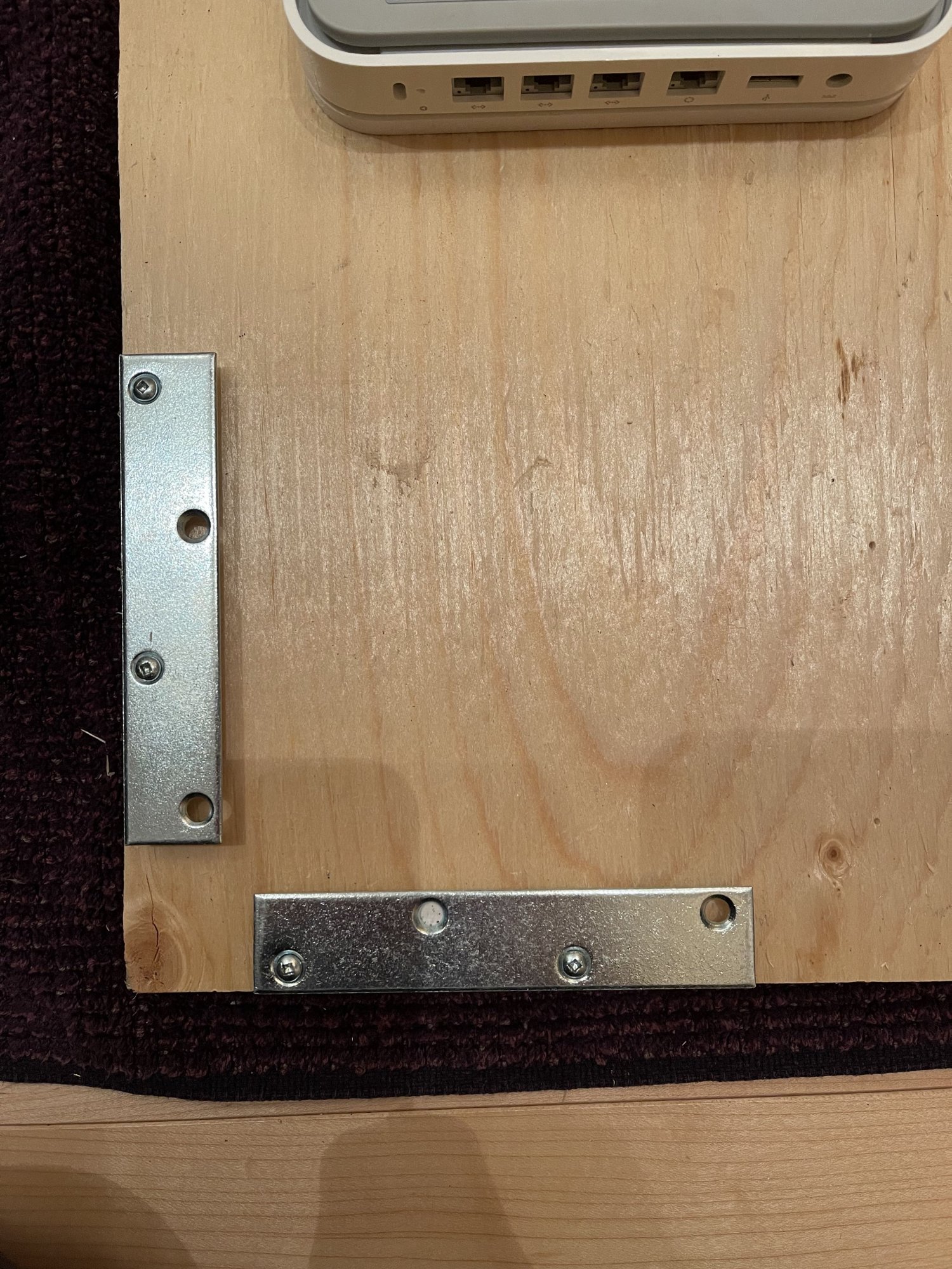

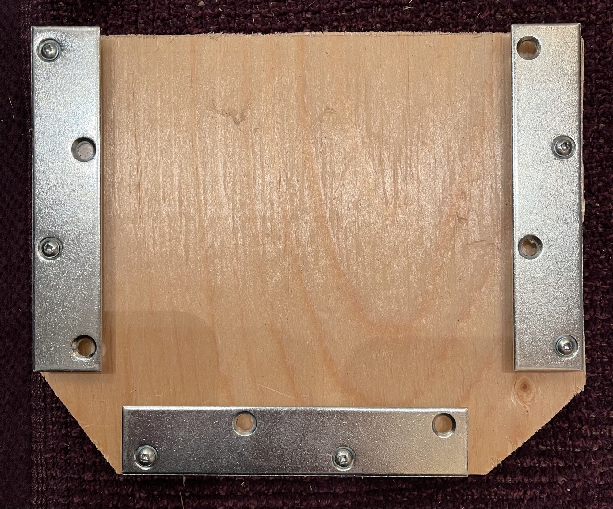

I installed one bracket, put the AE in place, and then used the AE as the guide to install the second bracket. And then with the two brackets installed, I put the AE in place again to install the third bracket, for an exact fit. No measuring needed.

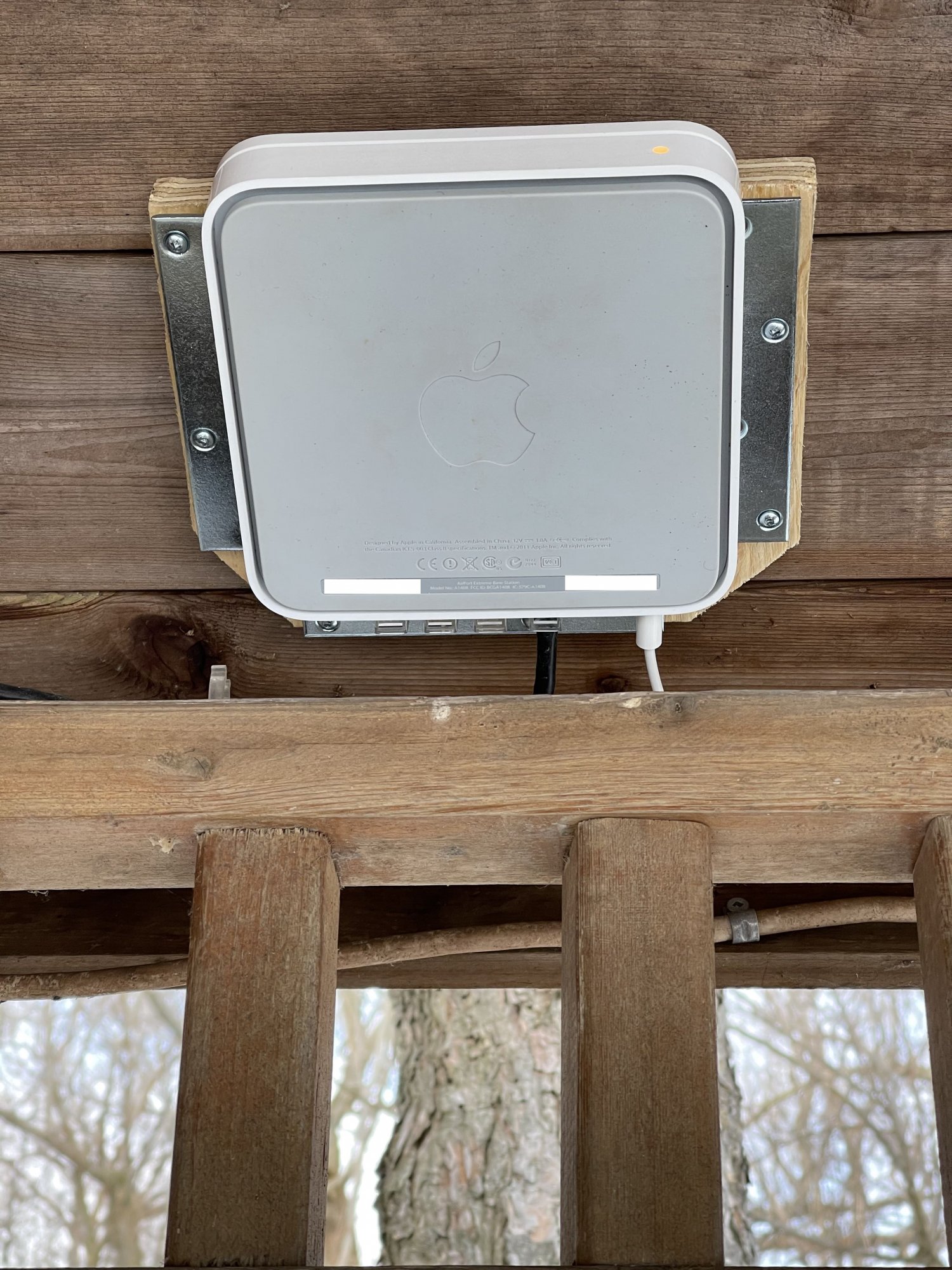

With this setup, the AE fits snugly but I can slide the AE in or out at will.
Also, mounted this way, the ports are not blocked.

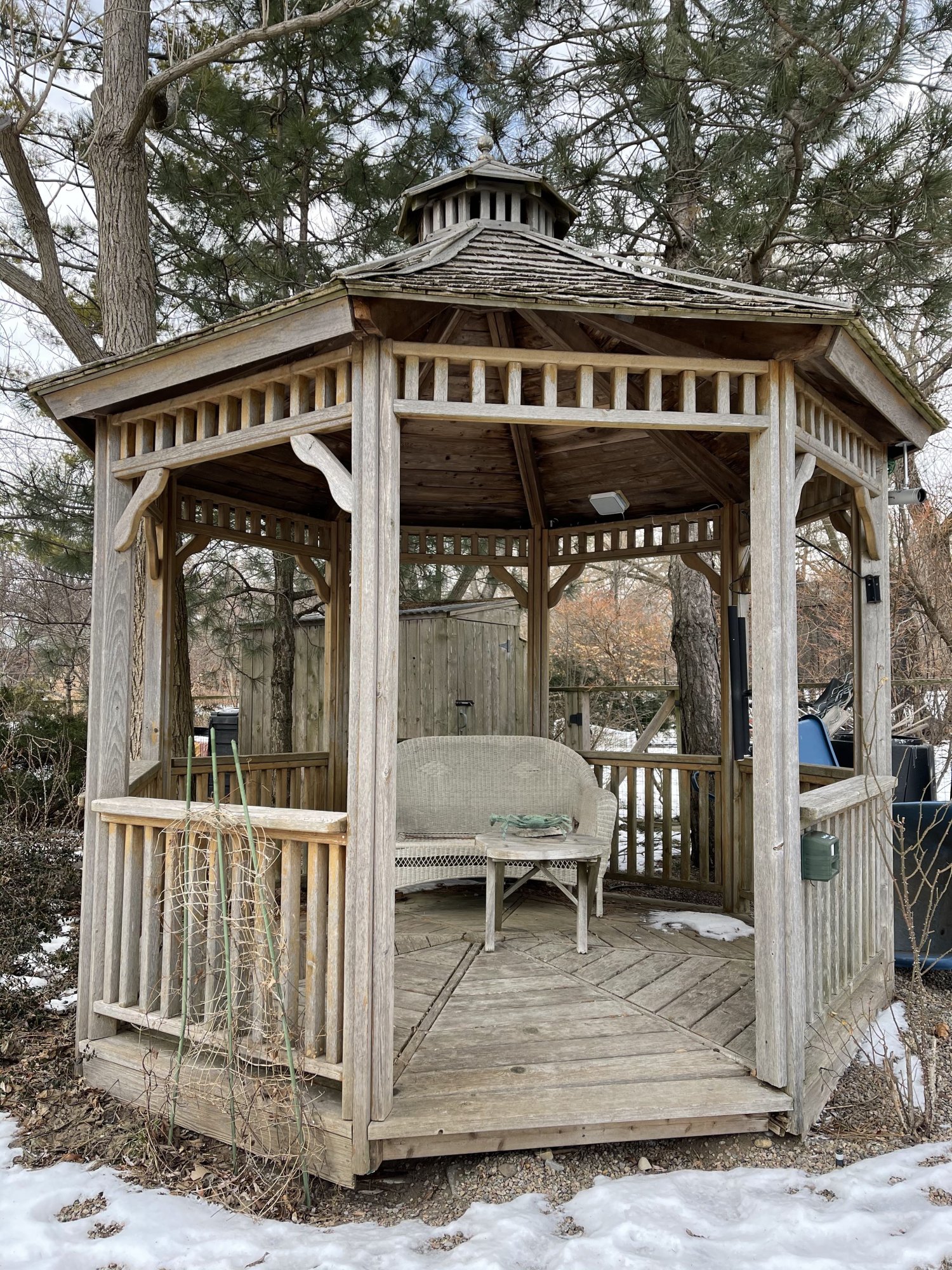

Installed in the gazebo:
Here is the completed result:
The mount is pretty rough around the edges, but the good news it's ultra strong and I suspect it will last a very long time, maybe longer than the gazebo itself.
BTW, it's about -6C (-21F) right now and the AE is working fine. This AE will eventually be encrusted with dead bugs and webs, so I'll probably pick up another one if I can find one cheap on eBay or Kijiji.
