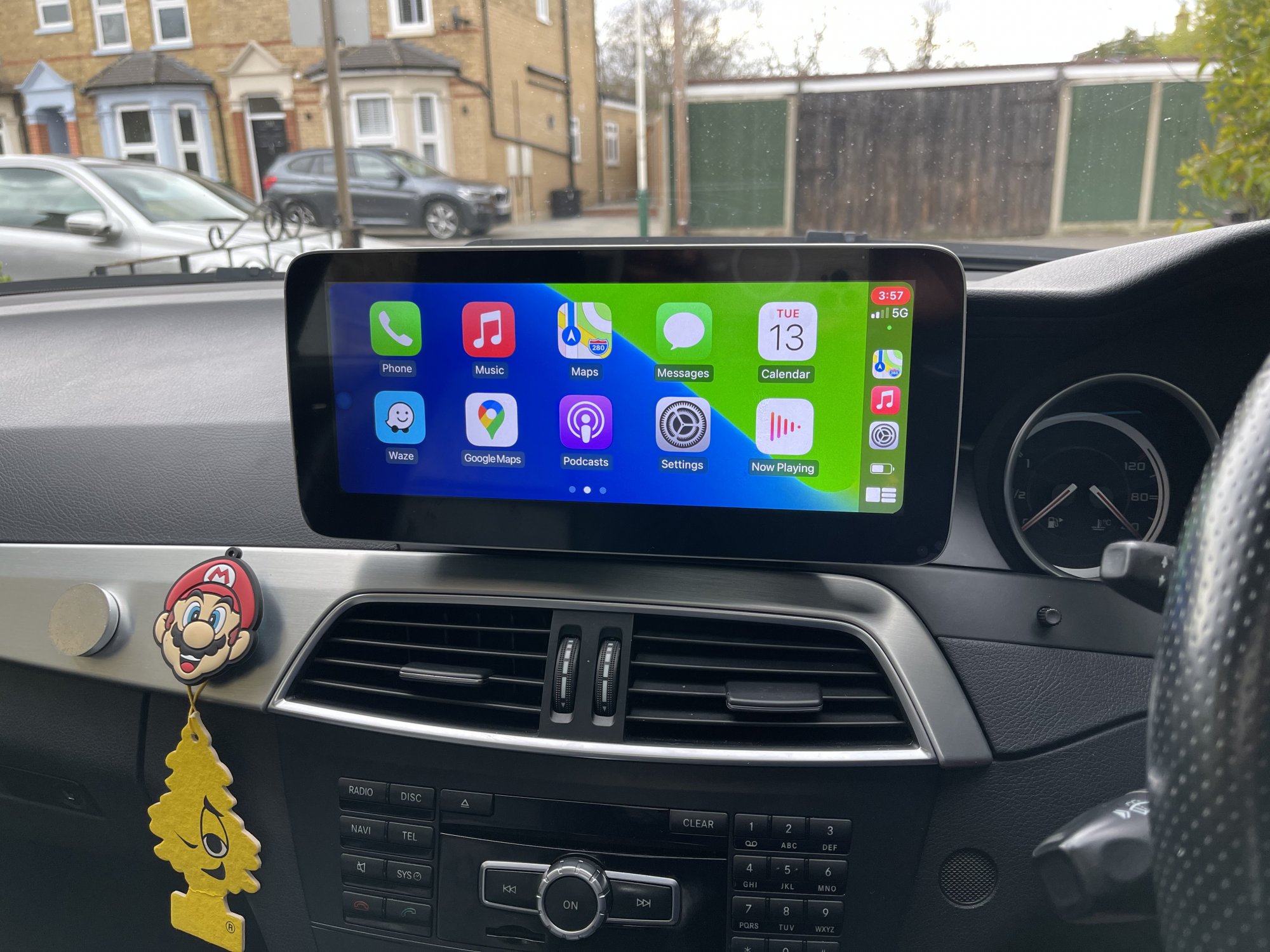

I have a 2011 Mercedes-Benz that had a system that was too old for CarPlay. So I replaced the factory entertainment system with a 10.25 inch Android screen/tablet made specifically for my car.
It’s a fixed screen, installed permanently on the dash and is connected internally to the ignition and car speakers.
The screen gives you all the apps that you can find on Android (YouTube etc) and has a very valuable app pre-installed called ‘Z-Link’. Z-Link gives me full wireless CarPlay. First I connect my iPhone to the screen via Bluetooth. Then I load up Z-Link. This then creates a wifi connection between the iPhone and the screen and CarPlay works wonderfully.
Even though I can use the screen as a full Android tablet, CarPlay is all I use. And all that’s practical to use while driving.
I bought the screen from AliExpress online and had it fitted by a car audio specialist near me. Cost around £500 total.
