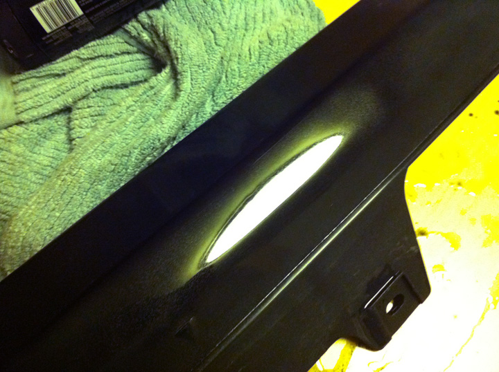

Seen a lot of threads of people wondering how to restore an iPhone so I decided to make a DIY guide
Also pretty helpful if you want to de-brand your iPhone 😛
Background
My previous iPhone was stolen at the gym, low on funds I decided to buy the cheapest iPhone I could find that worked regardless of condition. I found an iPhone 3G that had being completely abused and had a dark spot on the LCD. On the second picture notice the gouge on the right side, out of of all the blemishes it was the deepest) Still I ended up buying the phone for a really good price. The replacement parts from eBay only cost $16 for the glass and $23 for the LCD ( sanding kit $10) making it a price effective mod.
My first attempt at restoring it was a mild success, since I used mild sandpapers/rushed. But you can see that even with 800 grit sandpaper and about an hour I got it looking better, but it still had tons of deep dents and scratches.
What did you exactly do in your first attempt? You drysanded it and then polished it or there was no need to polish?? Im sorry but i really dont know much about dry/wetsanding.... i've always thought that sand paper actually scratches, rather than fix scratches.
Sandpaper does cause scracthes, but that's why wetsanding is a method. You initially sand away the original scratch. but this leaves you with scracthes, that you have to remove using finer and finer sandpaper.
first time around I only went down to 800 grit sandpaper, then went to 1000,1500,2000 and then polished it up. I didn't want to sand too deeply because I had heard that if you sand it down to far, you loose the apple logo, and the phone is easier to scratch.
As you can see it was shiny, but still had a ton of deep scracthes and defects
So after my first attempt, I went down to 320 grit and completely removed every single defect. I ended up removing all the anti scratch coating because some of the defects were very deep. then I polished it back up with 800, 1000, 1500,2000,2500, 3000 sandpaper and used polished it up.
hope that helps.

Yeah Alphadan, you don't have to go down to 320, but 3000 grit sandpaper will really not do much, since it doesn't have any cutting power. I would first try 2500 and see if that works, if not go down to 2000. 2000 grit should be good enough. Finding that first grit of sandpaper is tricky, but make sure to only use the most aggressive sandpaper needed, or else you are just making more work for yourself 😛
Oh sorry it was in my original post but I guess I should make it more clear ( i updated my DIY)
Step 1 (using the 3M kit on a power drill)
Polishing Pad = Orange 3m Pad
Polish = 3M rubbing compound
Step 2 ( using a rotary tool)
Polishing Pad = Blue 3M Pad
Polish = Meguair's 205
But like I said in my guide, you can just use 3m rubbing compound with a microfiber if you don't have a rotary tool.
Details for those who are interested
The 3m headlight kit already comes with an orange pad and 3m rubbing compound, but the orange pad ( cutting) and the polish ( rubbing compound) will leave what many detailers call "polishing halos". To remove the halos you have to
1) make sure all the scratches are gone (and just halo's are left), if not keep polishing with the orange pad
2) Polish with a fine microfiber + 3m rubbing compound.
The microfiber material is softer than the Orange 3M pad, and so it will not leave any halo's
I used a Makita Rotary tool with a Blue 3M pad as my second step using Meguiar's 205, because this is a much softer polish pad/polish and I know it doesn't leave any polishing halo's
I finished with NXT 2.0 wax.. only because I like how it smells, an adds a bit of shine ( that really only lasted 5 minutes of handling 😛 )
