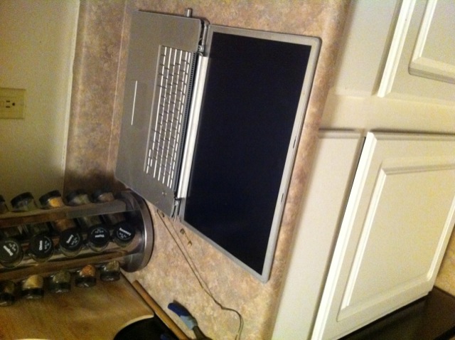

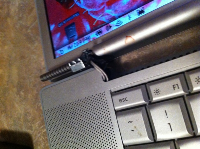

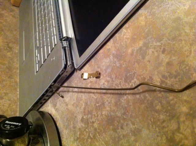

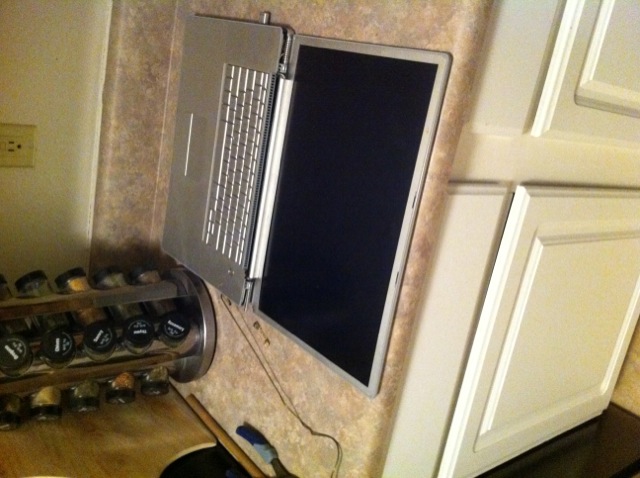

Hello! I am new here but I am undertaking a DIY Project with my old PowerBook G4 17in. I pretty much dismantled the display from the body. It was all looking good until I went to mount it under my cabinet.
I was holding the two seperate pieces ( I know, but I was in a hurry!) and I kept moving them around. Eventually the screen flickered and then went dark.😡
I know the screen is still getting the video feed, and I can remote desktop into it. If I hold a light up to the screen I can see the desktop.
Should I look at the inverter board, cables, logic board, or bulb? Thanks!

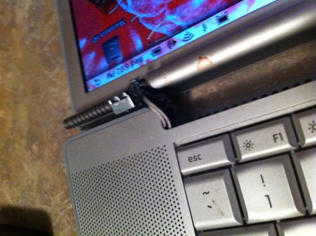

Check the inverter board and check all the cables. Sounds like they got pinched and are shorting out somewhere.

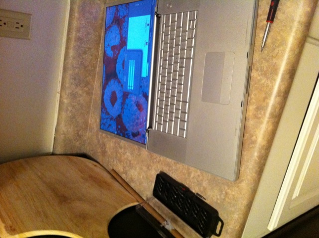

Throw up some pics of your DIY project too. That's a pretty cool idea though. Do you have to rotate 180* the screen display if you mount it underneath the cabinet since it's upside down?

i have looked at everything I can see and dont see anything that jumps out at me. I dont know much about the board, but I cant see anything burnt.
I got a old IBM Laptop off Freecycle and I was going to try to see if the inverter board will even light up the screen, bad idea?

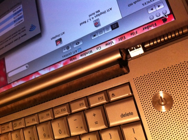

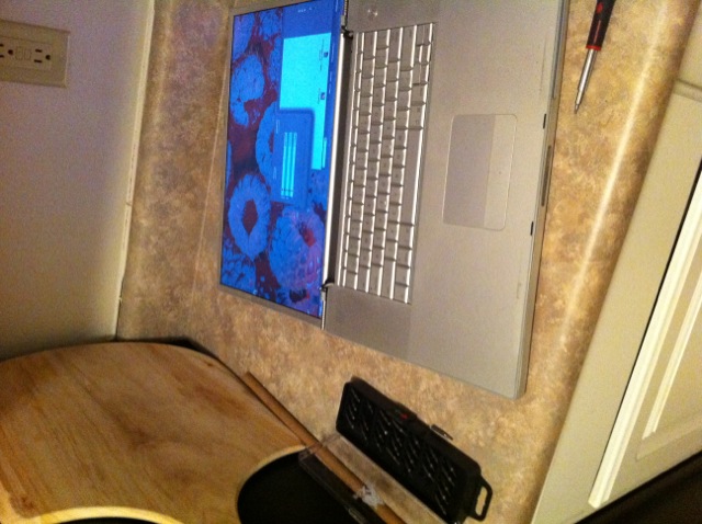

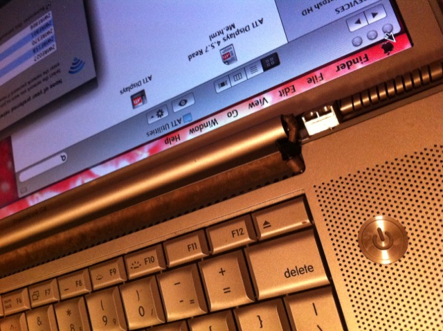

Rotate
Also, yes this was a pain for some reason. My PB would not show the option to rotate in the Pref Pane, so I had to find the ATI software to do it. Once installed, it worked well.
