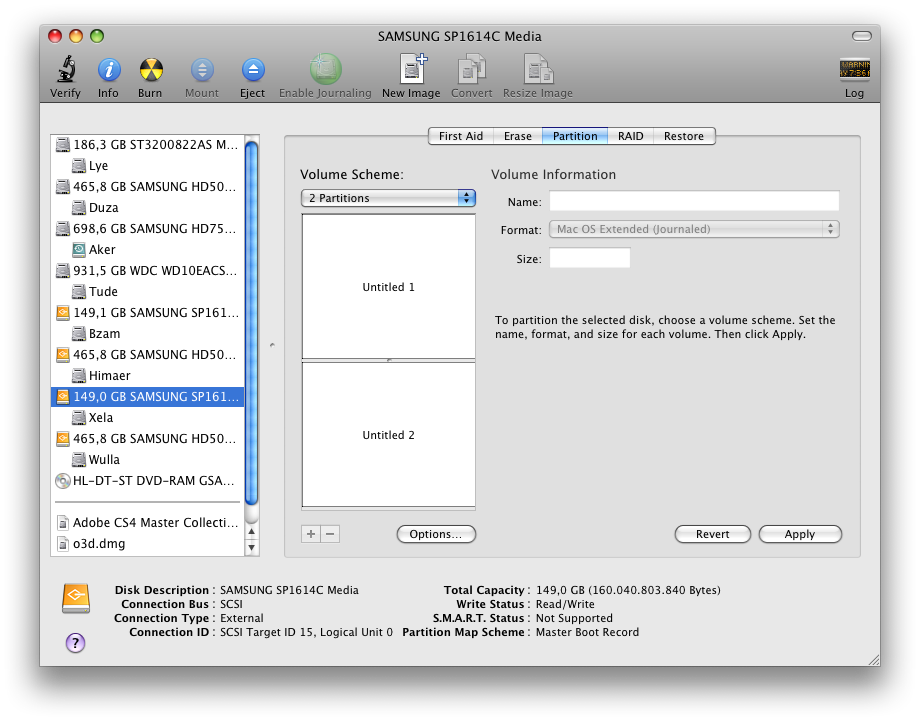

Thanks for the Raid Breakdown. I am going to use your Formula for sure. It makes sense. What would I do with the 2TB? Just leave it off the Raid 0 regular HFS formatting, correct? Since it won't be part of the raid 0 set.
Use ...
... Apples "Disk Utility" to format all drives with "HFS extended journaled". The same applies to partitions. When you create any RAID, it will have one single file structure - with OSX always use "HFS extended (journaled)".
OSX itself uses virtual memory- as much as Windows does - and the boot drive is the location for those hidden swap files. Let´s say you extensively use Photoshop and it would use the boot drive, too, for caching files; same goes for Final Cut or any high I/O demand. By just using the boot drive you now have the harddrive jumping around to read/write all those cached files. Caching is always done, when physical memory no longer is enough or files are too huge.
By separating it, ergo letting the system have one spot to put them on, and applications another one - you even might let each application have one on its own, e.g.: For photoshop a fast, but small Sata SSD (flash) could be used. Same goes for Final Cut Pro. If I/O demand is high, you start using schemes like RAID 0 to even further prolong this for more throughput (does not significantly speed up access times, but read/write throughput; for fast access times you need fast discs; the best option for this is SSD - but expensive).
You can create partitions as much as you like, though, but I would recommend to keep the structure clean: Clear names for harddrives and one physical harddrive is one named partition; create partitions only where necessary (separate boot volume, cache volume), for sorting and organizing use folders on the harddrive, NOT partitions. See it this way: Soon you will find lots of harddrives on your desktop. Creating lots of additional partitions makes it stuffed with disc icons. Keep it tidy.
Don´t use the 2TB option for any RAID, just use it as plain data disc - no stressful I/O racings. Maybe you could for the moment leave the RAID 0 off your harddrives altogether. Come back to it, when you really need it. Just use separate drives, do start working, then look out for I/O problems. I doubt you will have them for what you plan to do. For this, of course you should be more specific about your exact workload.
I, e.g. have one 200GB boot drive, another two 160GB cache drives, each for my virtual machine images and my Logic/Photoshop projects, then several data drives up to 1TB. My budget is limited, therefore old technology is still in use, but never mind: Even by just choosing different drives for caching you can speed up your machine quite significantly. The I/O is the real bootleneck today, and harddiscs are becoming slow compared to SSD for those tasks (different RAID schemes are the history of getting rid of those bottlenecks, but with enormous costs of controllers and connecting infrastructure, high performance drives etc.pp.). Nowadays it seems to be almost commoditiy, but don´t get fooled: RAID always is only the best possible compromise tailored for specific tasks. Only use it, when in need for it.
