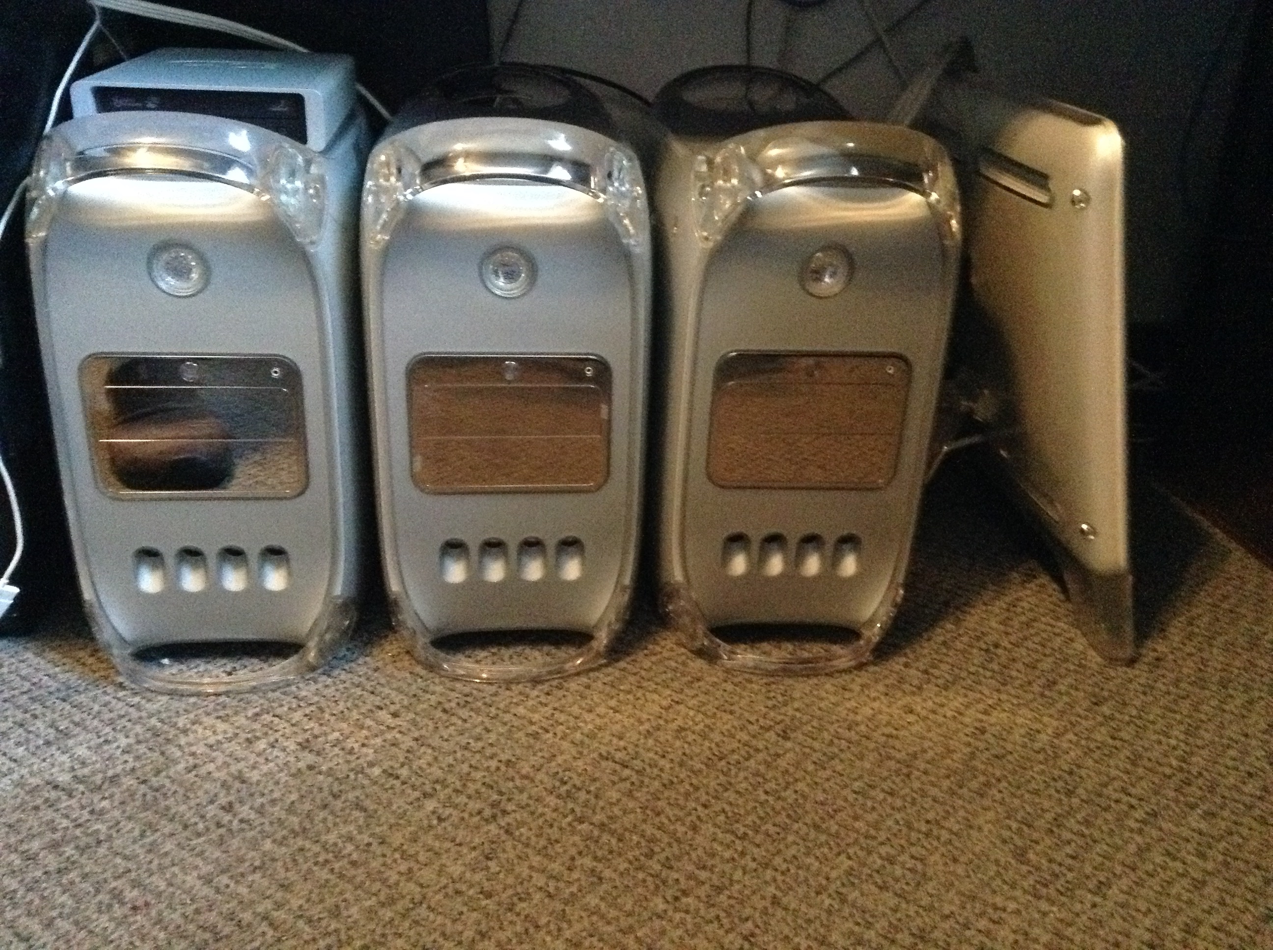

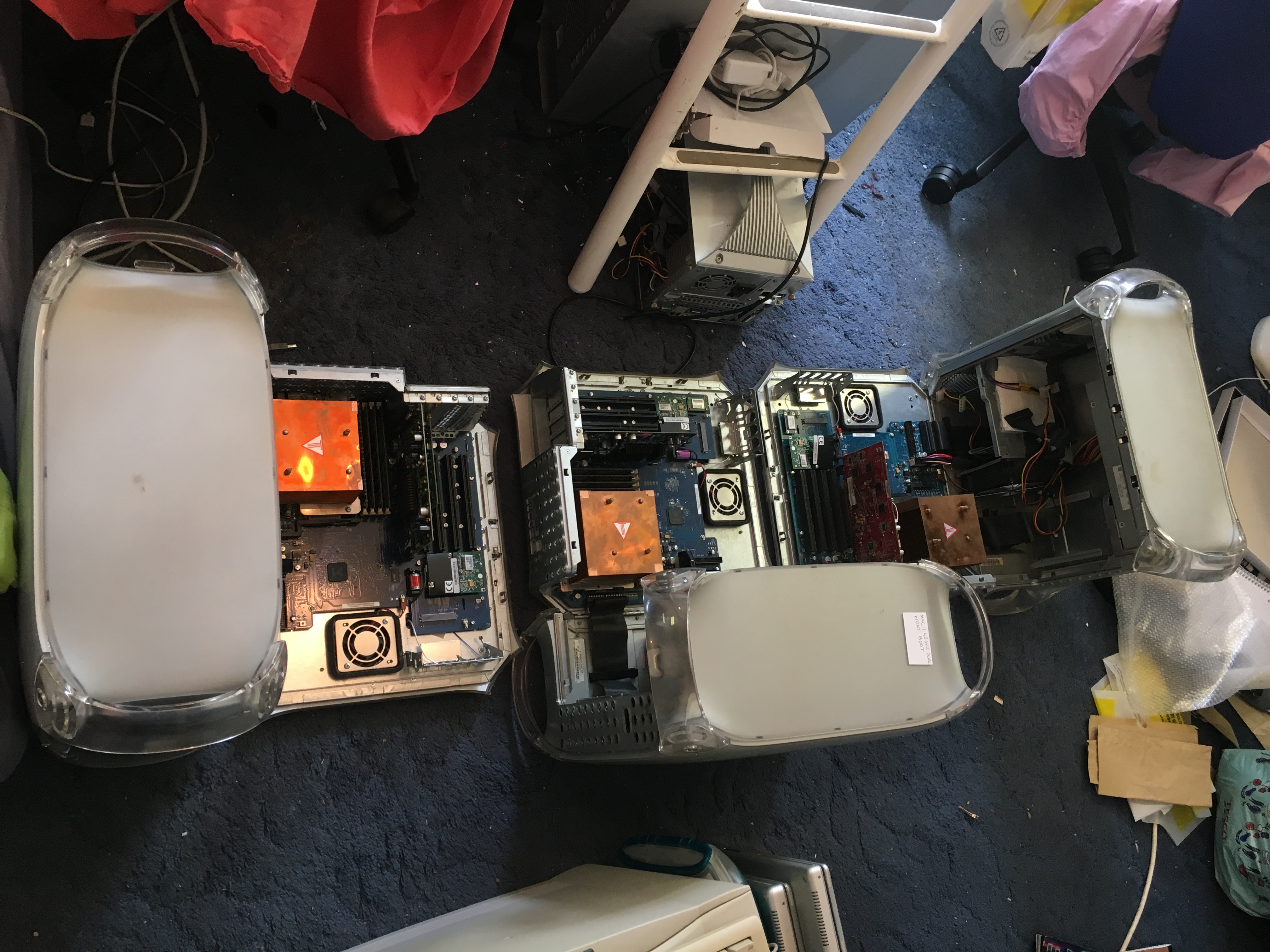

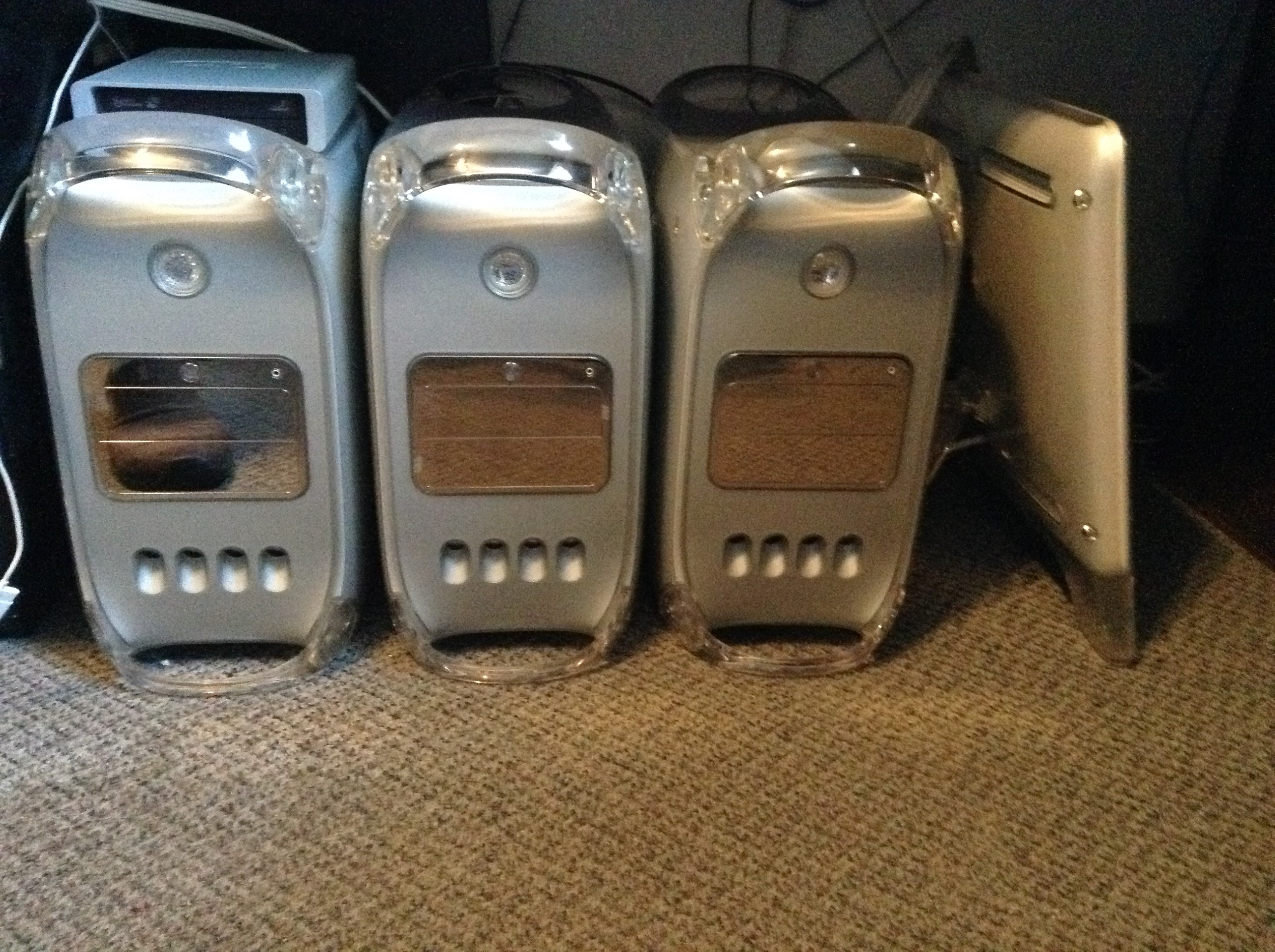

now no build thread would be complete without Pictures (please excuse the scruffy carpet 😀 the one closest to the camera is the working one the middle one is the one with the dead PSU and the one farthest away missing the ODD cage is my original/first 1.42Ghz MDD )

Haha 😀 I have a few of my Macs lined up like under my Desks, i even have a 23 inch acrylic cinema display tucked away like that too 🙂 (are those all 1.42s as well?)

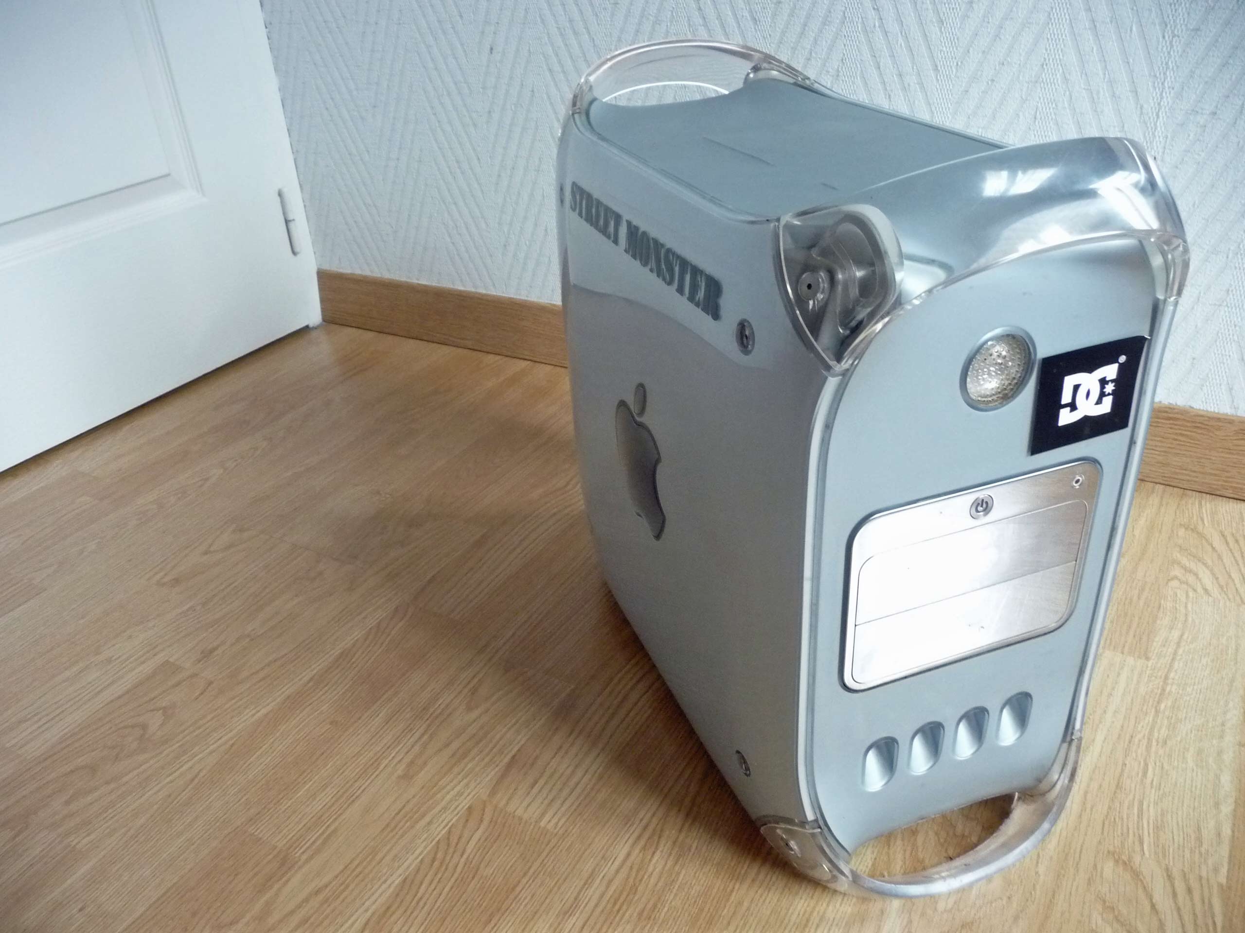

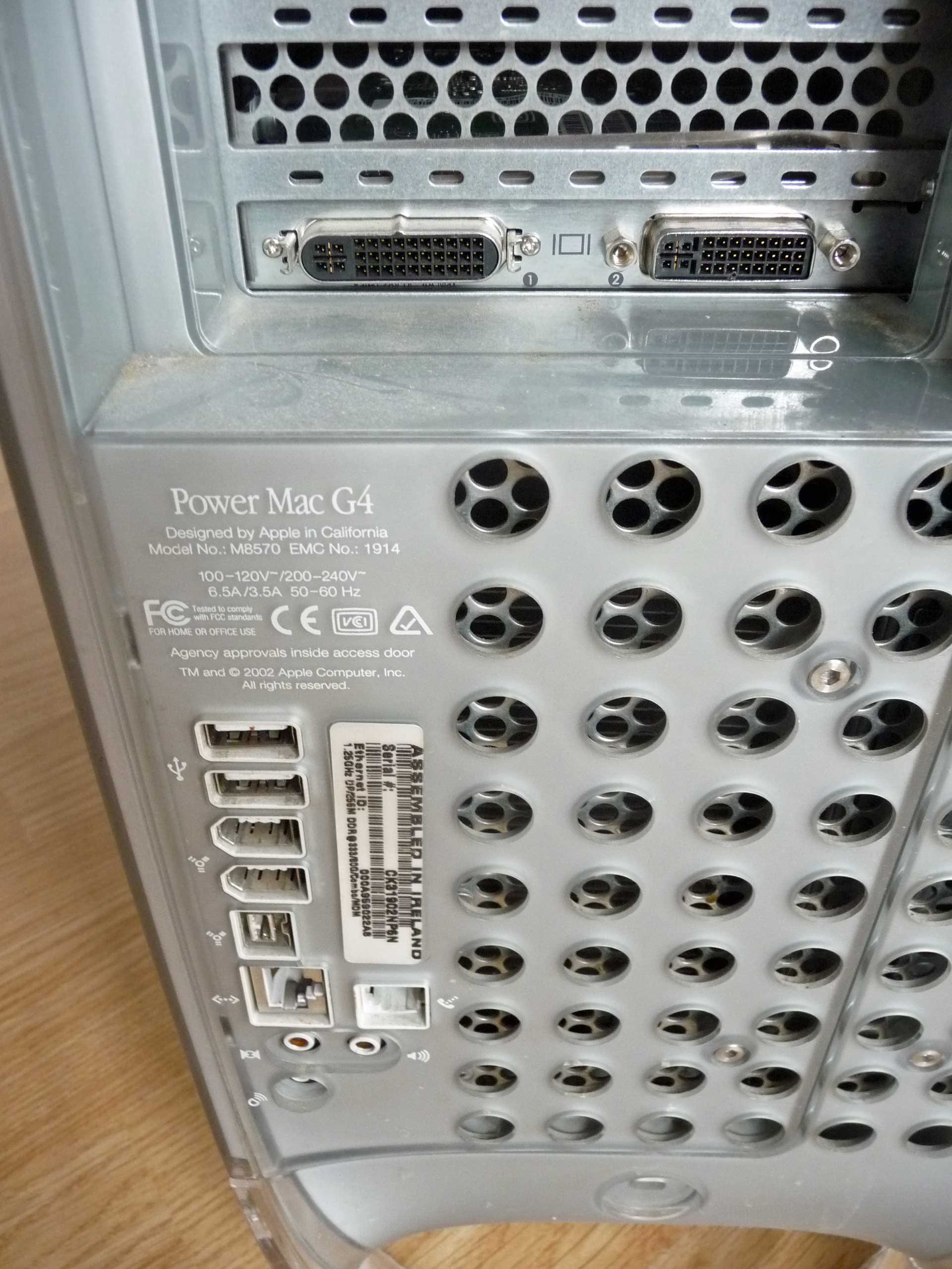

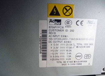

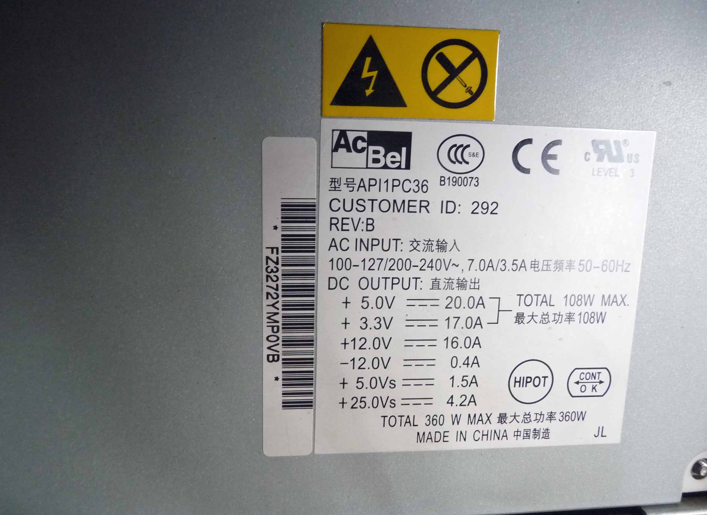

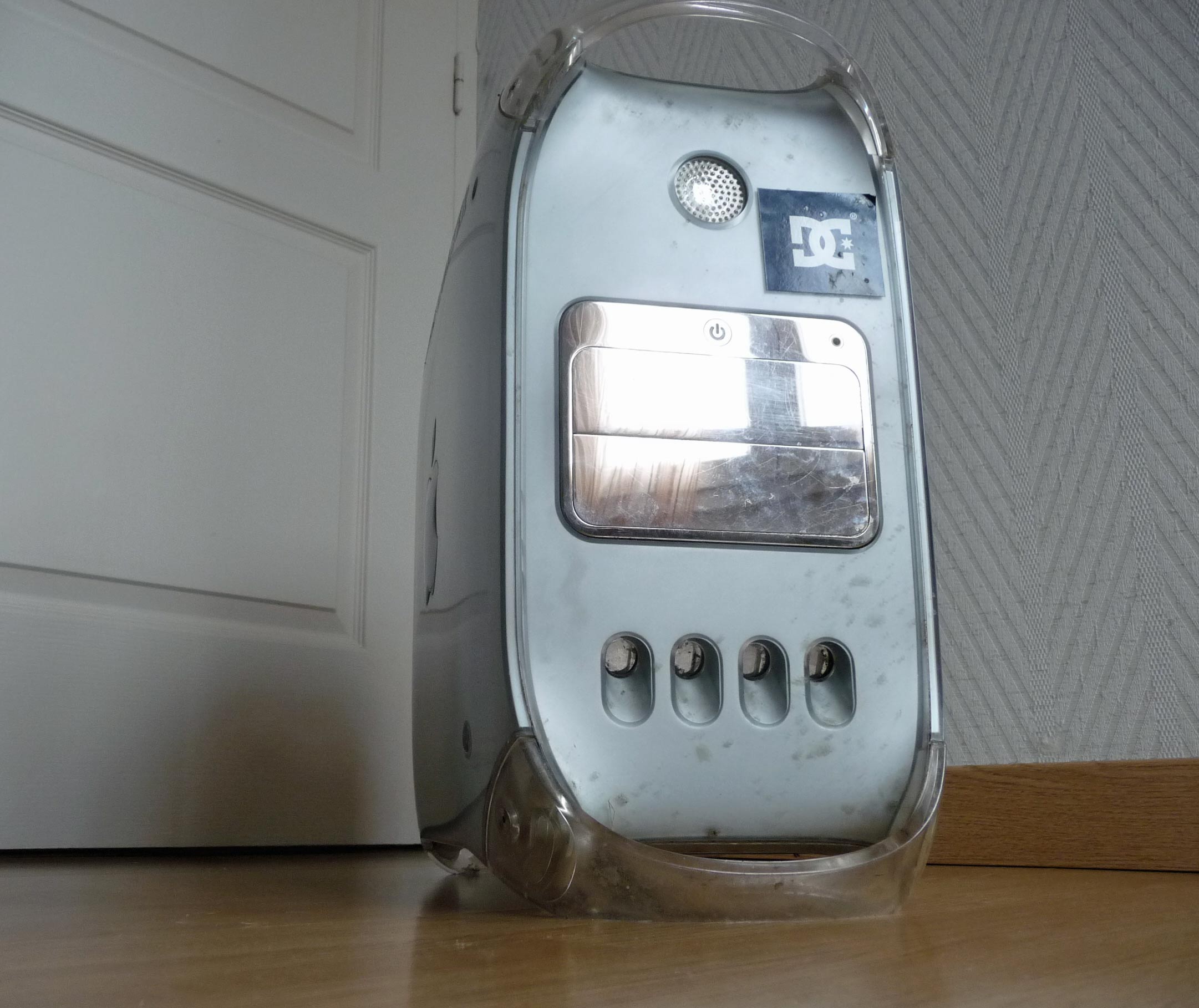

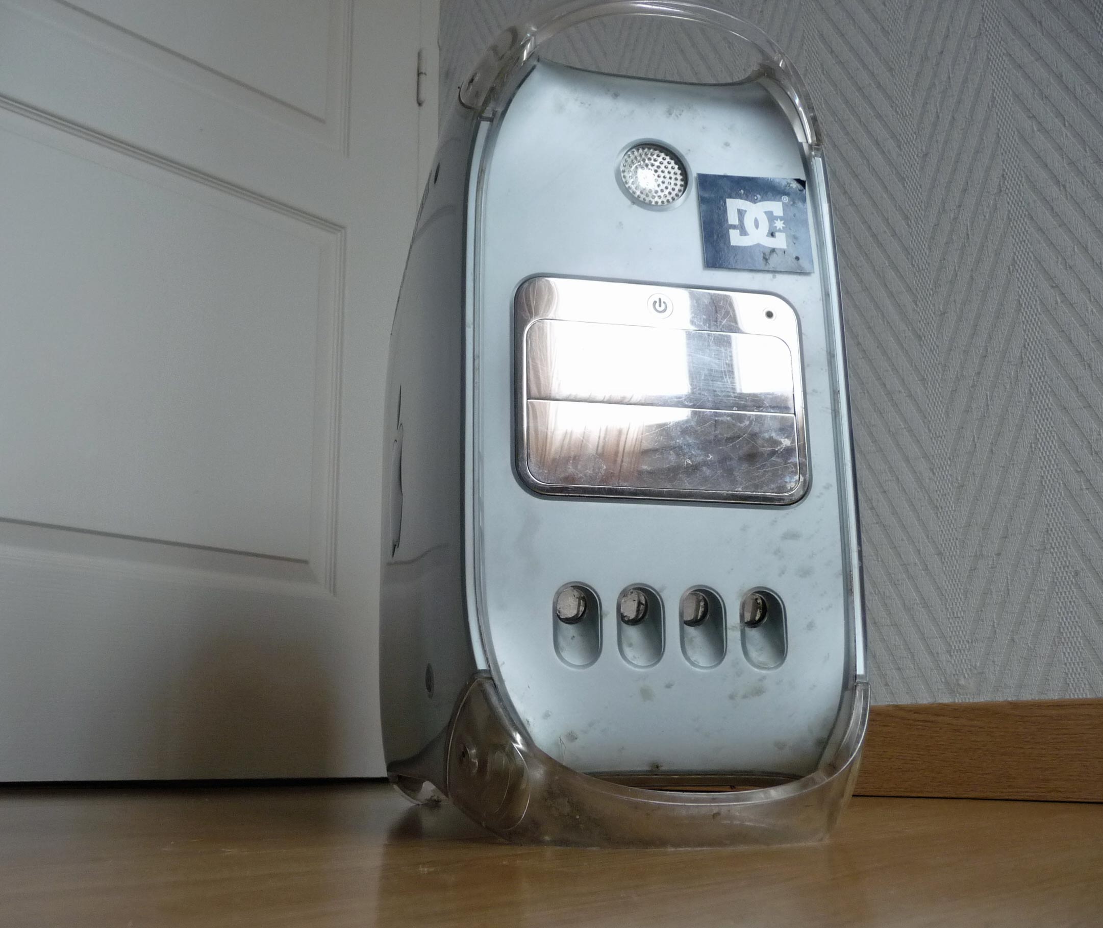

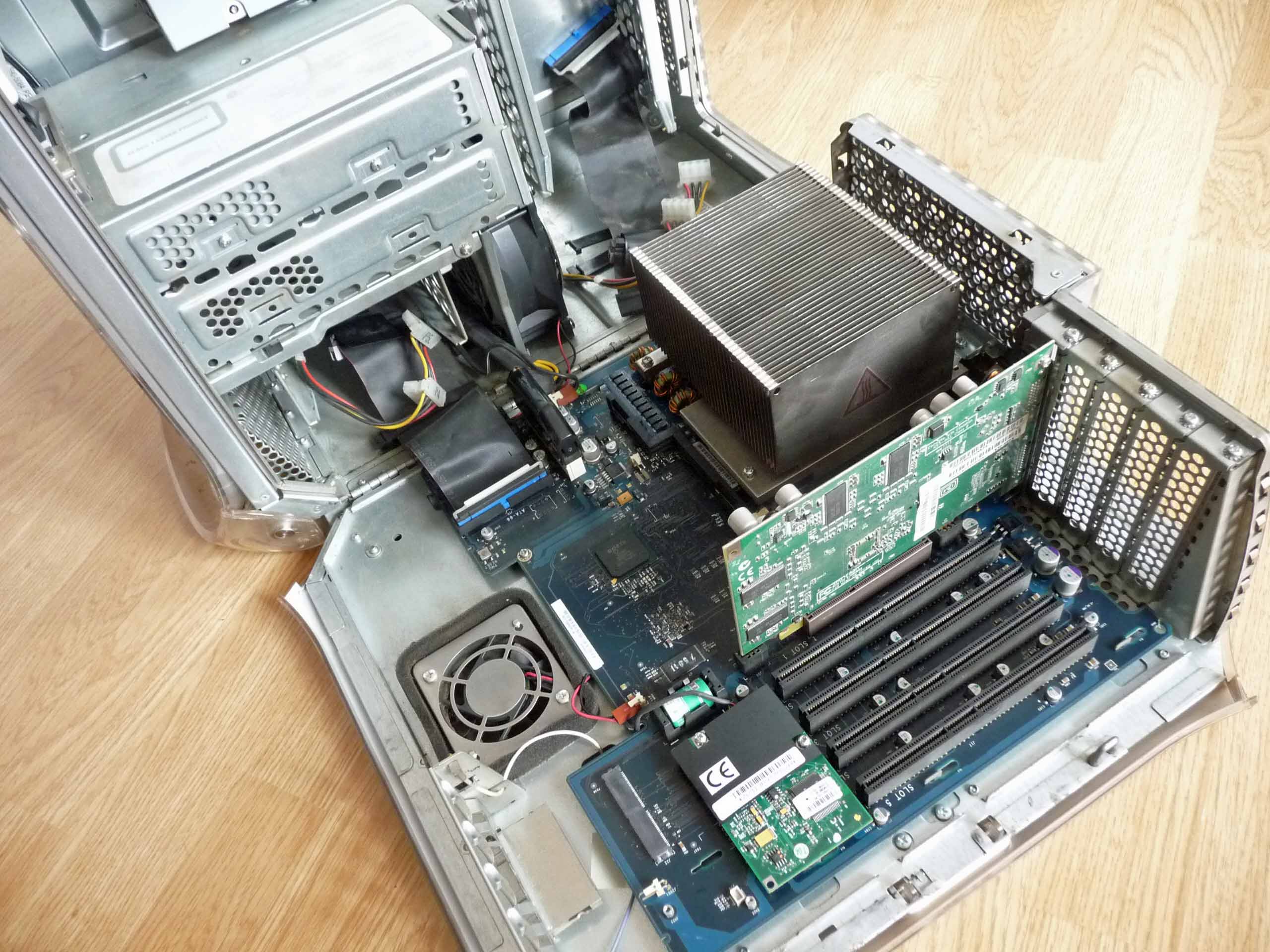

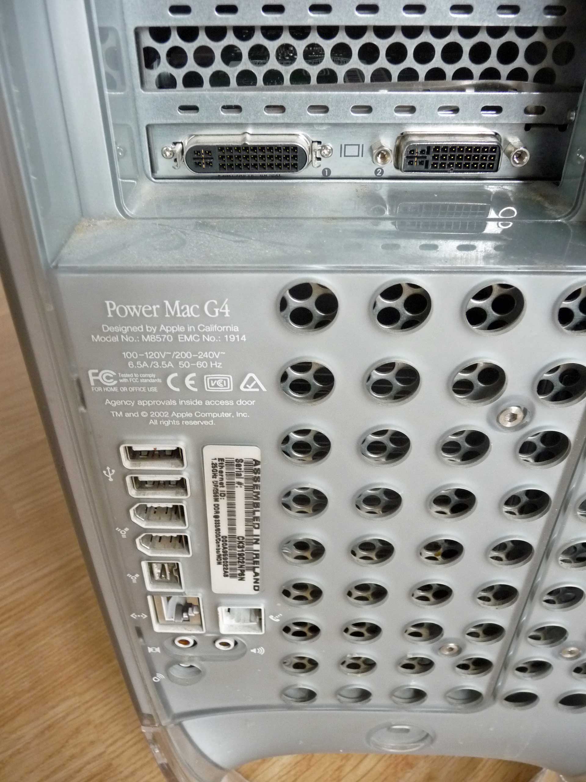

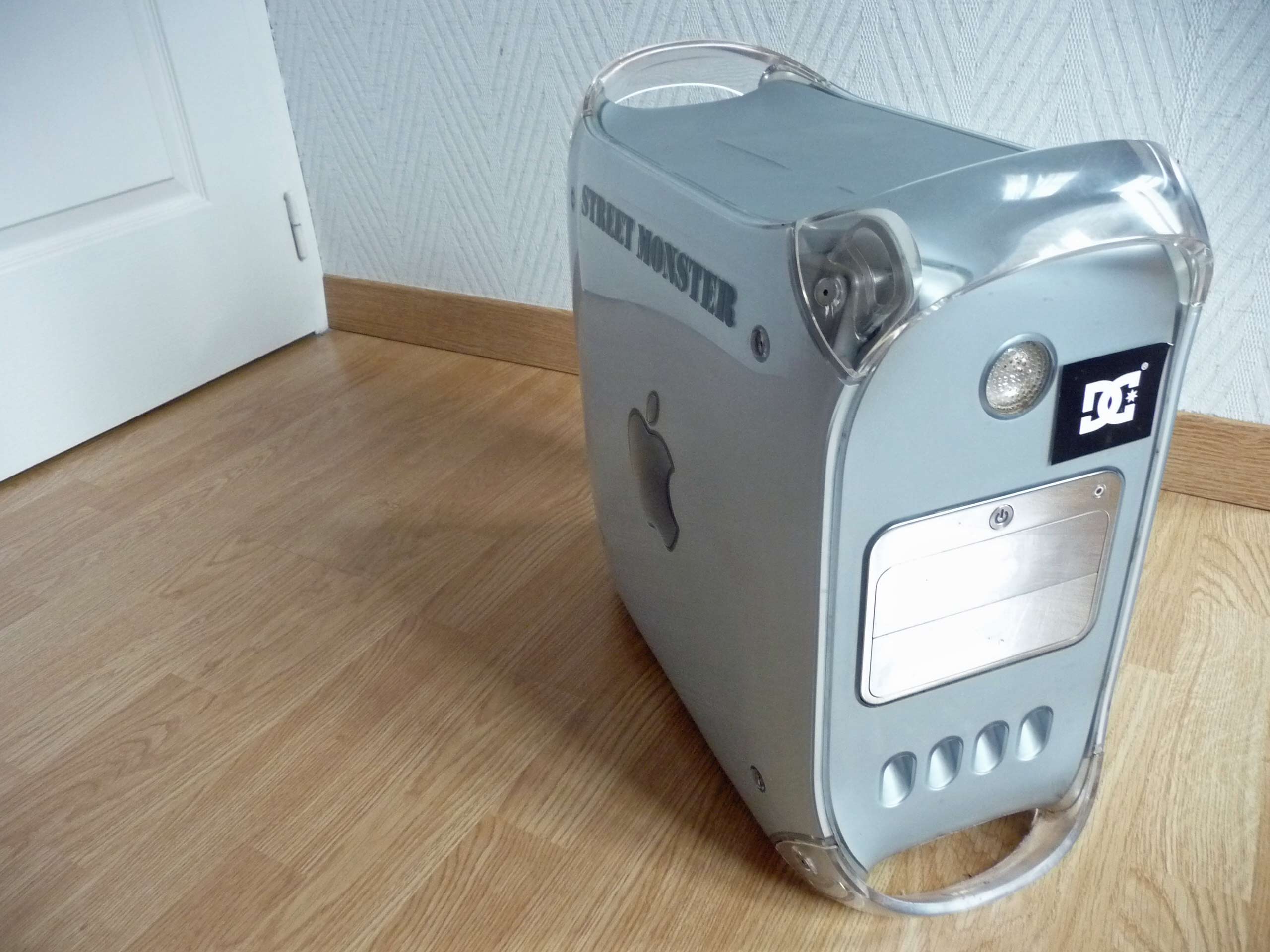

I too picked up one for the equivalent of few dollars last saturday at a thrift store. It's a place I try to look in at once a week, and when I walk over to the 'electronics' section, I've heard more than once the over-estimated statement, "Ah c'est le gars du Mac" (it's the Mac guy!), as I always ask if they have anything related. Unfortunately they rarely have. Last week was an exception, and I was told they'd put something aside for me, as nobody else was interested in a non-functional MDD. To be honest, I wasn't either, but they wanted to clear it out for lack of space (and interest), and when told the price, I opened the case to check the contents. Two HD's, one 13GB Maxtor dated 25/9/99, and an 80GB Barracuda, ODD, and 1.25GB RAM, and what looks like a Radeon 9000 graphics card. So I have more than my money's worth in accessories alone.

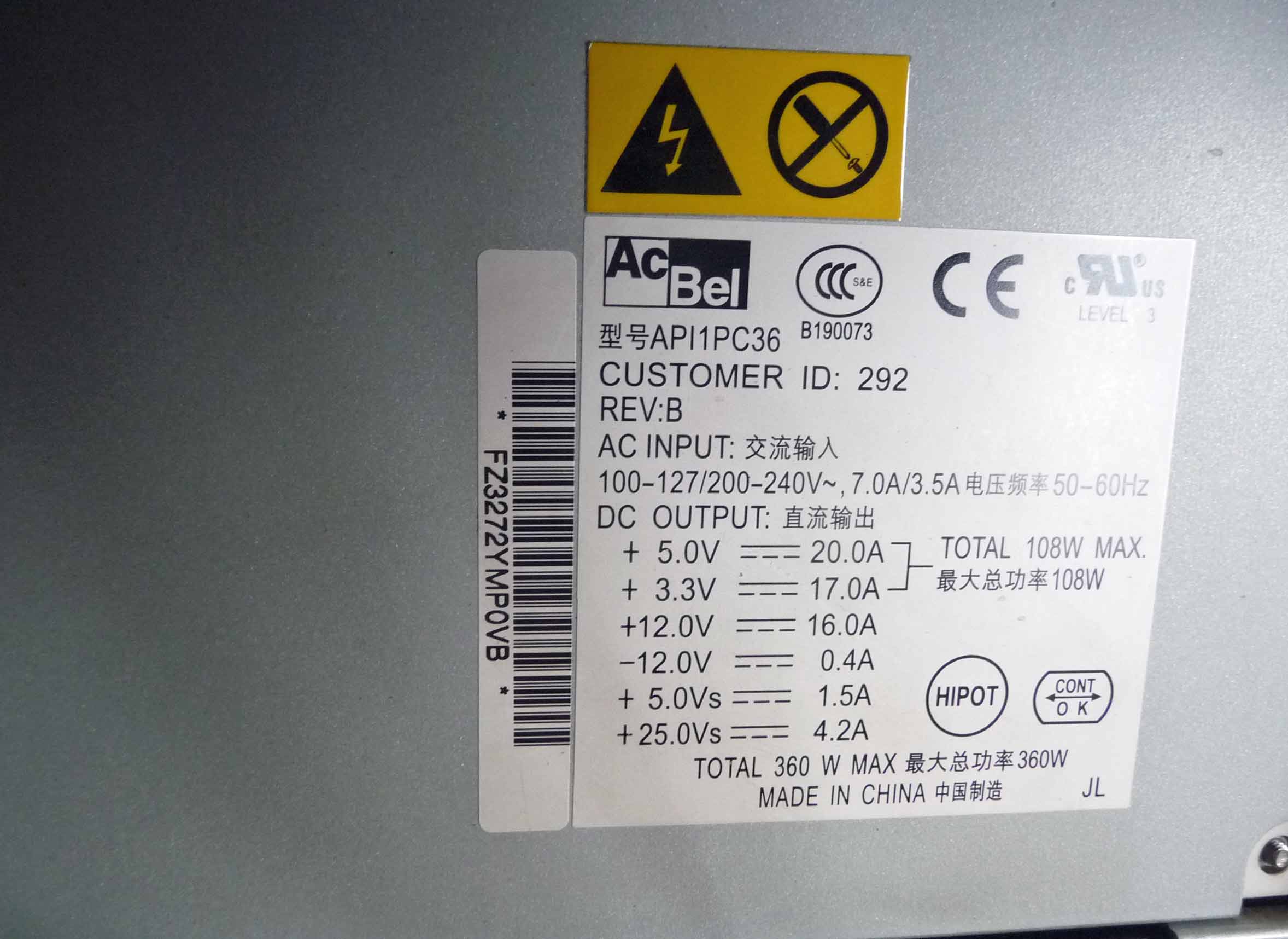

It's a 1.25GHz model, and I confirmed it didn't power-up. Not a sound, or glimmer of a light anywhere. The power button has a 'dead' feel, no apparent movement in it, or any feel of a spring or contact beneath, as I'm used to on a Quicksilver. Is there a known problem with the power switch? I understand some PSU's were known to be defective, and I've already bookmarked a site to troubleshoot the PMU. I'll start however by resetting the logic board, changing the PRAM battery and go from there.

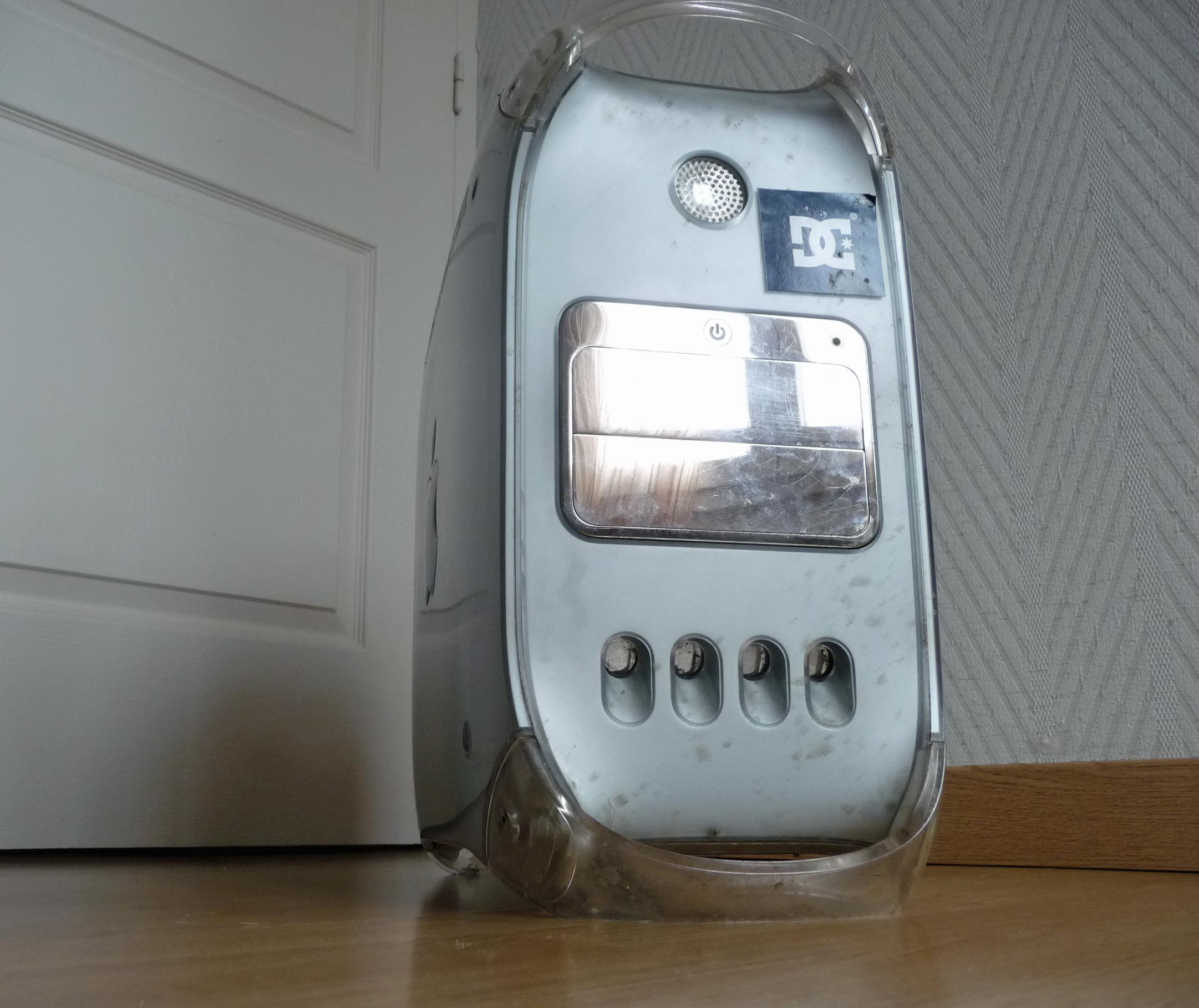

As received. "Hi, I'm grubby!"
After a 15min clean.

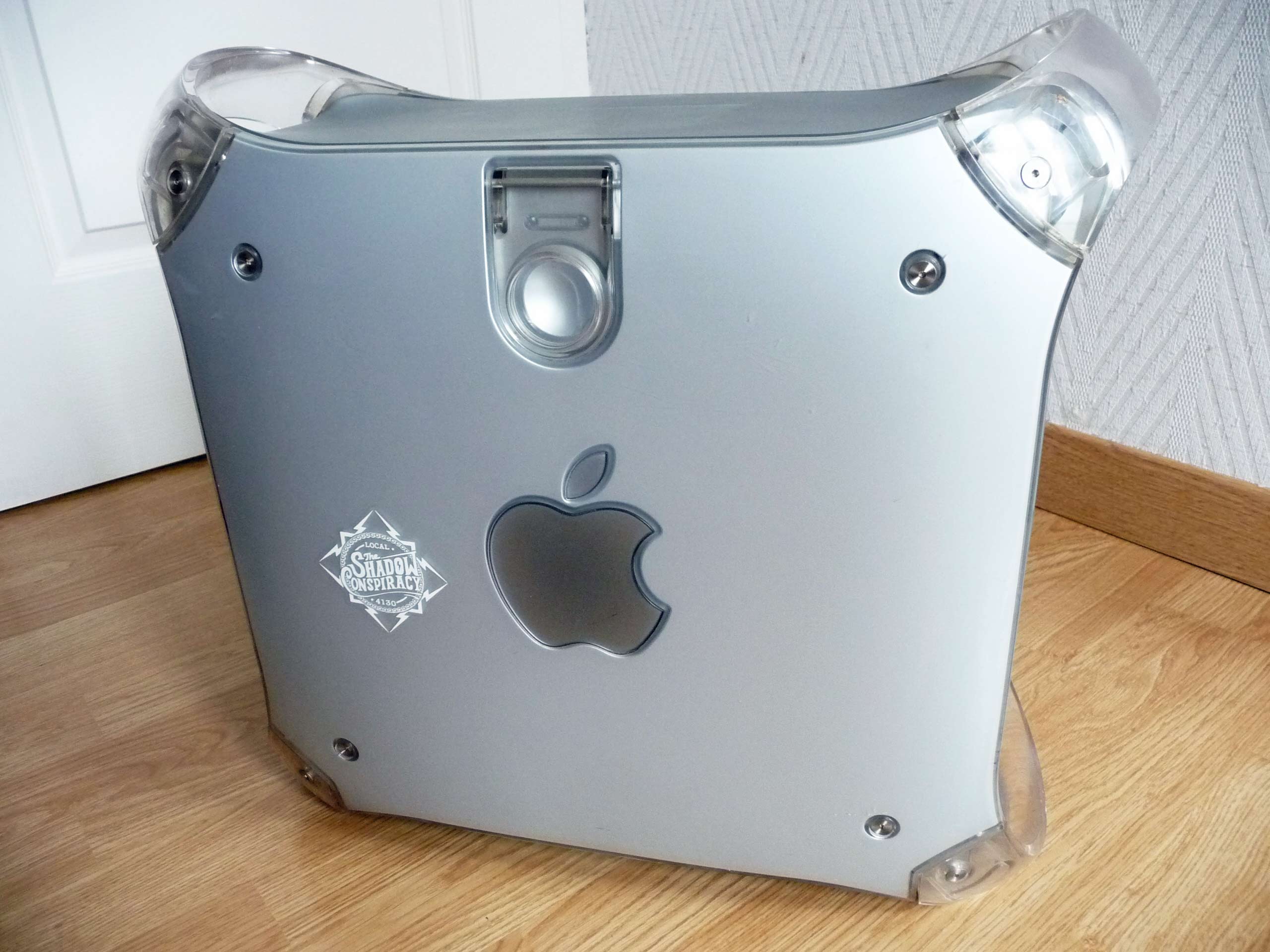

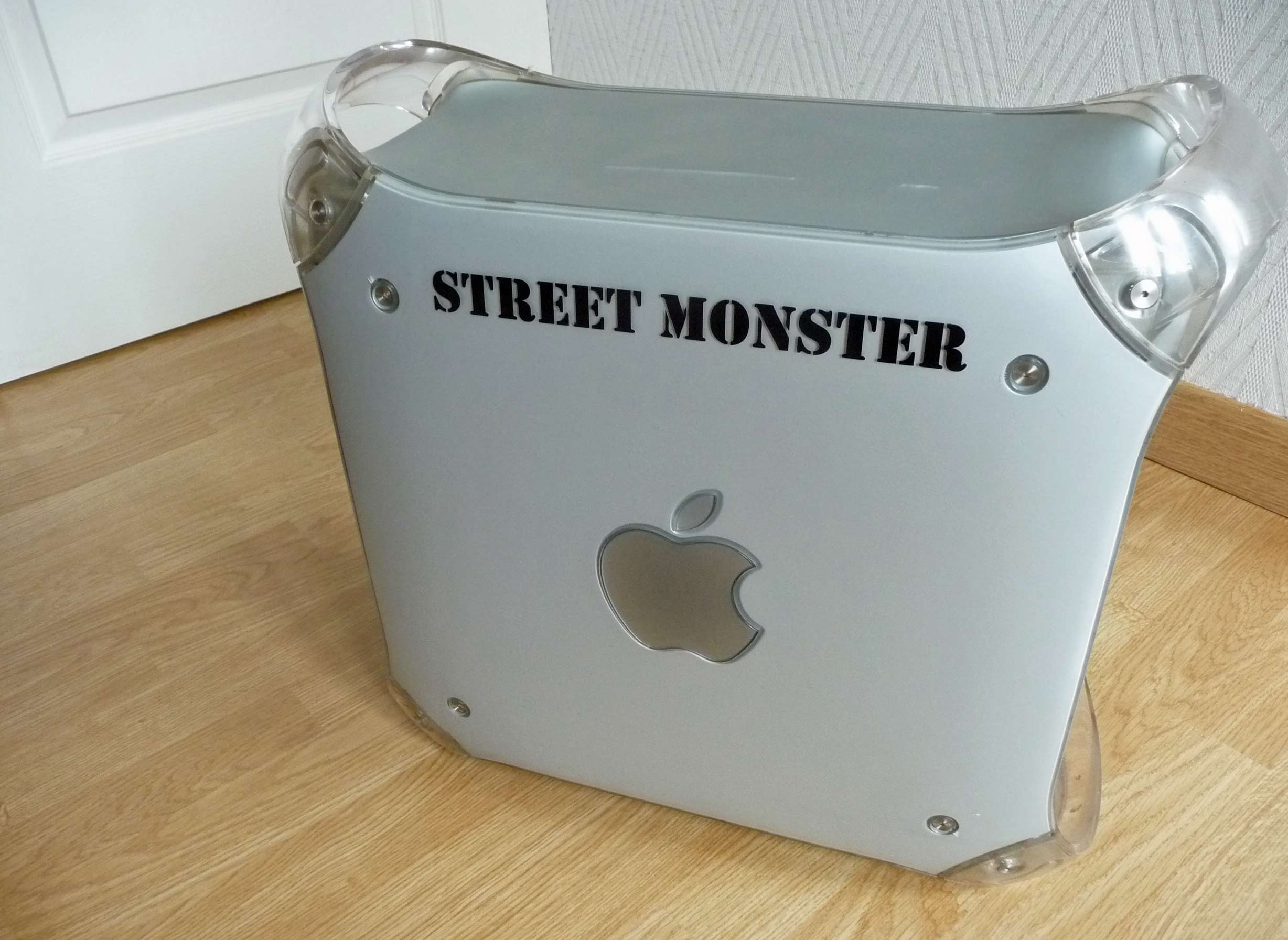

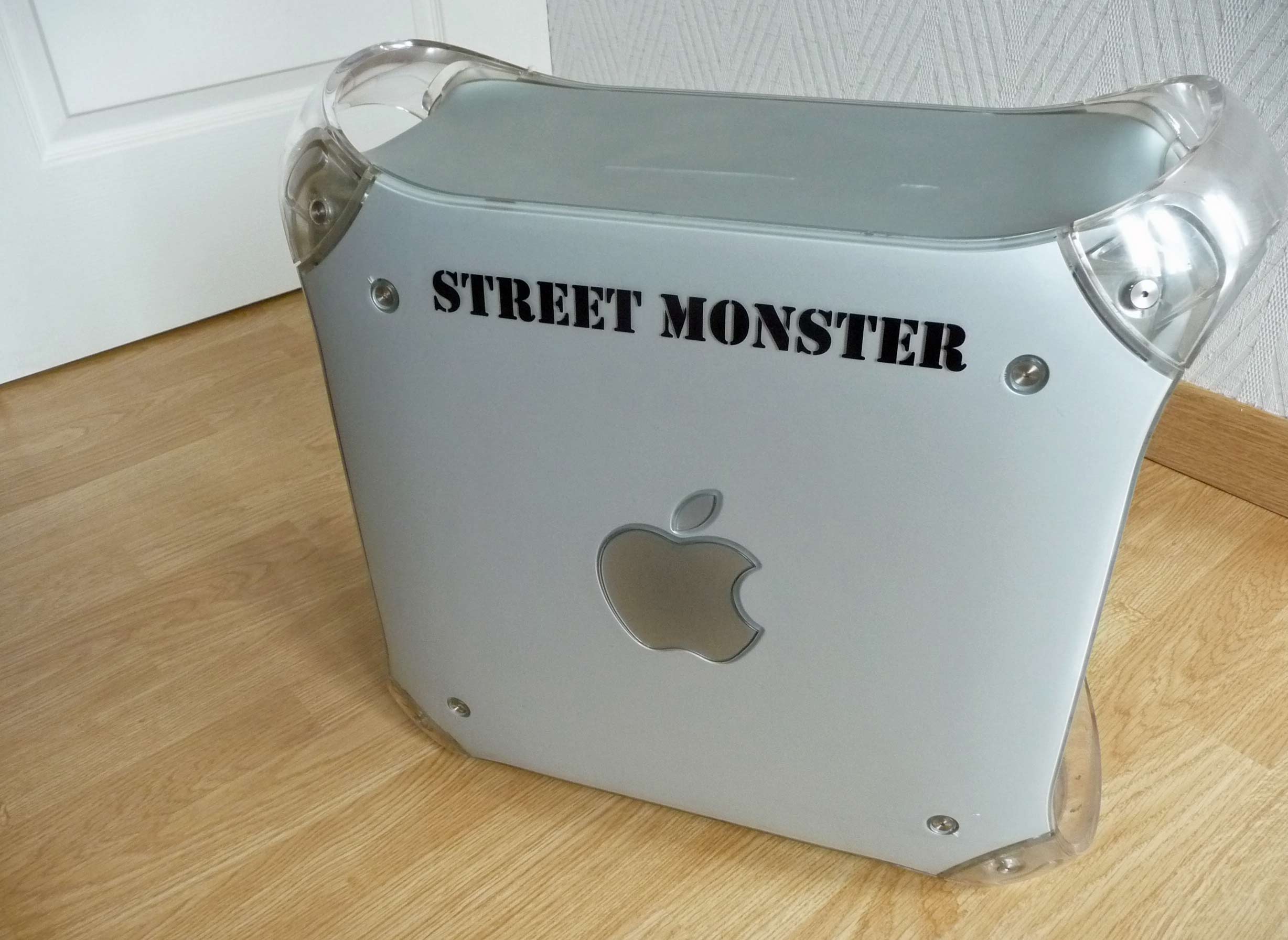

A monster loose in the bedroom. (Note the deep scratch on the top cover).

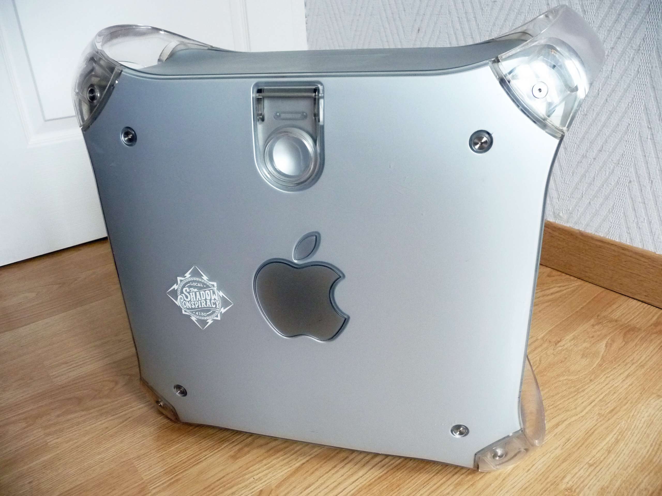

Shadow Conspiracy?

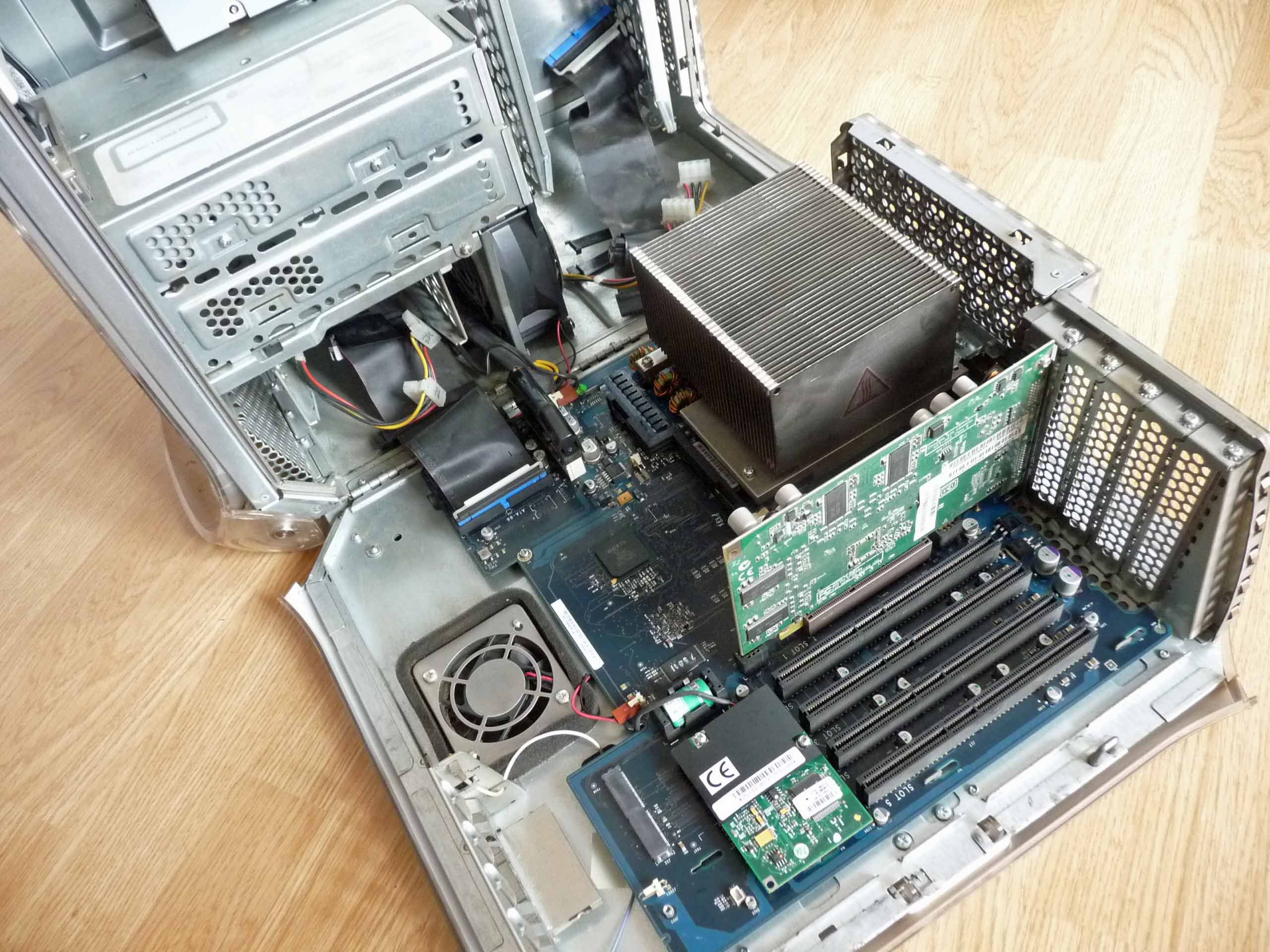

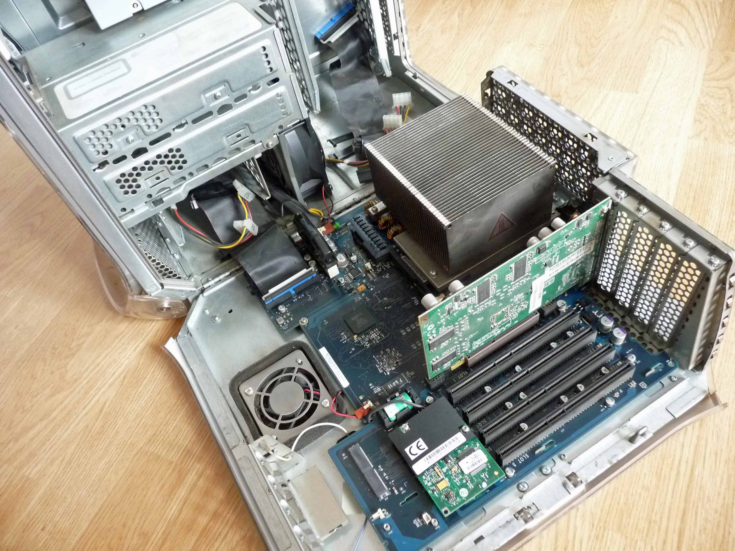

A peep inside - after few parts removed to facilitate a quick cleanup.

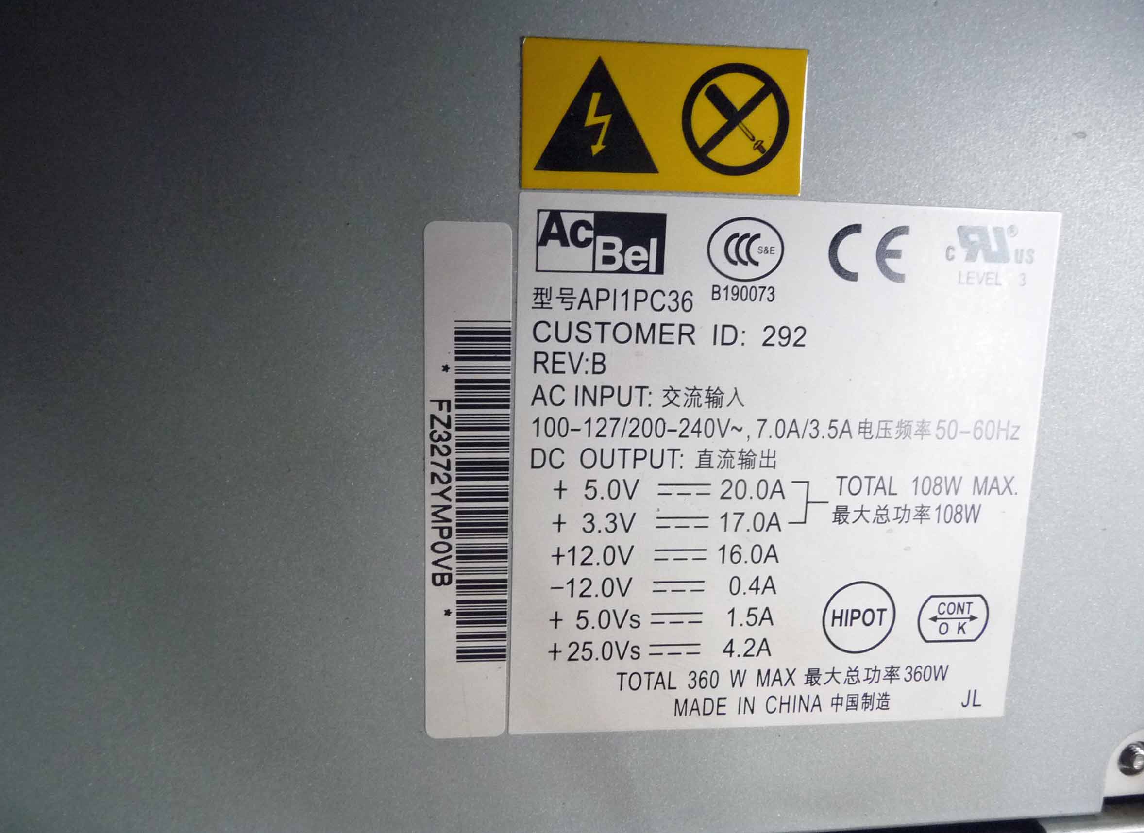

PSU details.
Rear view.

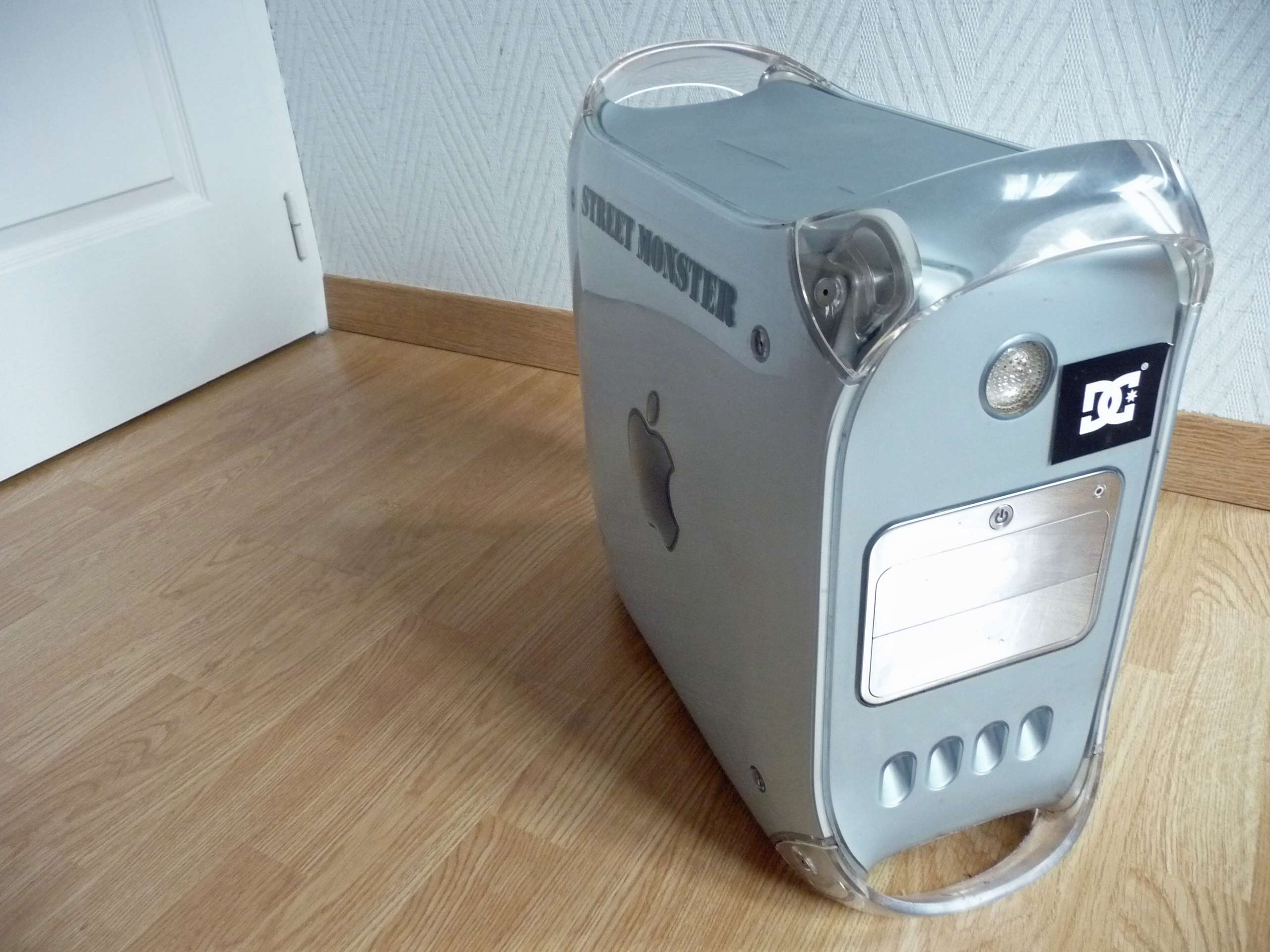

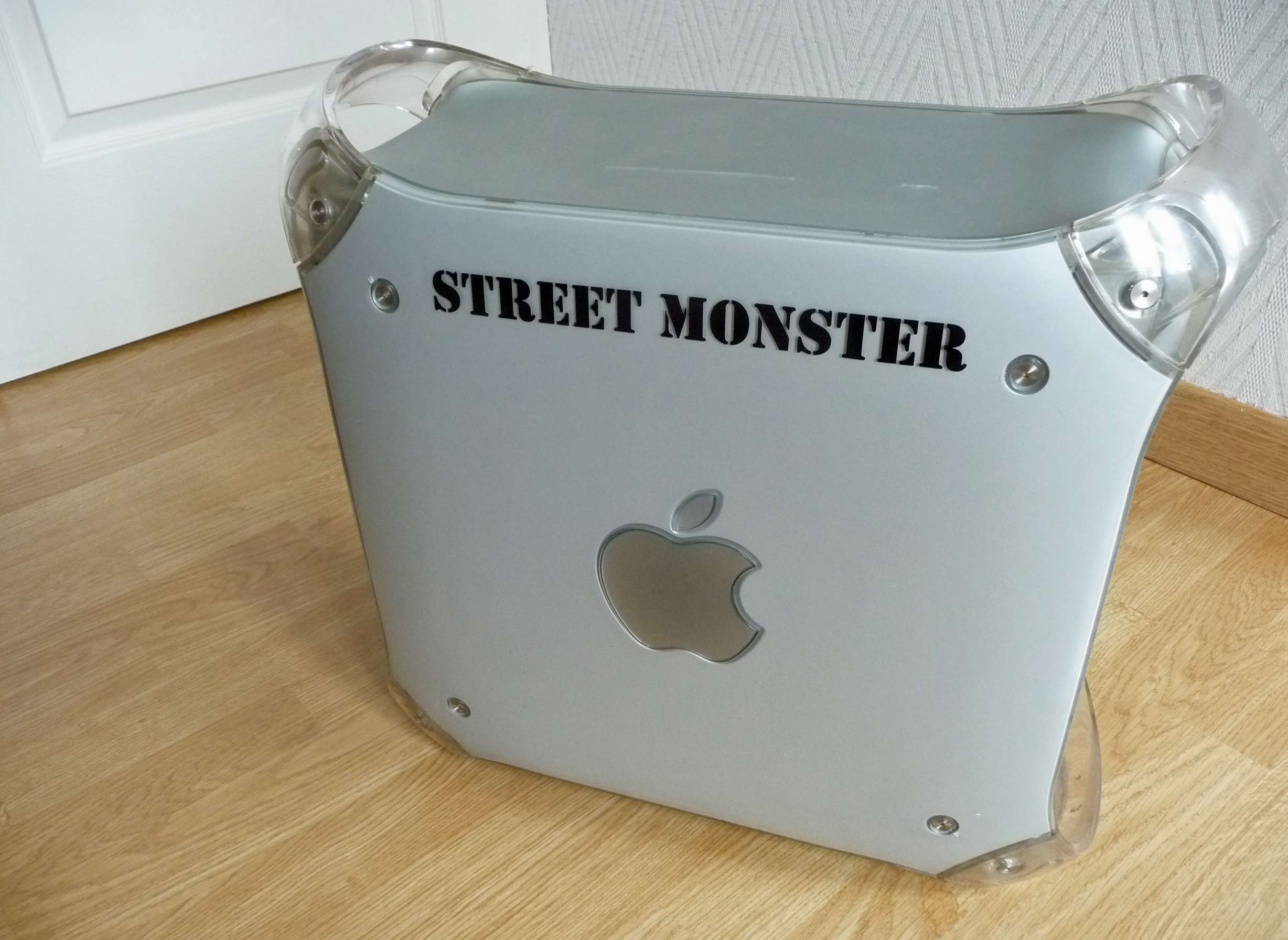

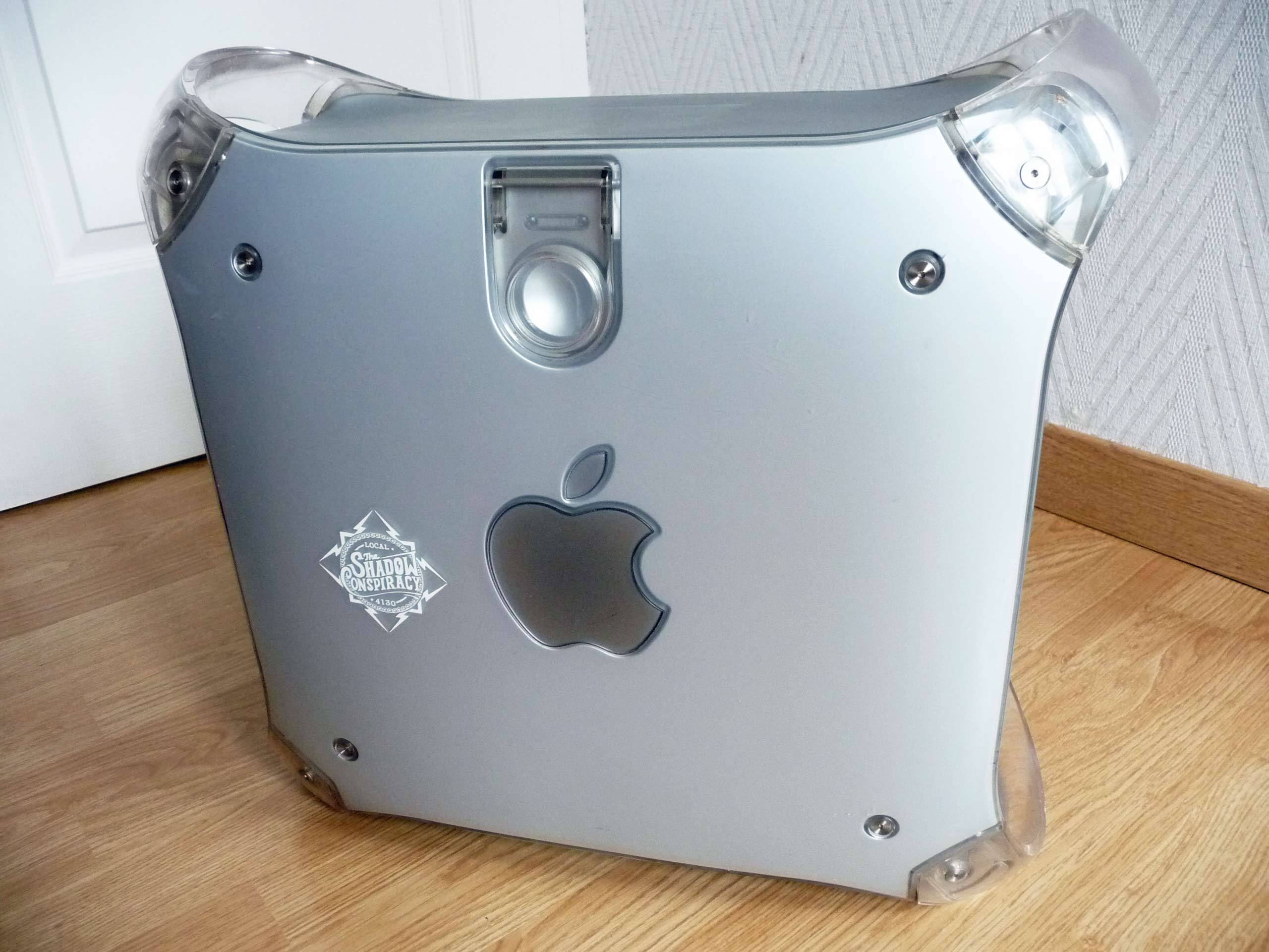

Shadow Conspiracy?
PSU details.

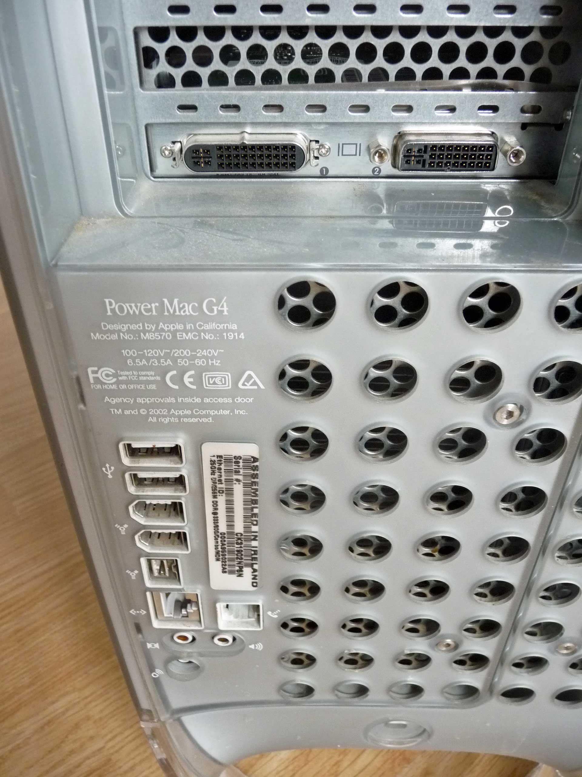

Rear view.
very nice find, looks like yours is also a FW800 Model, looks like it cleaned up quite nicely 🙂
in regard to the no power issue, luckily it looks like you got the more reliable ACBell PSU and the issues you describe do not sound like normal MDD PSU failure, I have certainly heard of MDD Power buttons going bad (the one on my first 1.42Ghz MDD is quite stiff for that matter) do you by any chance own an ADC monitor? if it is indeed a bad power button you should still be able to power the mac on using the power button on the ADC monitor 🙂 if you dont have an ADC monitor, you also might be able to open up the power button assembly and manually bridge the switch contacts with something like a screw driver. BTW for the record if you ever want to Boot OS 9 on this Mac, Do Not downgrade the boot rom to do so, there are better ways to boot OS 9 on these macs these days 🙂

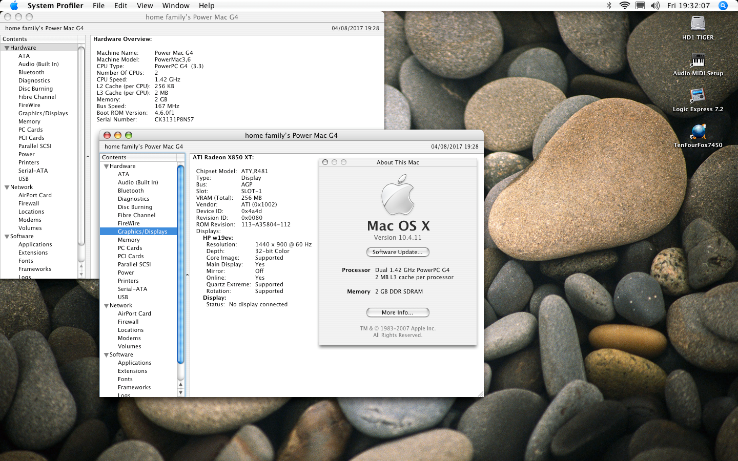

alright time for an update 🙂
last night I stripped the scruffy MDD of its PSU GPU RAM and bluetooth card (that originally was from my iMac4,1) I plan to fit the GPU and the bluetooth card to the First MDD (the one with the stock working PSU) im going to from here on out name the stock working PSU MDD, MDD1, the one with the stock dead PSU is MDD2, and my scruffy MDD, MDD3
so today I took the PSU from MDD3, and fitted it to MDD2, I have to say the Philips head screw inside the MDD that holds the PSU there, is the bane of my life, I can never get that screw in LOL, so for now i just have the allen screw in the back screwed in place and that holds the PSU in fine, i will try and get the philips screw in at some point tho, anyways screws aside i fitted the working PSU to MDD2 buttoned it all up and hooked it up to my test "bench" and it fired right up like the first one 🙂 , it booted into a more or less clean install of 10.5.8 (they did not even install drivers for the 9600 PC mac edition so rez was stuck at 640x480 on my monitor LOL) it has a 120GB HDD and 2GB of ram like MDD1, and indeed as the ATI drivers/control panel tell me it is indeed a Radeon 9600 PC mac edition card 🙂
attached here is a screen shot from MDD2, I installed the ATI drivers so i was not stuck at 640x480 but otherwise its as i found it, save for the working PSU i had to fit LOL (I will be doing a clean OS install at some point), interestingly despite no apps being installed, the last user did set some aliases on the Desktop and set the dock to hide as well as disabling the app launching bounce, (on MDD1 the dock was also set to hide but also set to show up on the right of the screen) I tried to see if i could find out when this thing was last used, if the last modified date on some of the stock apps are anything to go by, it was last used 18th of july 2017 so it seems like the PSU died recently... MDD1 seemed to of last been used july 2016...

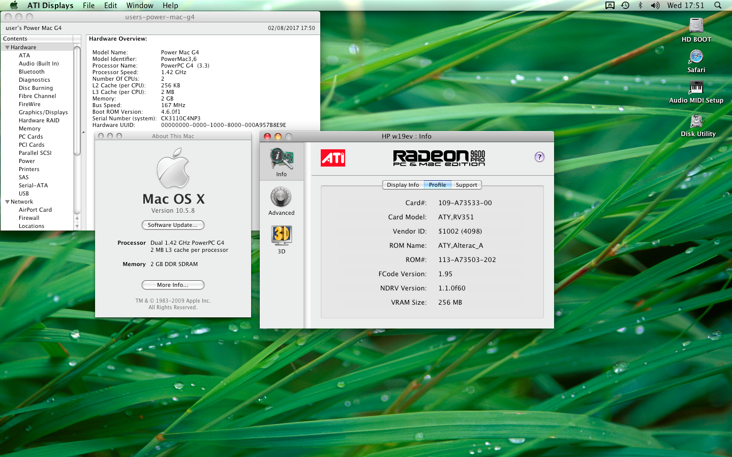

In regard to the no power issue, luckily it looks like you got the more reliable ACBell PSU and the issues you describe do not sound like normal MDD PSU failure, I have certainly heard of MDD Power buttons going bad (the one on my first 1.42Ghz MDD is quite stiff for that matter) do you by any chance own an ADC monitor? if it is indeed a bad power button you should still be able to power the mac on using the power button on the ADC monitor 🙂 if you dont have an ADC monitor, you also might be able to open up the power button assembly and manually bridge the switch contacts with something like a screw driver.
Excellent suggestion regarding using an ADC monitor! I did just that after reinstalling the HD's and a new **PRAM battery. Pressed the screen and...."we have POWER!" A quick single beep however had me guessing for a few seconds, then realised I hadn't reinstalled the 3 memory sticks. Duh!🙄
Once the RAM sticks were installed, second attempt - bingo! System booted sucessfully to Leopard. Found MSOffice 2008 installed - which I've never used in the past (MSOffice 4 on most of my systems - which many seem to prefer).
** I didn't have a spare PRAM battery handy, but walked down to the local pet shop to get one!😵 I'd noticed that they sold those electronic dog collar thingy's, and also a stock of compatible 3.6v batteries. It's not the usual SAFT make, but have had a 'doggy' one installed in the G4 Cube for the last few years, and still ok.
I was surprised to see that this MDD is the DP 1.25GHz model, and it appears very 'snappy' (well it should be with a doggy battery in it)!🙄 I think I got a good deal on this computer for €5
The power switch is definitely defective. All I need now is to beg, borrow or steal a serviceable unit. Anyone with a spare to offer?

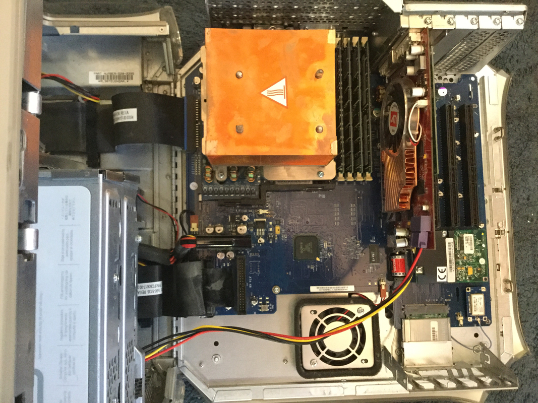

Update time again 🙂
this time today I have been working on MDD1 and souping it up quite a bit, so Far I have fitted an airport extreme card, a BT 2.0 card out of my old 2006 iMac and the best bit, my X850 XT EEPROM swapped and flashed FireGL X3, 🙂 of course here are some pictures
the install on MDD1 as i had found i, this one actually has some apps installed including tenforfox LOL
the FireGL X3 in the picture bellow is the same one from this thread https://forums.macrumors.com/thread...nd-flashing-x850-xt-rom-on-firegl-x3.2016538/ due to me flashing a full non reduced ROM as mentioned in the Post it has an NDRV in ROM and does not require me to install any ATI control panels or drivers (on top of that due to the X850 XT ROM being an OEM ROM from apple the ATI control panel does not include any NDRVs for it so you have to use to the full ROM) an X850 XT flashed FireGL X3s is also one of the fastest Graphics cards you can install into a PowerMac G4 MDD (and if your lucky a DA/QS) 🙂
you can also see the bluetooth card bottom right of the picture next to the airport card, interestingly on MDD2 (which has from what i can tell has an original factory installed bluetooth card) the BT card is green coloured and has the antenna connection on the other side of the card, its also a bluetooth 1 card unlike the card in the picture bellow which is Bluetooth 2.0 as it came from a 2006 iMac 🙂
all in all its coming together quite nicely 🙂 and im not done upgrading it just yet, im tossing around the idea of a SATA card and id like an SSD for it but I dont currently have any SSDs spare...
in regards to MDD2 im probably going to leave that one fairly stock hardware wise. my next post(s) will probably be loading up some fresh software on MDD1 and 2 (thing 1 and 2 😀 ) and do some benchmarks 🙂
