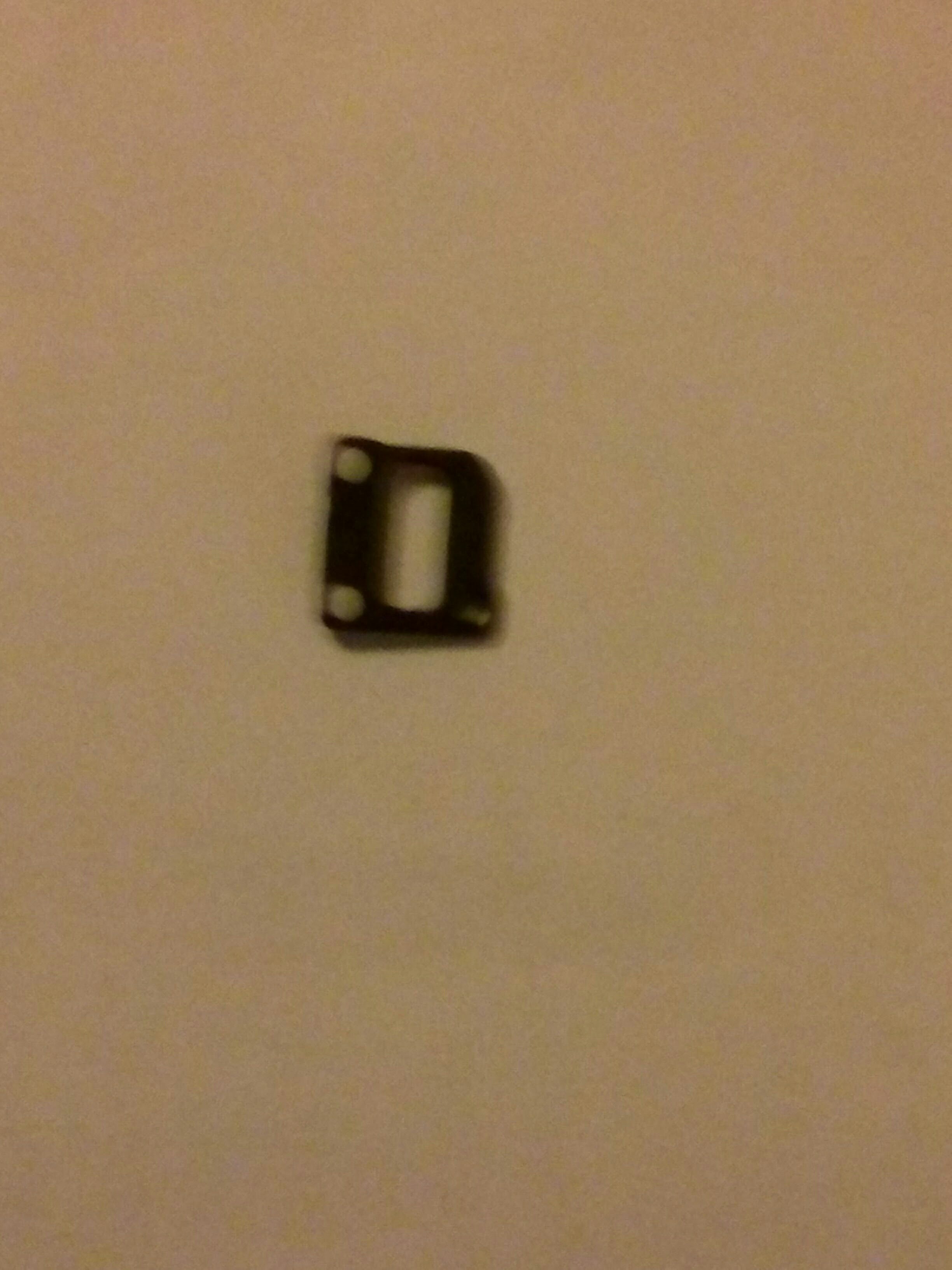

Possible clue here. I just remembered that when I had it open to install the SSD, I found a loose plastic piece on my work area that I didn't recognize. Maybe it came out while I had the PB open and facing down? I didn't think much of it at the time, but I managed to find the piece in question on my desk and here it is. Does this look familiar to anyone? And might it be part of the problem?
