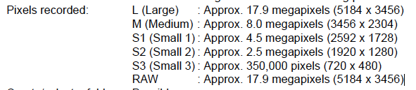

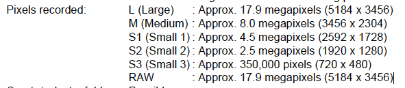

Looking at the cameras manual I see the options below:
it looks as the minimum setting that would display correctly would be S1. But in general it's always best to shoot raw.
Arrg, so im better off with setting S1 for ipad, and S2 for iphone, or ?
