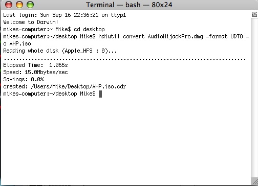

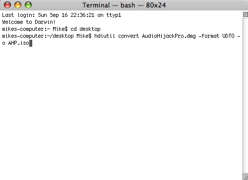

This is what it should look like: [bracket my emphasis]
Chris-Computer:~ Chris$ [cd desktop][then press enter and it brings you to below]
Chris-Computer:~/desktop Chris$ [hdiutil convert filename.dmg -format UDTO -o filename.iso][press enter and it'll look like picture 2]
I'm assuming that your User name is Chris, if not replace with your user name. Type in everything I did in the brackets into the terminal (minus brackets of course)
