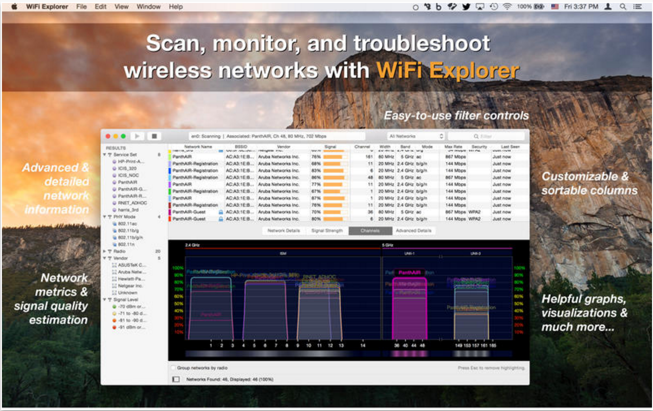

It's always tempting to blame service or providers, but maybe look at your network setup -- what band are you connecting to your router on? Maybe it's a congested channel -- have you looked at that? There are some great apps for measuring channel utilization for your location, I use WiFi Explorer myself -- though I don't understand much of what it does, it tells me which channel(s) are best and I've got nothing near the issues you describe 🙂

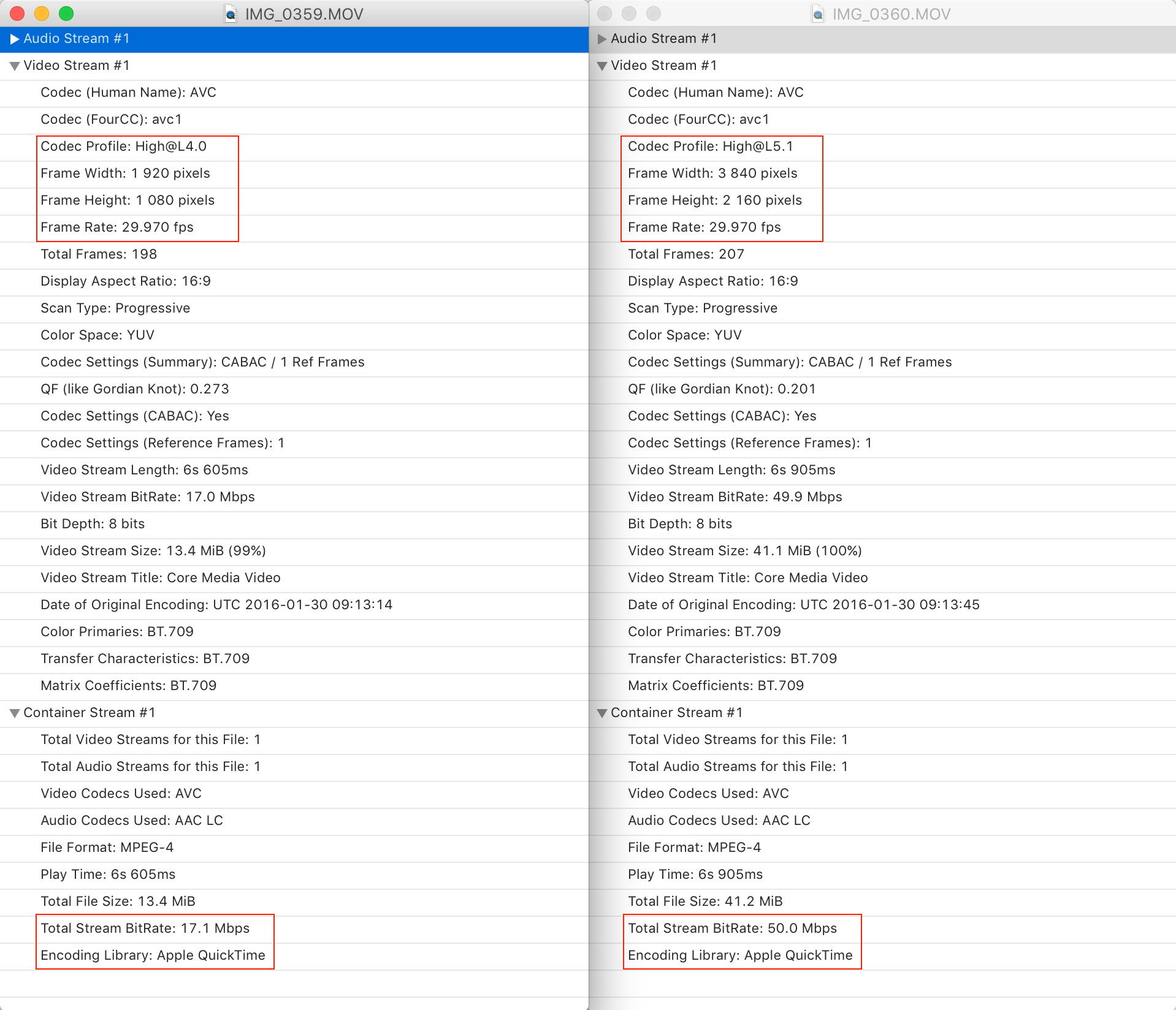

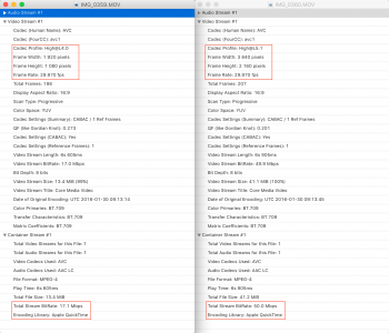

Because iPhone produces video, whose bitrate exceeds aTV playback capabilities, I would not be surprised at all, if Apple decided to recode it on the fly while airplaying. Here is example from one FullHD and one 4K clip:
