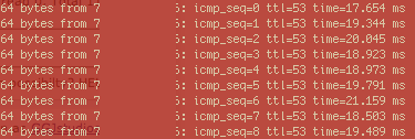

I think she's referring to the multiple pings to the same IP, showing the times:
i know that 🙂 thats why i asked for the IP addresses of a site that she is unable to get to. then we can give it a go and see where the issue lies.
