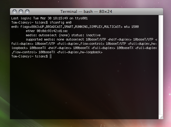

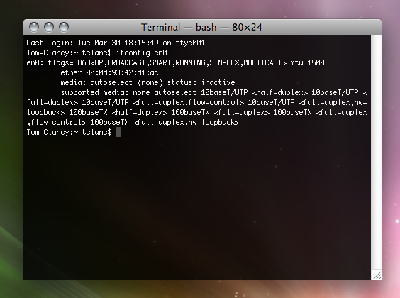

If you want to do their method, the inet address is found like this
Before you start configuring, open up Terminal (in Applications -> Utilities) and type "ifconfig en0" (zero, not a capital-o). You're looking for the bit that says "inet xxx.xxx.xxx.xxx". In my case, the number I get here is 192.168.2.1 Second, note down the IP address of your wireless router, which in my case is 192.168.0.1
If you want to try it without a static IP address, simply make sure that Internet Sharing is on in system prefs.
In Terminal, edit /etc/bootpd.plist as root. You can do this
Code:
sudo vi /etc/bootpd.plist
Go down and look for reply_threshold_seconds.
Change its value to 0, then write and close the file by entering this:
Code:
:wq
Reboot. Once back up, attach ethernet and it should work. If not, try the joystiq method.
