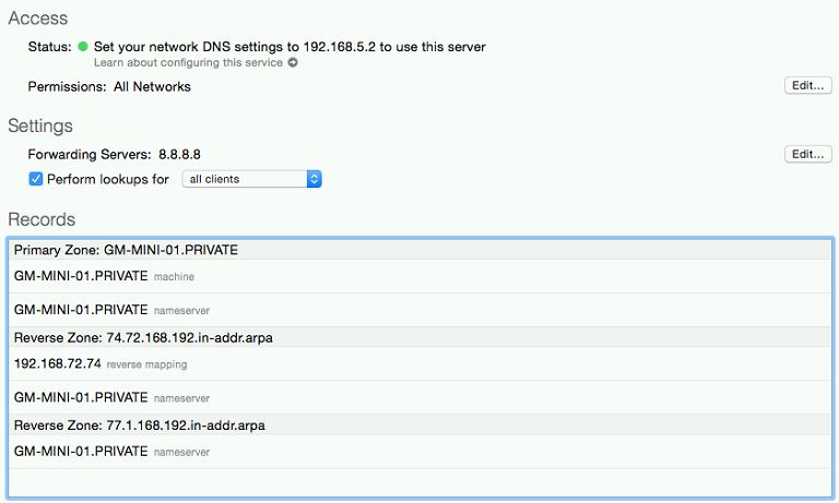

Hi guys,
I'm not sure if I have a DNS issue or misconfiguration but a new install of Yosemite server doesn't seem to be able to resolve itself. I've attached a screenshot if someone can please advise if it's set correctly.
There is a reverse zone which I think is incorrect because it was originally setup on 192.168.1.77 but the new IP is 192.168.5.2
Some clients have issues of being disconnected and I'm not sure if this is causing a problem. I'd be grateful if someone could advise

Looks to me like you have two incorrect reverse lookup zones that would resolve GM-MINI-01.private to 192.168.72.74 and 192.168.1.77 respectively. You'll want to wipe out both of those and create a new one for the updated internal IP address.

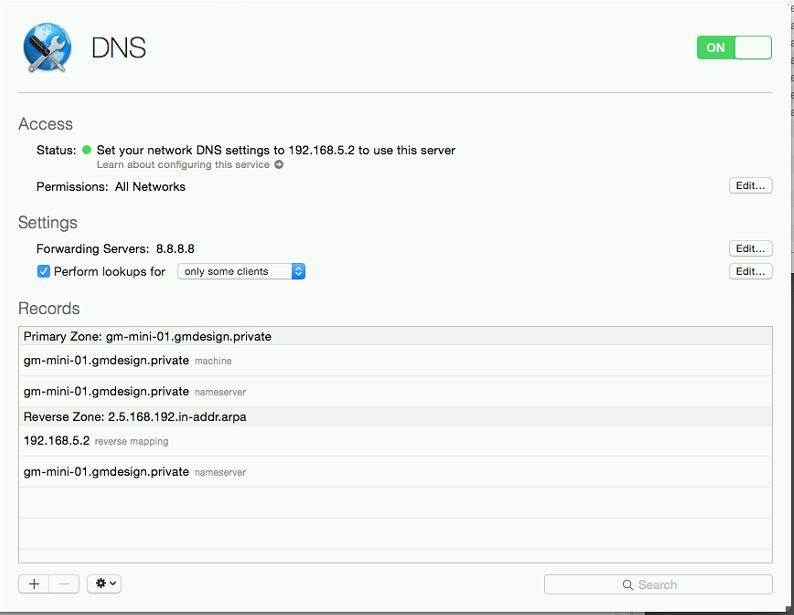

Sorry just an update to this I think I have resolved the DNS issues but in the process killed Open Directory. This morning users weren't able to access data with the Local Network User account so I had to create them Local User accounts.
I'm hoping to rebuild with this fix tonight and hopefully OD will be ok. Although they do seem to be working well today and not sure if I really need the OD
1. So, downloaded WorkGroup Admin and installed (Thankfully it still works in 10.10)
2. From Workgroup Admin I exported the users and then the groups.
3. Open Server.app and I turned off OpenDirectory, then quit Server.app
4. Open terminal and destroy the directory
sudo slapconfig -destroyldapserver
5. Open Server app and set up a NEW OpenDirectory server
6. Add a test user and try changing the password to verify it is all working
7. If it works then blow away that user
8. Select Manage import Accounts from File and import your users and verify they all come in
9. Do the same but this time select your groups file
10. unfortunately this does NOT preserve passwords so you can either set a temp password and have users change it at login or if you know them you can re-enter them
Ok the above fix seems to have worked and Open Directory is now reporting correctly. I've removed the user accounts and re-entered them as Network accounts. Not sure what the benefit however is though between the local and network as network seemed to be working fine.
