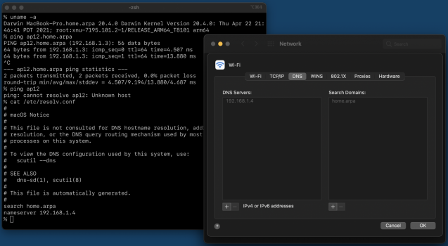

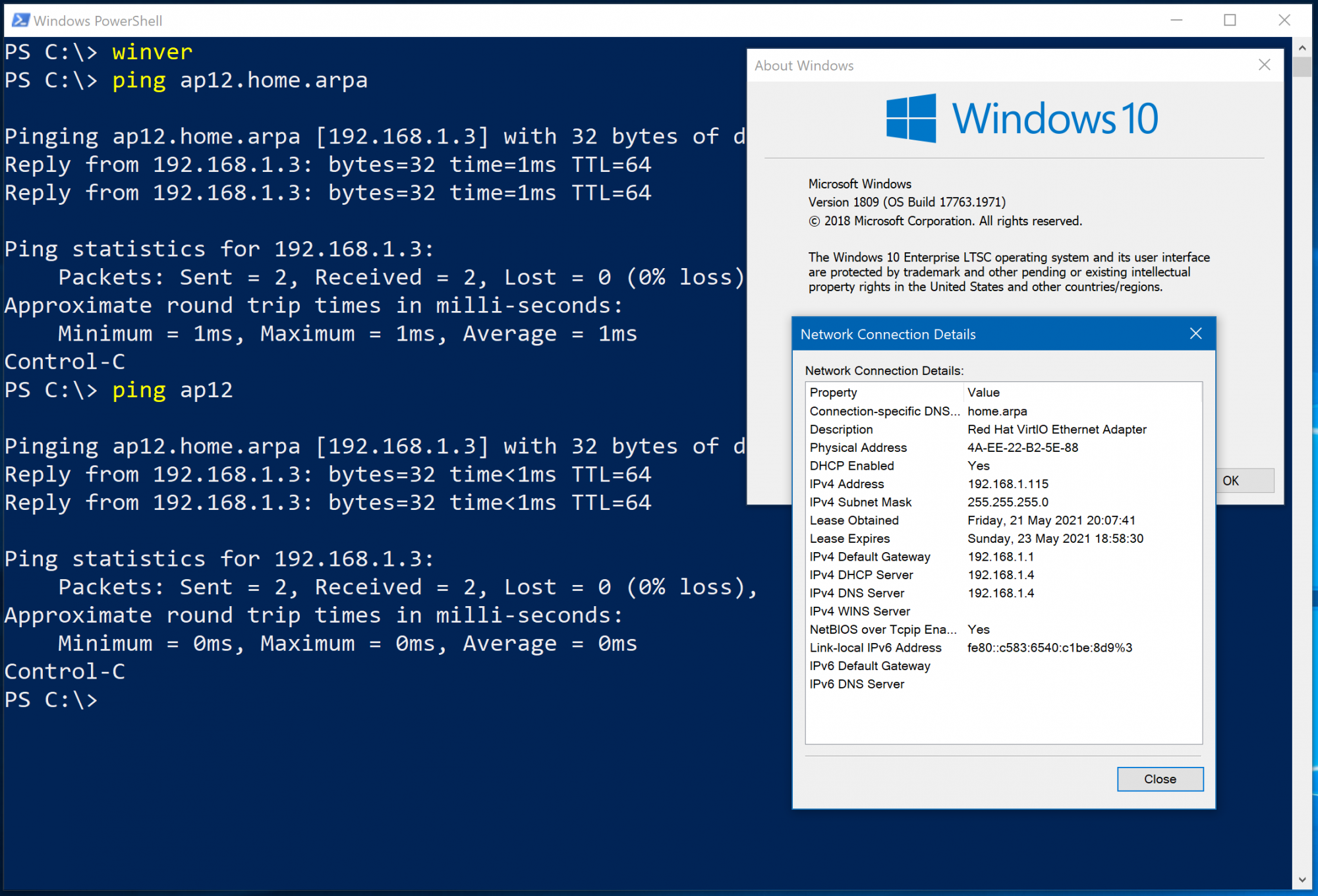

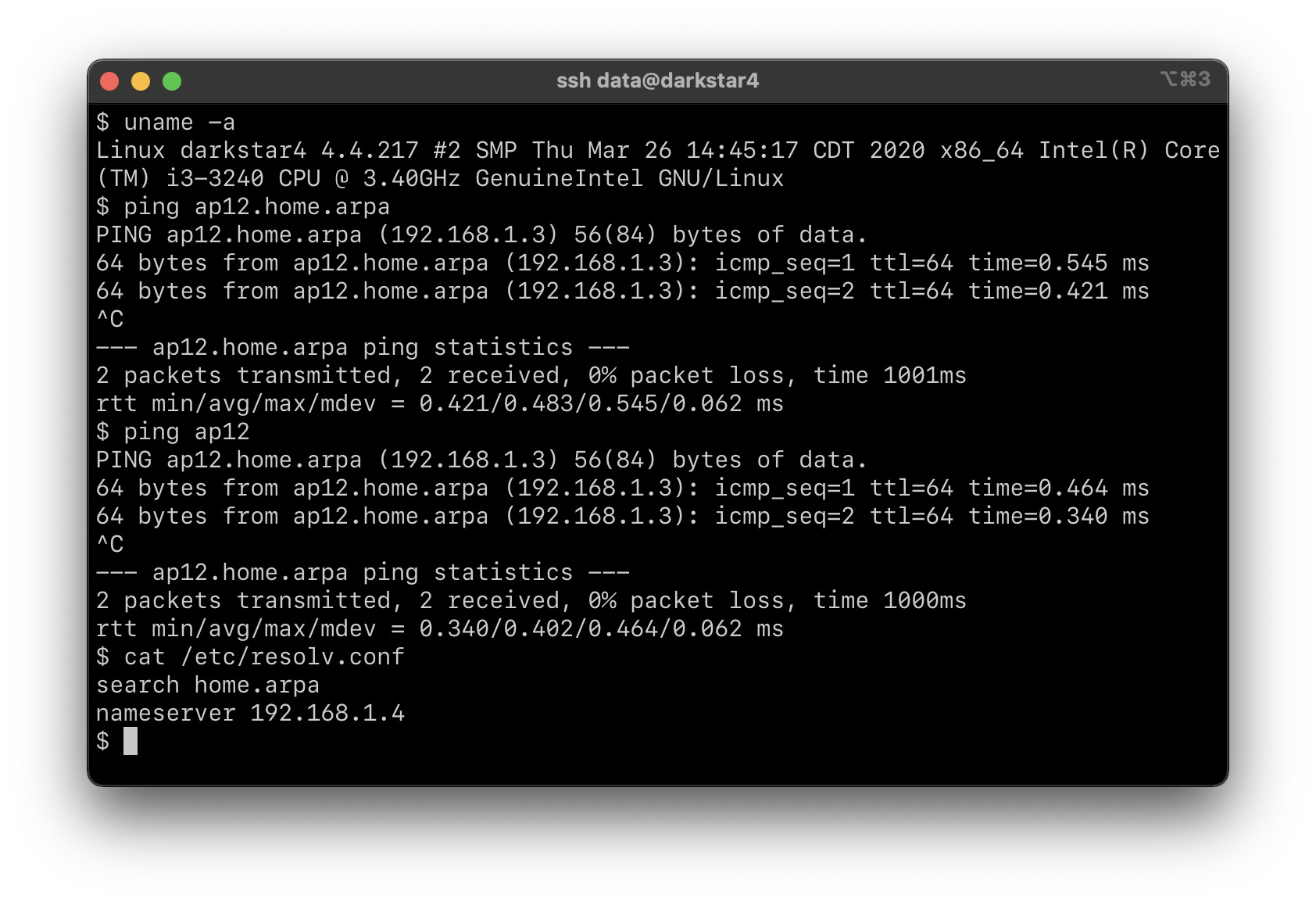

I'm facing an issue with DNS search domains not working and/or being ignored. I've been trying to troubleshooting/pinpoint the issue but unfortunately to no avail. I've googled fairly extensively and tried multiple options such as flushing the DNS cache, resetting my entire network setup, adding /etc/resolver/lan files etc, but nothing seems to work. I'm hoping one of you could point me in the right direction or speak out of experience on how she/he got this fixed. I am at a loss as the dhcp / dns configuration fully works out of the box on all of my other Linux/Windows machines, but my MBP is not liking the internal hostname resolution.
Problem statement: My MBP is getting an IP address assigned via DHCP, using a Pi-hole, with an unbound DNS resolver. I use an internal domain name "home.arpa" and that gets added as a DNS search domain, including the IP of my DNS server (192.168.1.4). Each device on my network has a hostname.

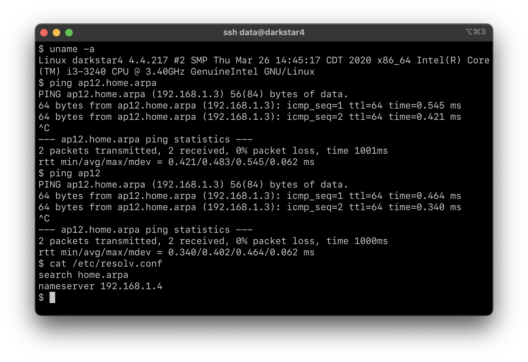

On my Linux and Windows machines i can perfectly ping the same device using both the FQDN (eg. ap12.home.arpa or kodi.home.arpa) and the hostname itself (eg. ap12 or kodi) as the search domain gets automatically added. However, on my MBP it simply does not work, as if the search domain is not even existing/being ignored. I can perfectly ping the FQDN but the hostname itself always fails. I have not provisioned my /private/etc/hosts file with these hostnames or FQDN as the DNS config should take care of that (and it does on my non-MacOS machines). I've tried even with fixed IP configuration (both static IP, DNS and DNS search domains) but no difference.
Apologies if this is not appreciated, but I've added some screenshots of both Windows, Linux and MacOS Big Sur with their config and ping results:
Windows 10:

Linux:
MacOS Big Sur:
From what my googling has revealed it seems the search domain is a problem that came up in the past for several users, but i didn't find any threads that made this a structural problem. It was most of the time linked to VPN's (split tunneling DNS) or missing/wrong search domains. It made me conclude that with a proper config, it was all considered to be working.

Running the following command on Linux works perfectly (kodi gets extended automatically with the search domain so becomes kodi.home.arpa:
$ ping kodi PING kodi.home.arpa (192.168.1.35) 56(84) bytes of data. 64 bytes from kodi.home.arpa (192.168.1.35): icmp_seq=1 ttl=64 time=0.733 ms 64 bytes from kodi.home.arpa (192.168.1.35): icmp_seq=2 ttl=64 time=0.718 ms
This results in the following logs on pihole:
May 23 13:34:14 dnsmasq[10080]: query[A] kodi.home.arpa from 192.168.1.11 May 23 13:34:14 dnsmasq[10080]: /etc/pihole/custom.list kodi.home.arpa is 192.168.1.35 May 23 13:34:14 dnsmasq[10080]: query[PTR] 35.1.168.192.in-addr.arpa from 192.168.1.11 May 23 13:34:14 dnsmasq[10080]: /etc/pihole/custom.list 192.168.1.35 is kodi.home.arpa
However, doing the same from my MBP:
% ping kodi ping: cannot resolve kodi: Unknown host % ping kodi.home.arpa PING kodi.home.arpa (192.168.1.35): 56 data bytes 64 bytes from 192.168.1.35: icmp_seq=0 ttl=64 time=4.889 ms 64 bytes from 192.168.1.35: icmp_seq=1 ttl=64 time=5.530 ms
May 23 13:35:26 dnsmasq[10080]: query[A] kodi from 192.168.1.78 May 23 13:35:26 dnsmasq[10080]: config kodi is NODATA-IPv4 May 23 13:35:30 dnsmasq[10080]: query[A] kodi.home.arpa from 192.168.1.78 May 23 13:35:30 dnsmasq[10080]: /etc/pihole/custom.list kodi.home.arpa is 192.168.1.35
This shows that on the MBP the first ping attempt fails because the search domain is not automatically added to become the FQDN (kodi.home.arpa) while the second request is correctly treated. Both requests do arrive at the pihole, but the search domain is not applied despite it being present in the IP configuration as provided by the DHCP.
Unless I'm missing something else, I'd dare to conclude that given both the Linux host and the MBP get their IP and DNS information identically from the same DHCP, that they contact the same DNS server (pihole) and that it works perfectly on my Linux host (not the pihole) but not on the MBP, the DNS Search Domain is not being applied to a host only ping command. I really have no idea what else i can change to make this work. :)
