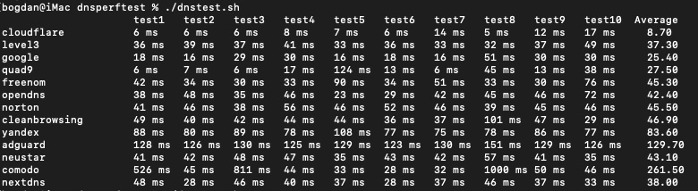

It seems to work for me
https://github.com/cleanbrowsing/dnsperftest
Easy to test
Code:
git clone --depth=1 https://github.com/cleanbrowsing/dnsperftest/
cd dnsperftest
./dnstest.sh

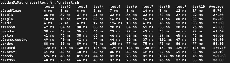

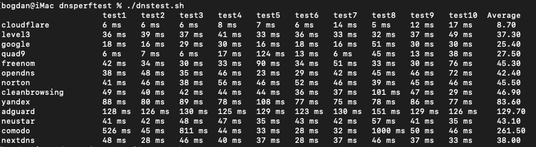

Easy to test
Code:
cd dnsperftest
./dnstest.sh
Ok, but again, the difference is minimal from my network. The tool is only testing one server per provider and has some syntax issues on Arch, so I'll stick with my tests.

Will +1 Quad9 as a backup (9.9.9.9). Used it as primary when it first came out, now is #2 in my DNS lists after Cloudflare. As @bogdanw screen shot shows, generally have seen pretty good performance (but that 124ms number really skews the numbers).
